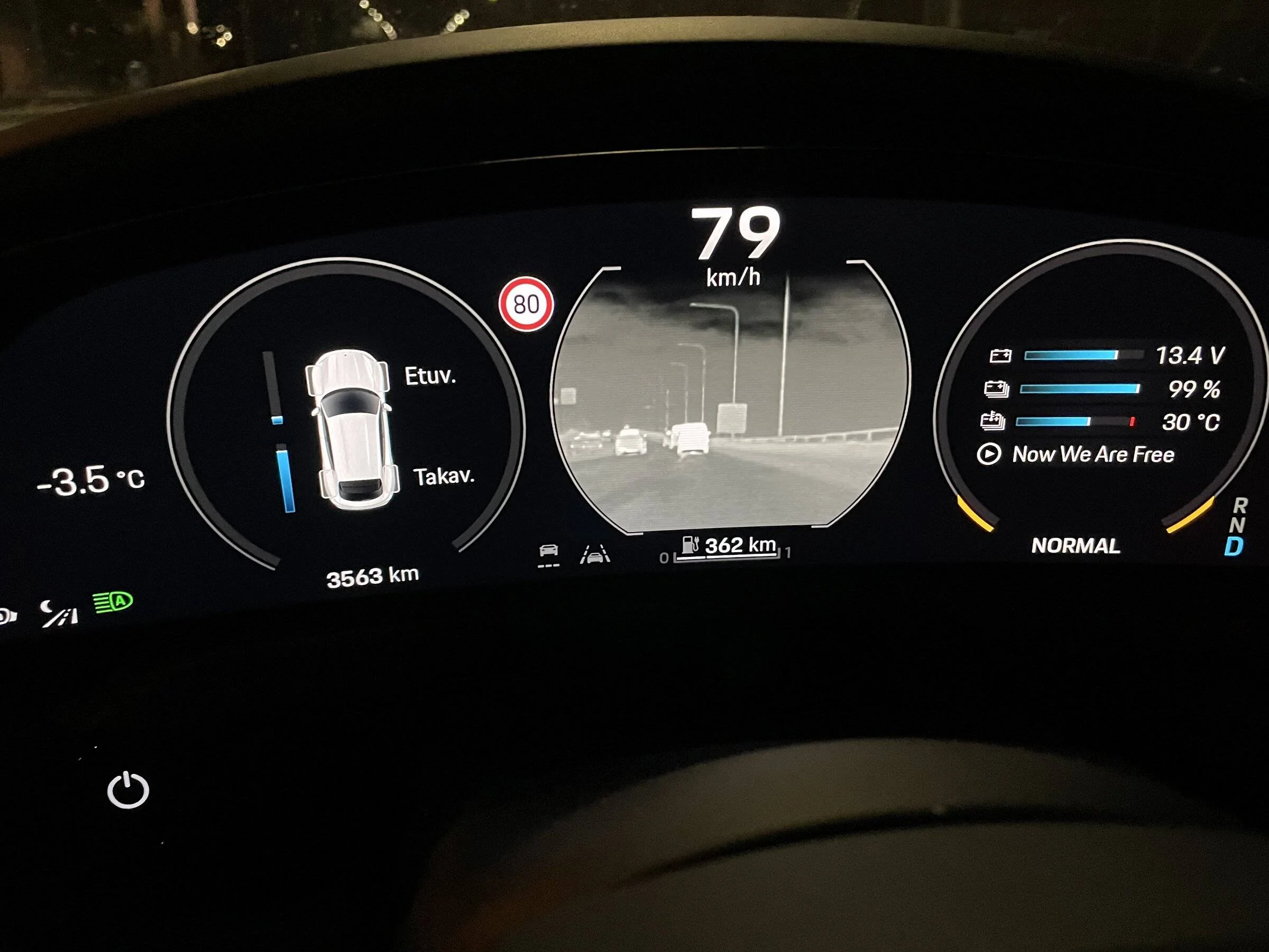

For me it does warm the battery consistently when using timer function, this is one morning right after leaving to work, charging with 11kW AC to 100%.
This is a CT4 with optional heat pump. Randomly charging it does not have the same effect I think, you have to use the timer.
Charging will naturally introduce heat. Forcing a charge level of 100% and setting a cabin temp with a departure timer will help to warm things up.
Most cars have the heat pump but it is optional in certain (hot) countries.
I've never seen this level of battery temp when home charging to 85% or 100% from a 7.4kW single phase source and a cabin temp of 23C (ambient 4C - 11C, garaged). Battery temp mid teens at best.

Heatpump is a 990Eur (+1K USD) option here. I didn't get it. But reading the specs on the configurator it doesn't explain how preheating the car would preheat the battery to 30°c with the pump. Not convinced here that this is indeed the differentiator.

Ageed with the above. So mistery still not solved...
Unless DrT's garage is a 30°c sauna ? ? it's still unclear how het gets this preheating in the battery. Very intriguing I must say.

The charging process is the reason and that he is pushing to 100% coupled with the departure timer which is drawing energy from the connected EVSE.
Perhaps it's a well heated garage to begin with and so the ambient if the battery is already high.
So in his situation we should see the heated battery as a side effect rather than intentional.
That's my take on it
If I had made the charging point a location or stopover in Nav and it was recognised as such and it was a few miles away then the car would manage the battery preheat itself and for this by software and possibly calling on the heat pump where fitted.
