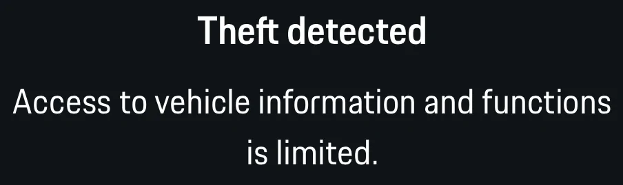

No, nothing after market. No dash cam. Also had the big update (that was supposed to be a remedy) last year.
I reported it to my OPC and they had 'no concerns about my battery'. They thought it was due to:
a) the car's low mileage
b) it being 'fairly normal to lose charge' over 2 weeks
c) keyless entry (which I don't have) discharging the battery
d) the need to use a trickle charger
I'm waiting for a further response from them as this isn't good enough. I'm not going to grovel around the fuse box with a spare battery to get the frunk open to reboot the 12v... Or hang about for Porsche Assist.
I believe it's software related. The HV battery should always ensure the 12v is charged (as long as there's more than say, 10% charge left) becuase it is so central to the operation of the car.

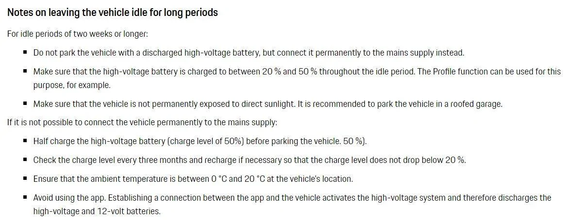

It is a right muddle with incomplete / conflicting advice in various Porsche documents.
My logic is that the HV masters the 12v and so when needed tops up the 12v automatically at a certain threshold. HV maintains this when left connected to an EVSE and so a trickle to the HV to keep say at 85% and should the 12v drop then the HV tops it off without the car being powered on by the owner.

It's worse than that. According to the audi manual, the first time the charging kicks in is when the 12V has 8Ah left (20% charge). Then it will charge it until it reaches 50% or 30 min whatever comes first (we have no specs on the charging circuit so it's possible it doesn't even charge to 20Ah). The remaining 7 cycles will kick in much sooner than the first if the draw remains the same.
So in theory, in a perfect scenario where we start with a full 12V battery and the car is always able to charge it back to 50%, we get:
32A + 7 X 12A = 116A
Meaning the car is allowed to draw 116A total from the 12V before it's dead.
I can see Porsche engineers thinking 116A is going to be enough but apparently it either isn't or there is something else triggering these 'offline' situations. I can't believe the car is drawing 116A in a week
Edit: actually it's quite feasible. A constant 700mAh current will drain 117A in exactly 7 days... At 500mah it won't even last 10 days.
