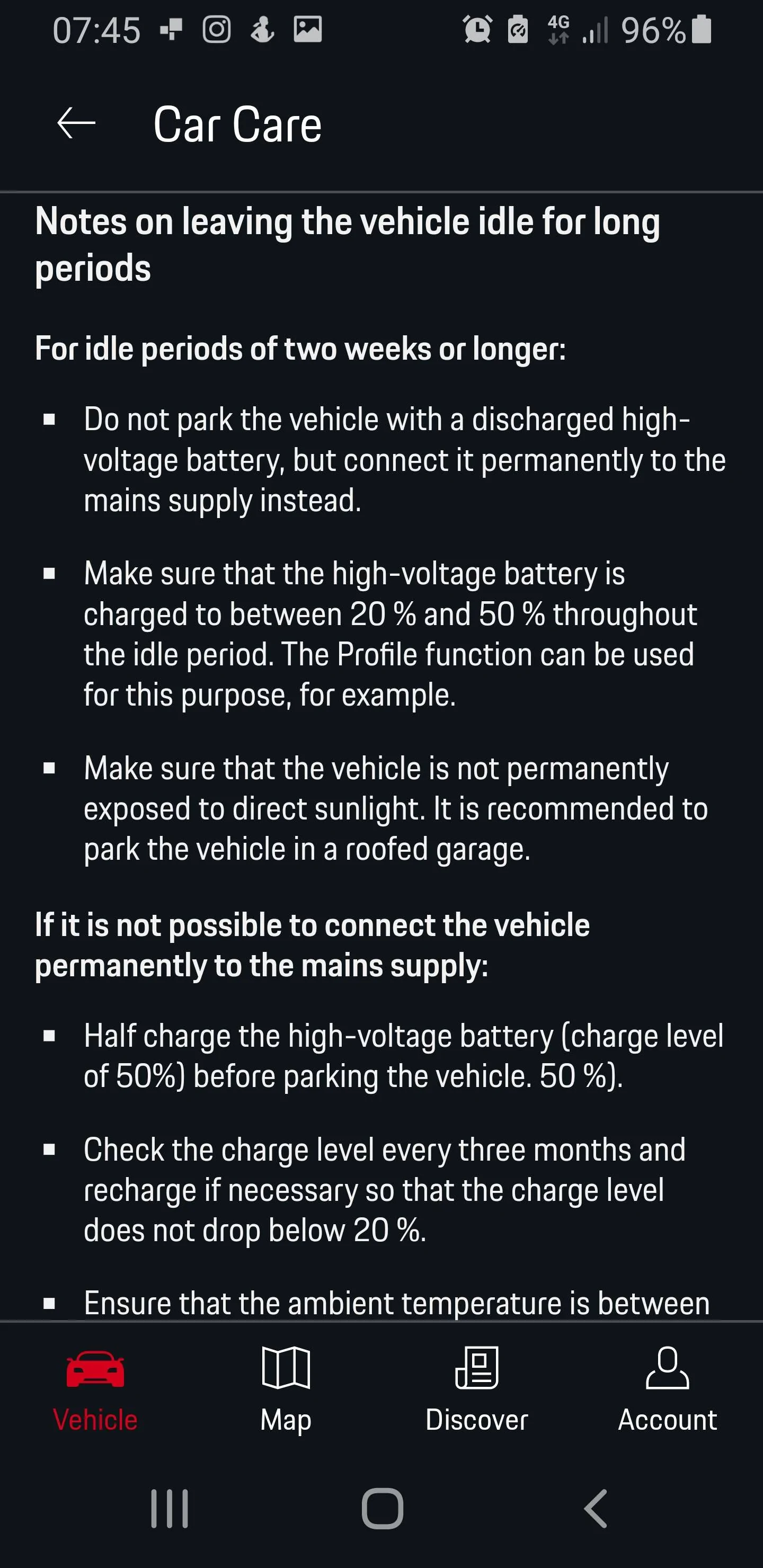

It is in the manual.

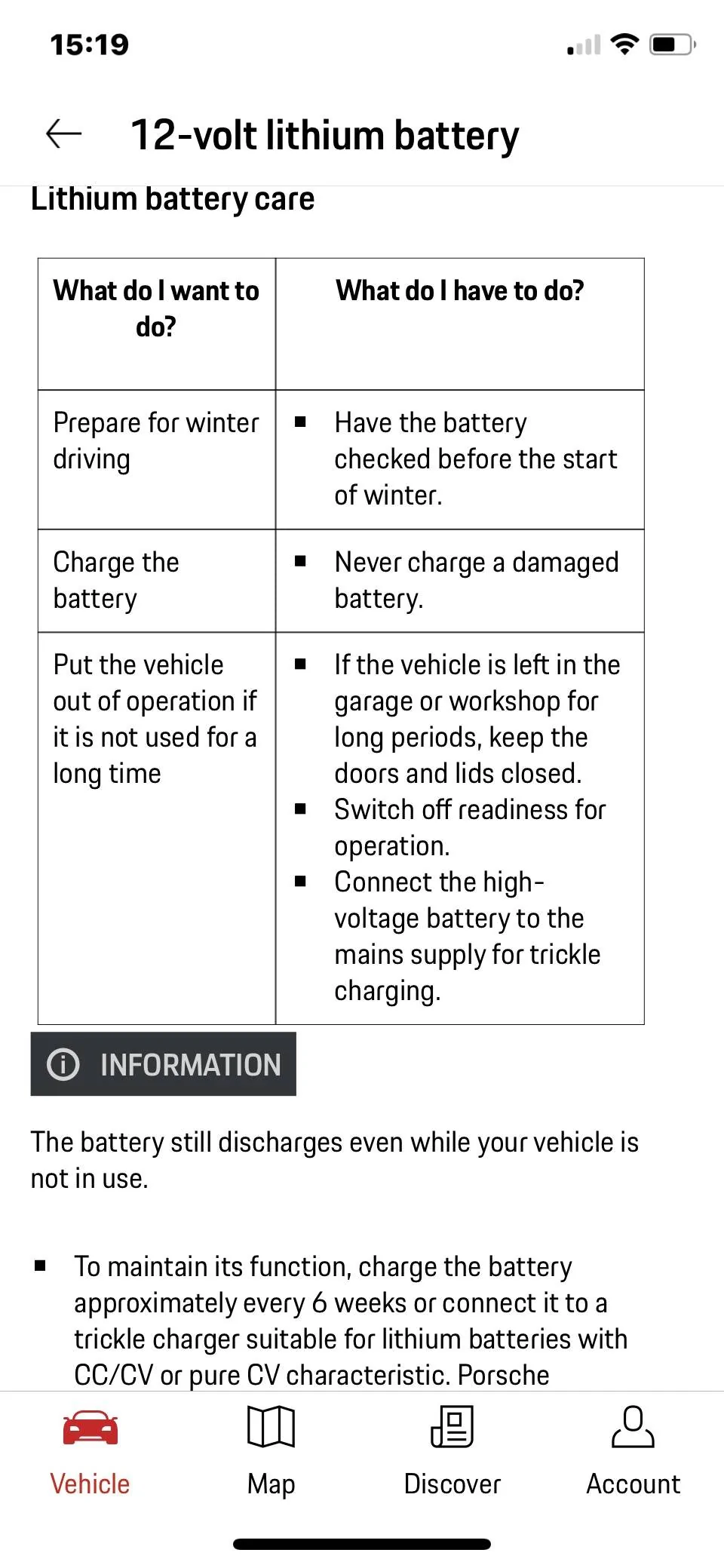

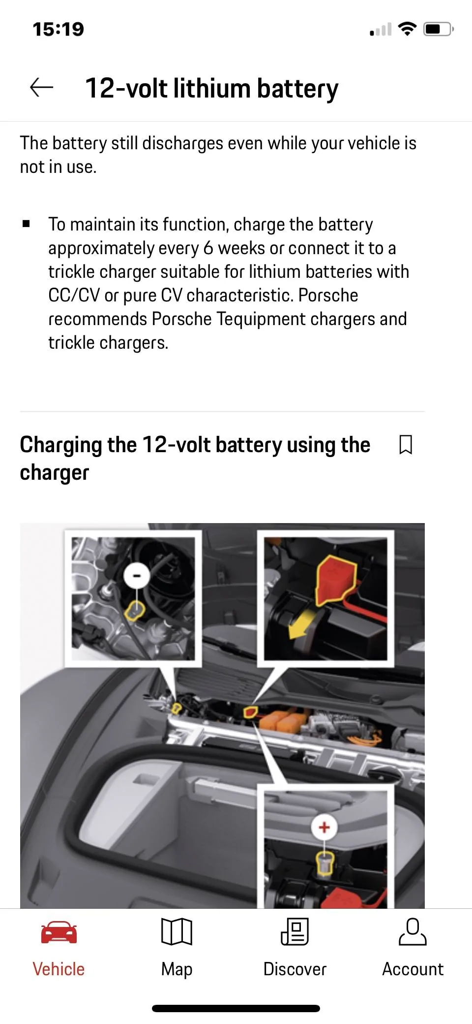

It is stated for the main HV battery I thought. It is under the 12 volt battery section, but it refers to the HV battery.
If you look at the document I attached and look further down on the manual, it again states that the 12 volt battery should be charged after 6 weeks.
Porsche Taycan Theft alarm = low 12v battery! 6236D01C-899E-4704-997E-6B9CF40D9944
The manual states the for the 12 volt battery!
Porsche Taycan Theft alarm = low 12v battery! 2C732530-AF96-41A6-B74A-48FE7B8A24CB
With that extra advice I still believe that you actually will have to proper start the car and drive it for some time, in order for the 12 volt battery to start a new sequence of cycles.
