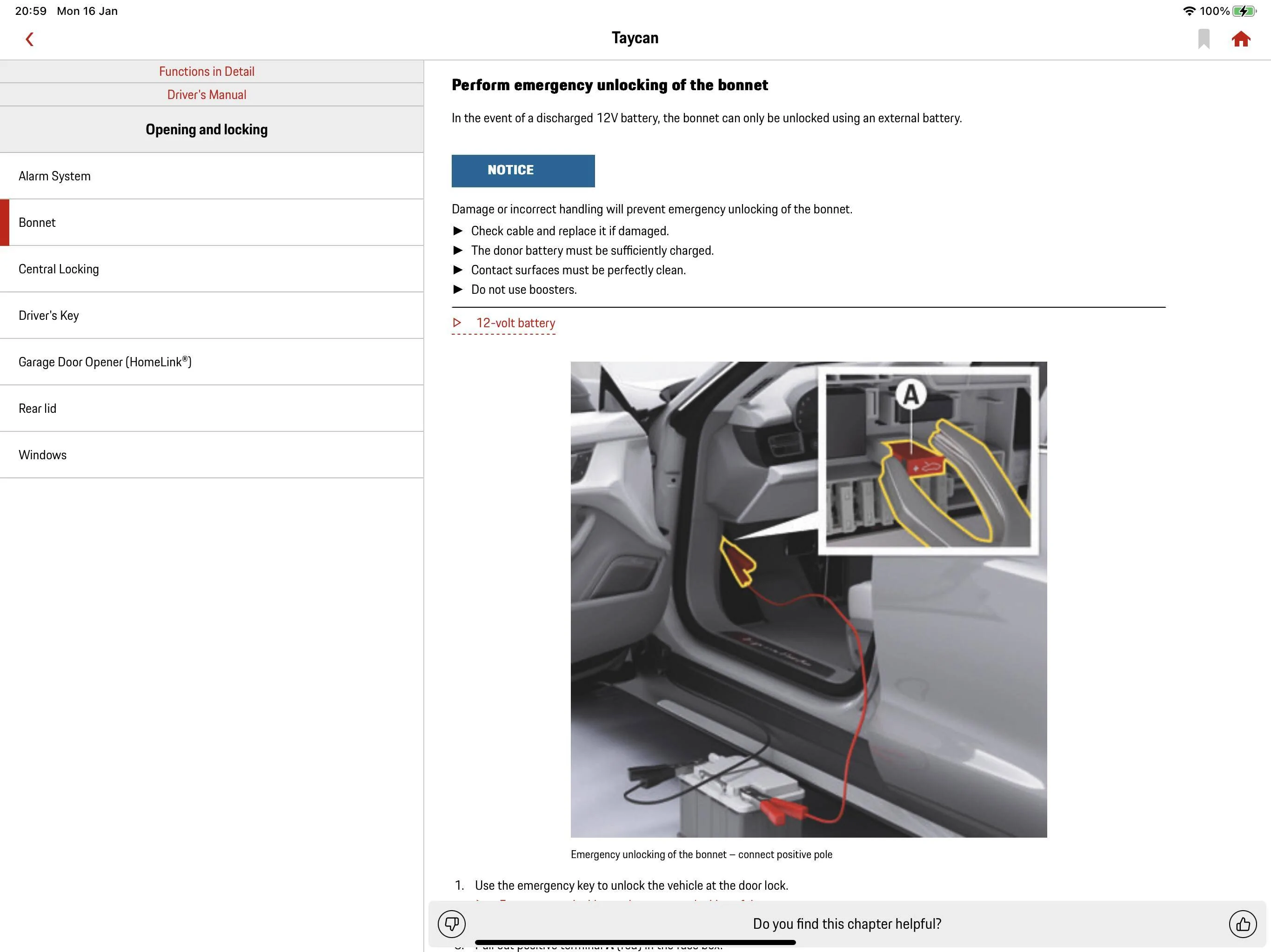

Have you downloaded the Good to Know app for the Taycan? There is a good description in there how to open the bonnet.
Porsche Taycan Theft alarm = low 12v battery! 37E190EE-F50D-4899-A694-DE3072B51A9B
The fuse box where this is done is at the drivers footwell ( at least on LHD car). Not so easy to get at in a fairly tight airport parking. And then you need to fasten the positive clip to the emergency opener and the negative to the door lock or hinges that are not painted.

And always connect positive first?
