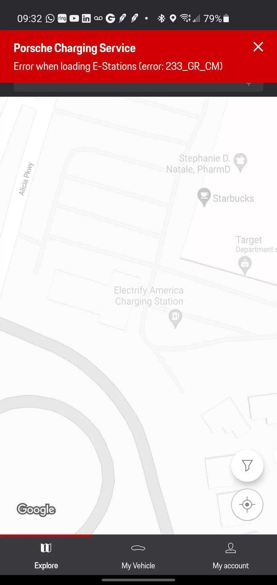

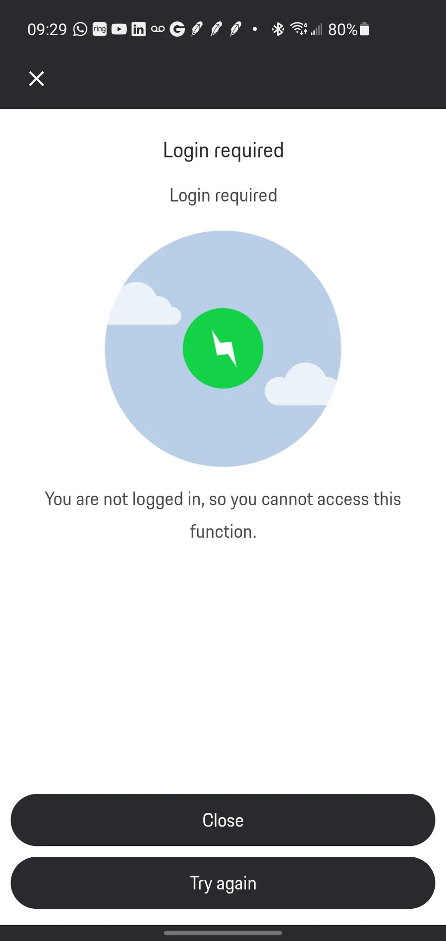

The Charging NA app simply won't let me log in - it's stuck in Demo mode, and after logging in just shows "Login required. You are not logged in, so you cannot access this function" - in its typical fashion.
The Porsche Connect app shows all EA stations grayed out, and shows the red banner at the top: "Error when loading E-Stations (error: 233_GR_CM)"

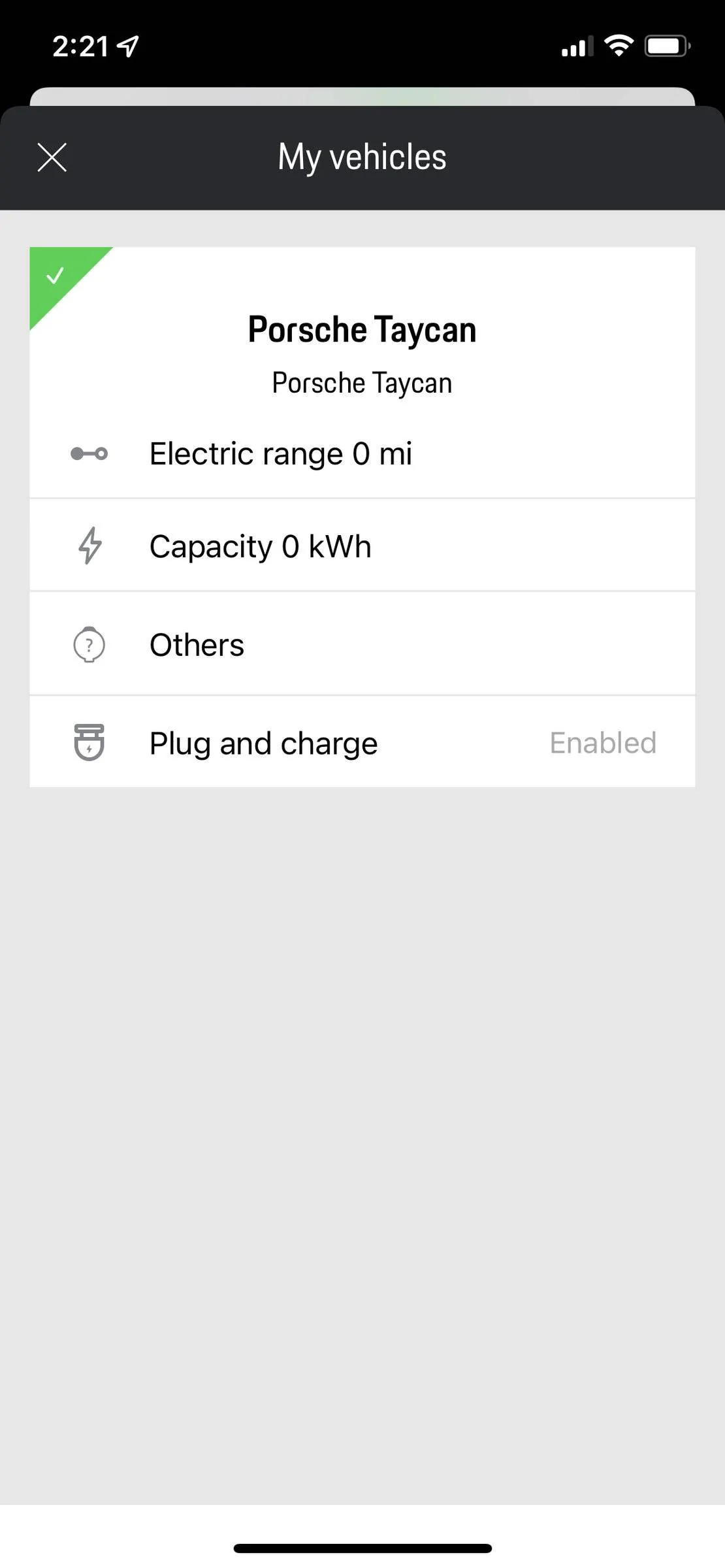

I can confirm that I also am able to login to my Charging NA app again, and I noticed there was a popup that said "Valid Contract" at the bottom.
As a potentially HUGE plus, for the first time ever, when I go to My Vehicles, I now see my vehicle listed!
Porsche Taycan Cannot charge at Electrify America right now?! WTF IMG_2D51862070AE-1
I used to always get some error about a backend server before, and I suspect this is the reason I could never get Plug & Charge to work. If my theory is correct, I should be able to Plug & Charge now. Will have to test the next time I visit an EA station...

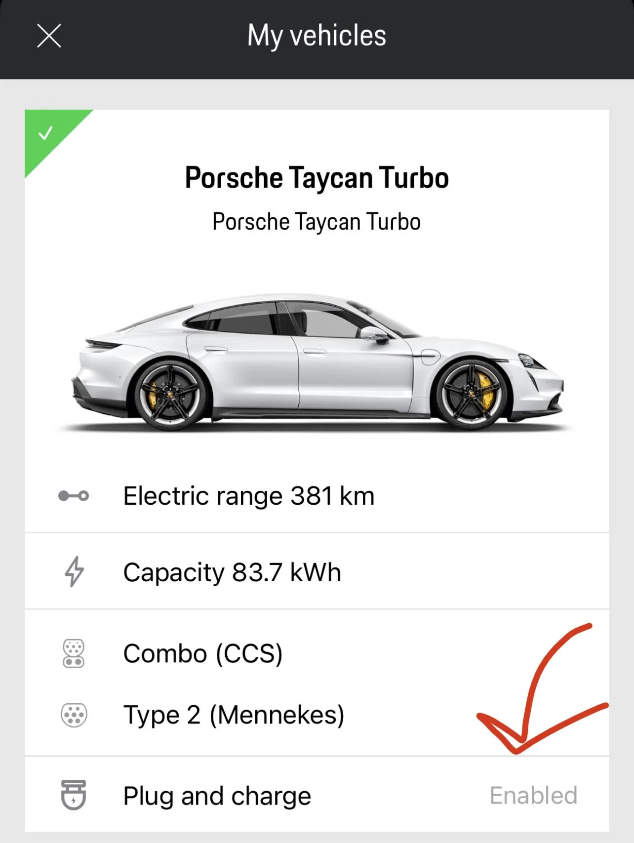

this is interesting. I have the same (Turbo my20) "P&C enabled". but it never worked on Ionity or any other network for what is worth, i.e. I have to use the RFID or the app. Is there anyone else in Europe able to P&C? at what network?
