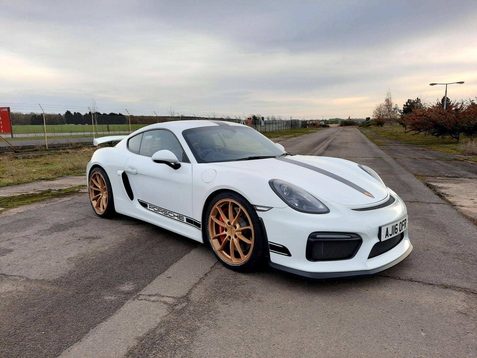

On a positive note, hopefully tootling this modded (inc. roll cage) GT4 through Silverstone in March :rock: With a wonderful MANUAL (stick) box.
