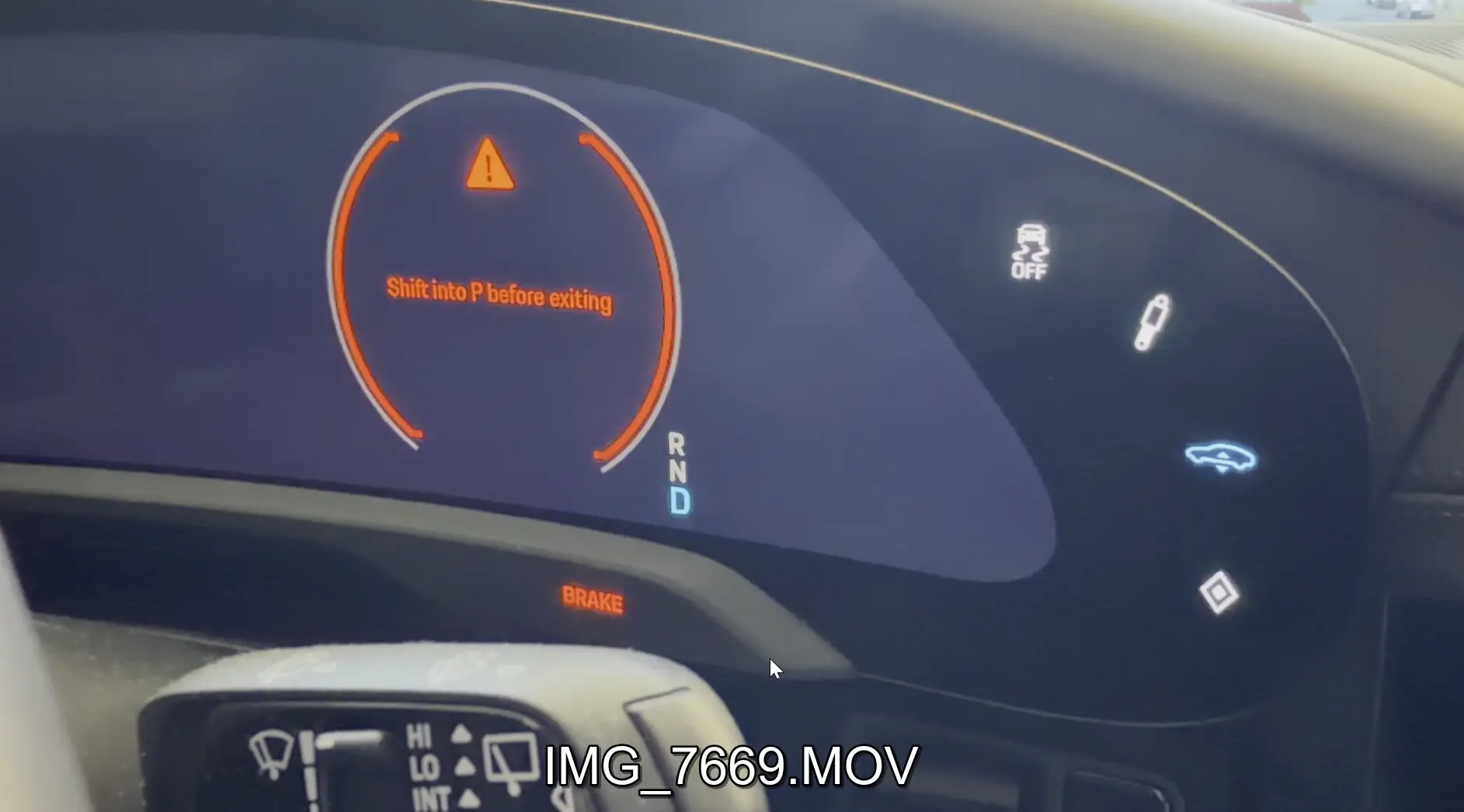

I have a video, plan to show it to the dealer and will upload here as well. I just need to edit it for privacy (cut or blur out PII), brevity (cut irrelevant parts out), and so it doesn't get NSFW rating (mute out some colorful commentary by me ;)). Will do it some time this weekend.

Would you really lock your car and walk away for 15 minutes when it shows it's in DRIVE and the car is beeping rapidly at you showing this?

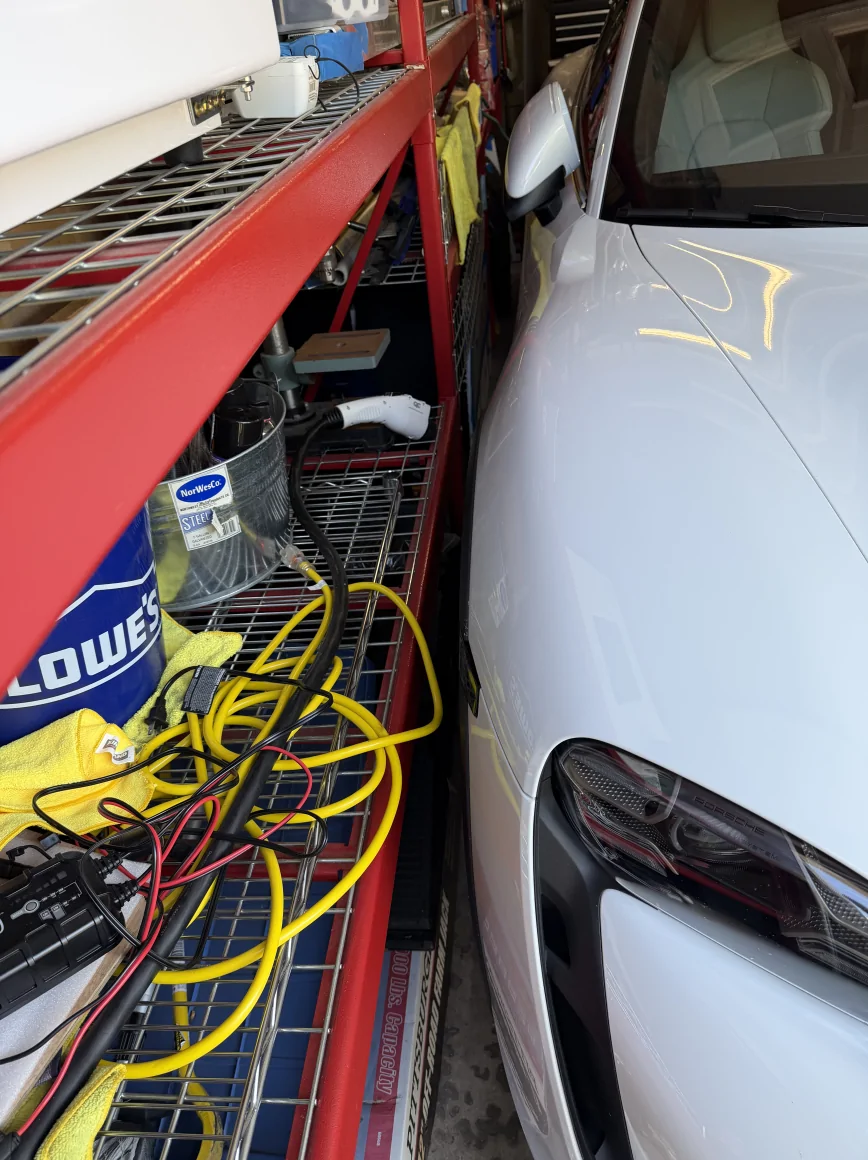

I wish I tried it. It was in a very tight garage, with little clearance around the car, and I was seriously worried about the car just taking off or rolling away into something (or someone) so I wasn’t going to get out of the car, kept my foot on or just above the brake pedal ready to react. I was actually considering calling someone on the phone to come plug the car in (was in my charging spot still) hoping there was some hard protection against driving while plugged in and put some pieces of wood under tires to keep the car from rolling away (I have wheel chocks, but they were inaccessible as my car is parked blocking those shelves in the garage). Then was going to open the hood and kill 800V just in case (while hoping the car won’t run me over before I cut its power).
My biggest issue is that the software seemed to be in a really FUBR state without apparently being aware of any errors, like it was on drugs, unpredictable.
