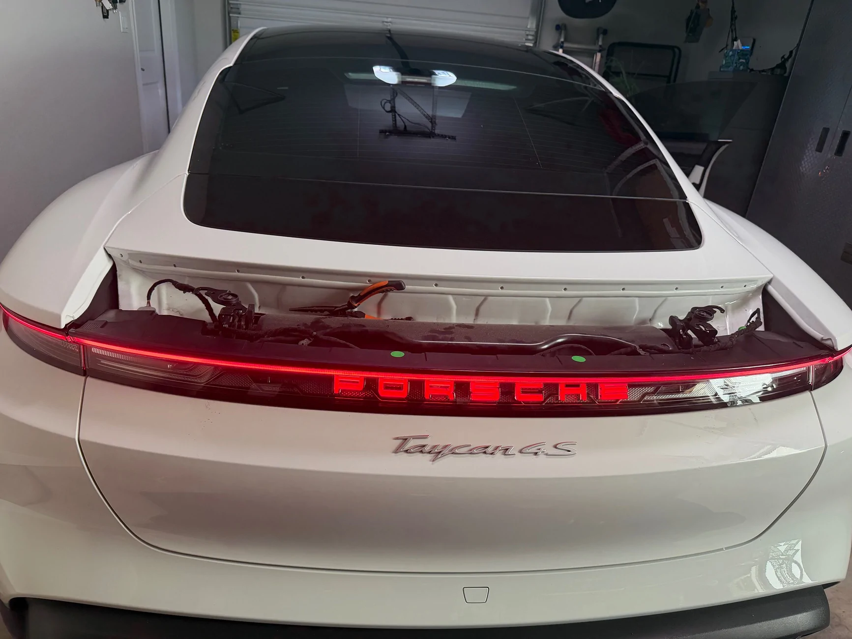

Got mine today! Took about a month to come in from Lithuania, super well packaged. Now I’m debating it installing it myself or just ask the dealership to swap it out while they have it to replace the tires.

Of course now I have to put everything back together 🤣
