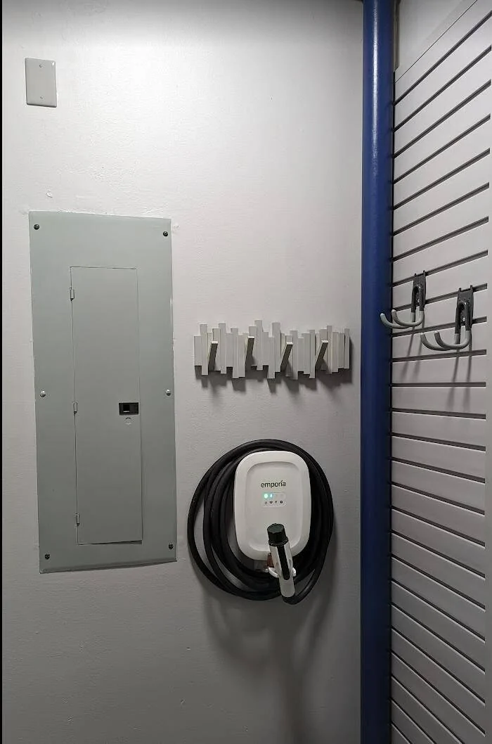

I went for a clean install of Emporia EVSE right next to the panel in the garage with no visible copper, so hardwired to avoid any plug overheating, which is basically an adapter, and get full 48Amp out of it. I love the clean install and ease of use. I do not have any need for flexibility to have all that additional wiring and large plug as I have 2 EA points 15 minutes away, EVGo 15 min away, and dealer with 2 chargers 10 min away.
Incredible set up! Thank you for the quick reply. I have an Electrify America station about 5 minutes from my house (free for next 3 years) and also the gas station near my house has an EV charging station (1 min away) which isn't free but could be useful in a pinch.

I was also new to EVs and was stressing out how I am going to do this and was overwhelmed with all the setups and Hubble sockets required and all the ugly cabling all over. Then I just said what if I just do the cleanest and simplest install and see if it works and it did as Taycan is in the second slot in the garage from that wall, and the cable reached just fine behind the wife's Macan. I could not be happier with getting max output, ease of use, and consistent success by just starting the charger from its app, then plug it in overnight (once a week it appears), using Timer only, and in the morning I am at 85% after most friendly charging, not that it appears to matter much, as in the battery is very resilient and will outlast the car. However, my SoH went from just shy of 100% at delivery and 34 miles to 95% in 1,000 miles. I am about to get a 1,500 mile reading today.
