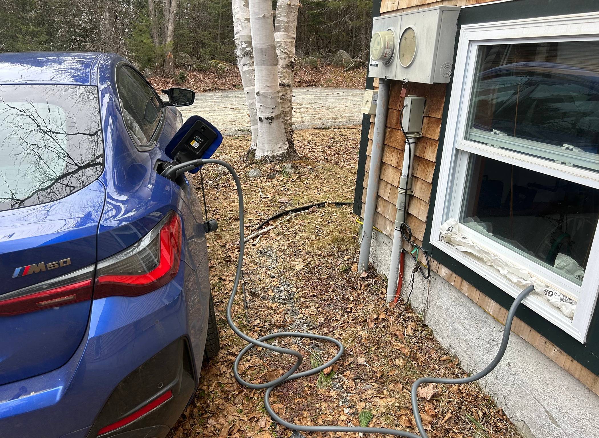

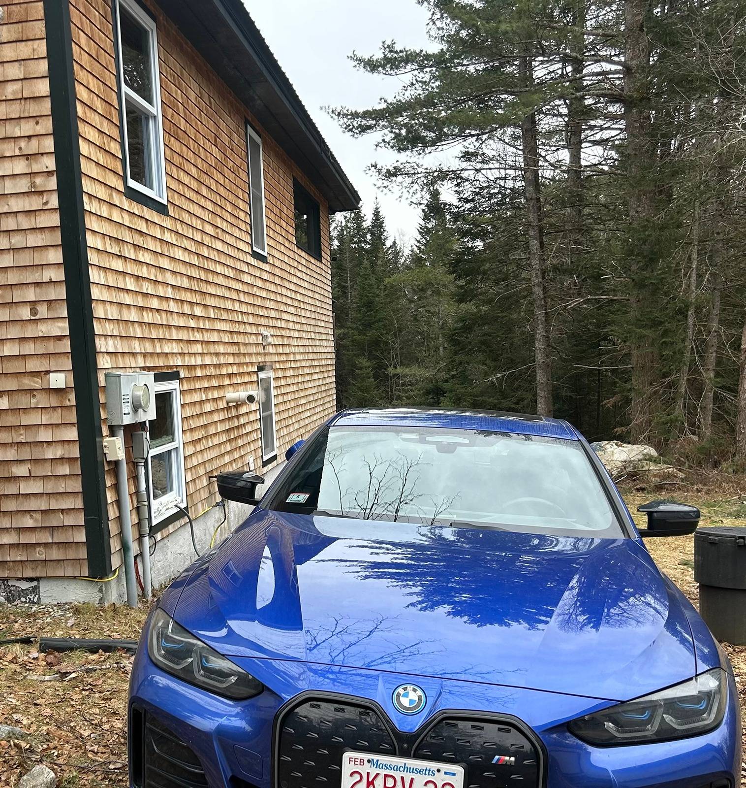

Charging my wife's i4 from the 30a dryer outlet worked just fine.
Minor drawback is that our i4 charge setting jumps down from 32a to 20a, in both the phone app and in the car, with the option for 24a not added until a mid-MY23 change that was part of subsequent firmware updates for pre-Aug builds.
Still though, her itinerary worked out okay for fully charging back to 100% at 20a instead of 24a worked. And the temperature at the plug never rose more than ~10F above ambient.
Electrician visited afterwards. Still waiting on the estimate (probably includes a 50% surcharge for non-residents!), but everything is straightforward for installing a subpanel in the garage and hardwiring a Tesla Universal Wall Charger.

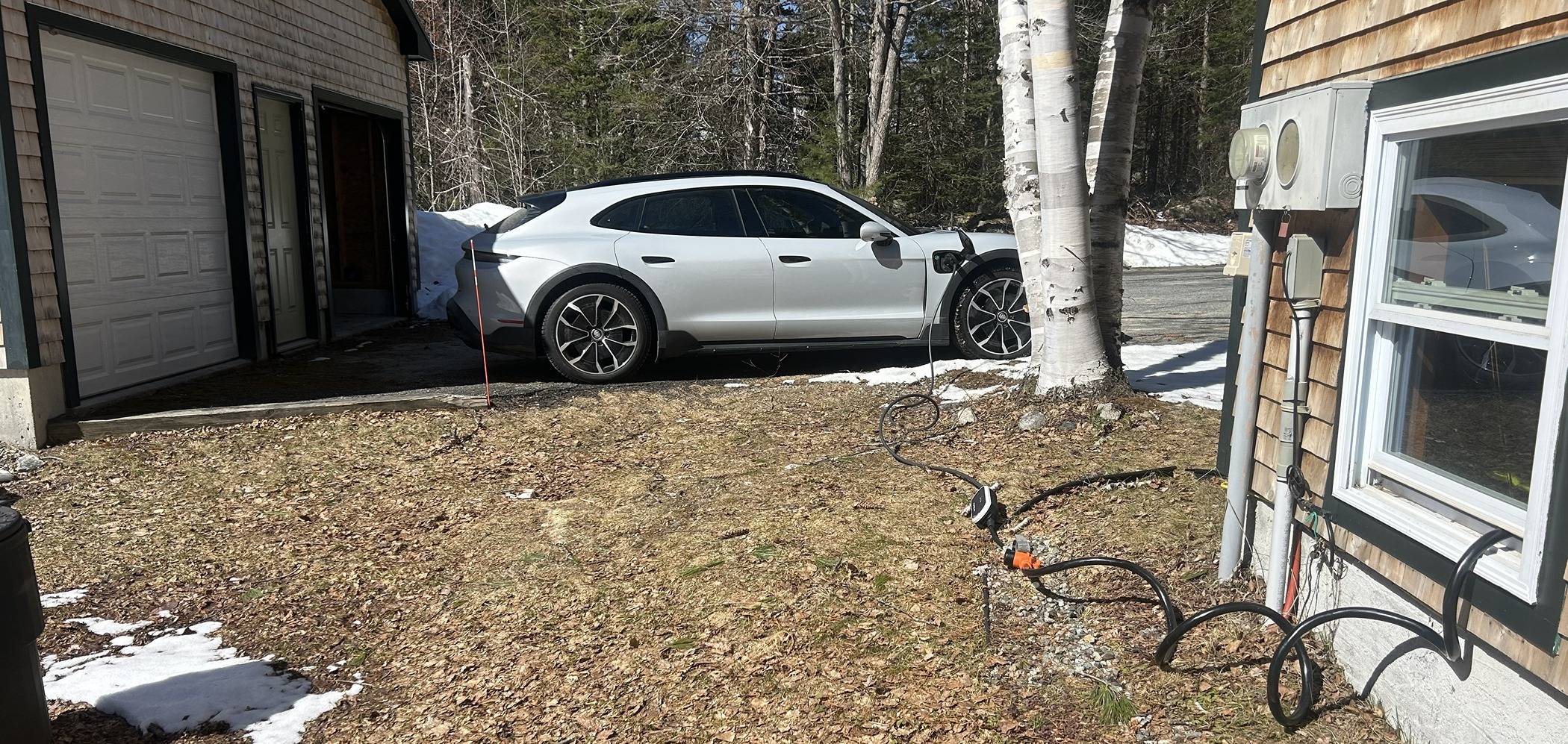

On my third trip to the new house, I did not need the extra cargo capacity of my A6ar, so took the 4CT instead.

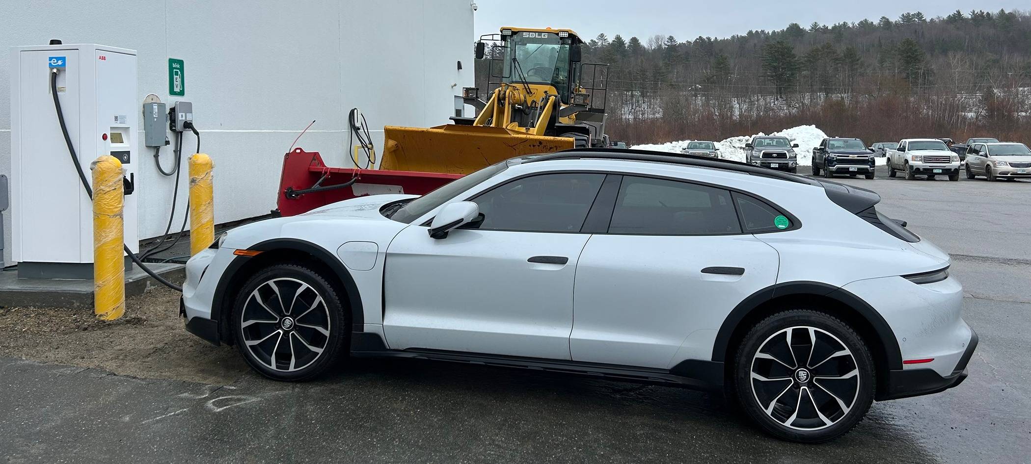

I wanted to stock up my fridge/freezer at a big supermarket along the way only ~20 min from the house, so that I wouldn't need to worry about everything thawing.
Fortunately within a [long] walking distance (and in the rain: https://www.strava.com/activities/11051620620) are two car dealerships with one 50kW each.
After getting skunked at EA so often by Bolts, ironic that I had the Chevy dealership charger all the myself:
Porsche Taycan Charger Installation Q IMG_5531
And it's not all that much slower than the typical EA 350kW charger in New England:
Porsche Taycan Charger Installation Q IMG_5534

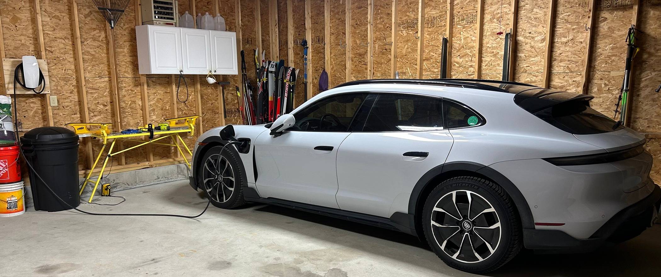

Each day I was driving only ~5 miles to skin up the ski resort, since the weather and snow conditions were not favorable for backcountry skiing on Mt Washington.
Given the efficiency of skinning laps at a ski resort instead of in the backcountry, my ratio of charge time to away-from-house time was high enough that the first three nights I use just L1 in the detached garage:
Porsche Taycan Charger Installation Q IMG_5539
And yes, the Tesla Universal Wall Charger box is in the picture just for fun.
Although installation is awaiting electrical upgrades, which are awaiting softer ground, which could be awhile given that winter keeps returning.

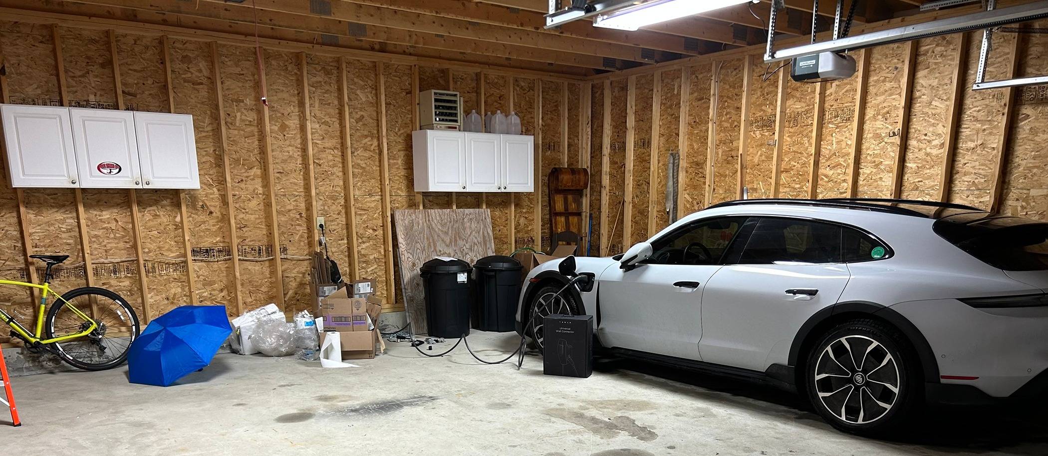

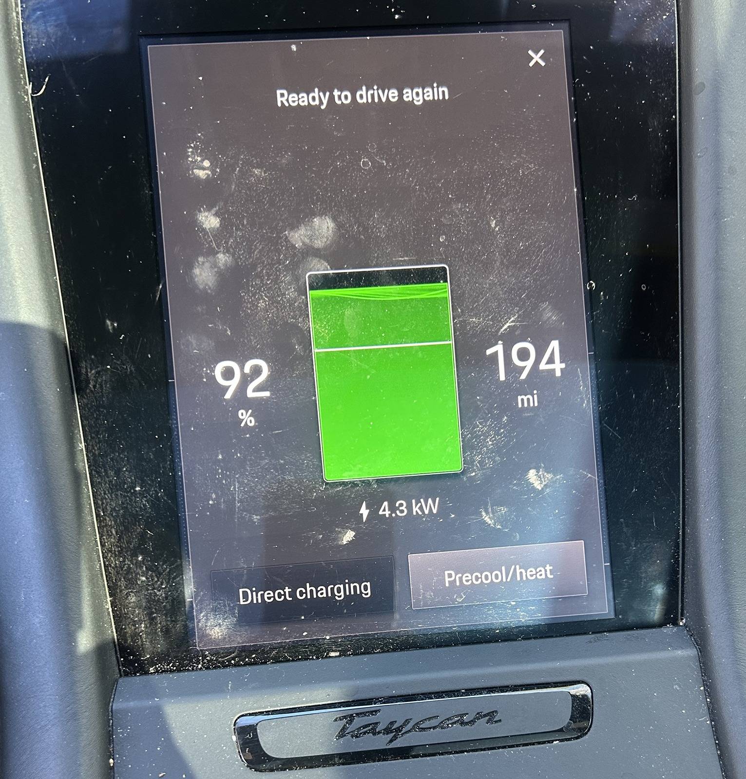

Yesterday afternoon, upon returning from my fourth and final ski day on this trip, I wanted to make sure I had 100% before driving home, just in case of ... something.
L1 charging might not have achieved that, so I set the Porsche charger to 50%, swapped out the L1 plug for the 14-50, plugged it into my mongo-thick extension, plugged it into the adapter, and then finally into the dryer outlet, with the laundry room window close the driveway.
The 4.3 kW rate is faster than a typical shared ChargePoint L2, so good enough for this situation.
Porsche Taycan Charger Installation Q IMG_5568
Porsche Taycan Charger Installation Q IMG_5569

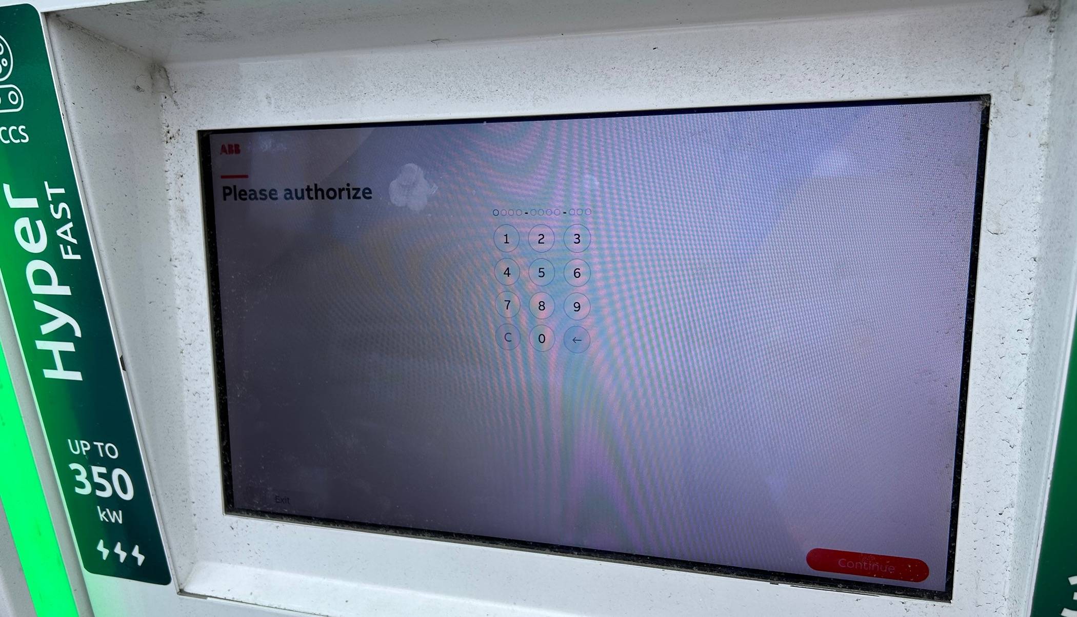

Fortunately the charger became inoperable after my session, not before.
And never even got above half where I should have been on my charging curve despite being an ostensible 350kW unit.
Quite the difference from how my wife hit 212kW on her i4 last week at a Magic Dock.
(And all my Taycan Magic Dock speeds have been faster than all my EA speeds despite the 350 rating.)

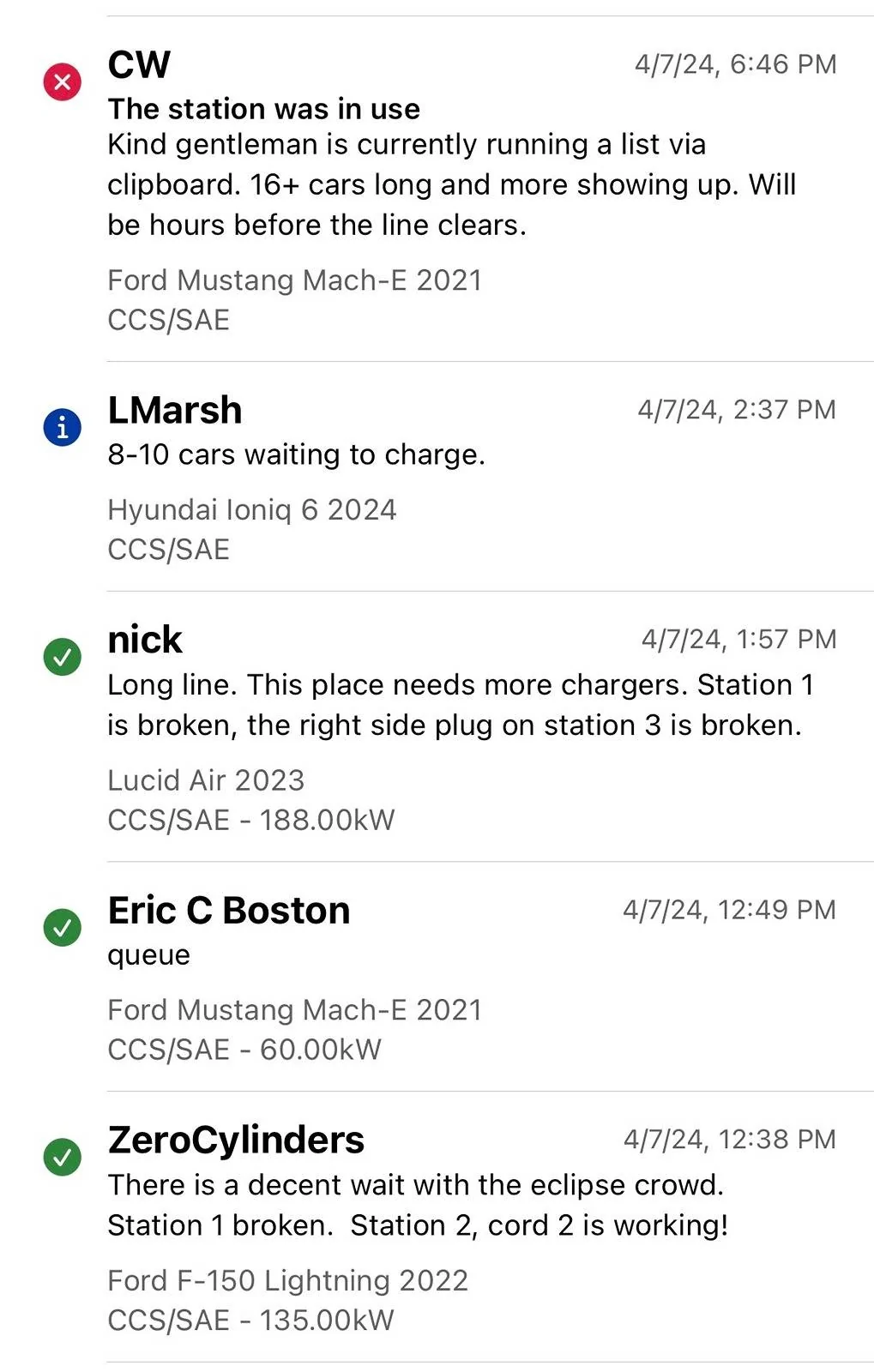

Which is especially good given that trying to charge yesterday would have a been a disaster with all the eclipse traffic, as shown here for the EA station near the junction of I-89 & I-91, that same station I had stopped at Wednesday, but must have been something like a wait of four hours to get a charger then actually charge (i.e., if 16+ = 18, then for three working chargers, have to go through six rounds, and if each of those plus your own is only a little over half-an-hour...):
Porsche Taycan Charger Installation Q IMG_5691
