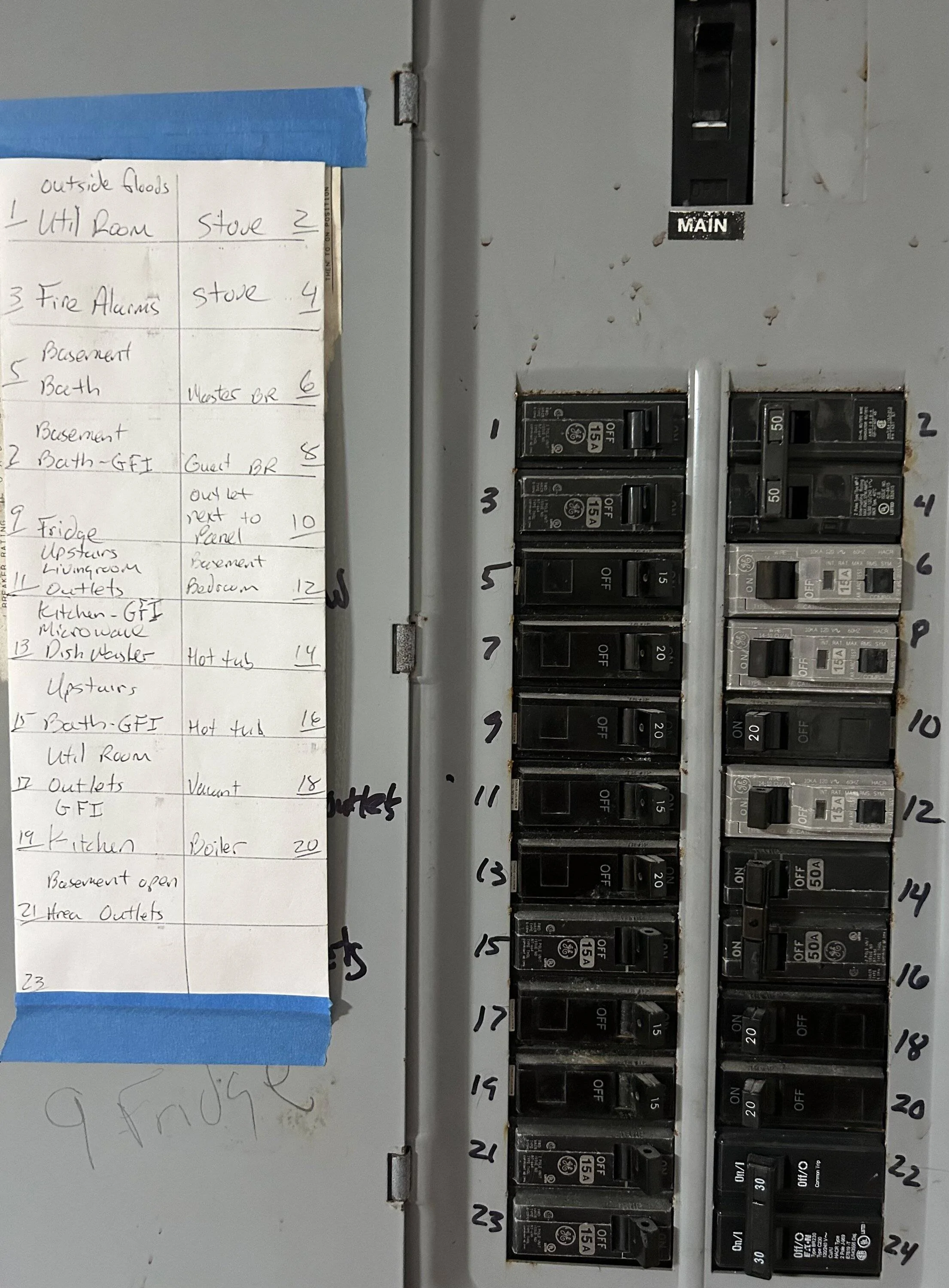

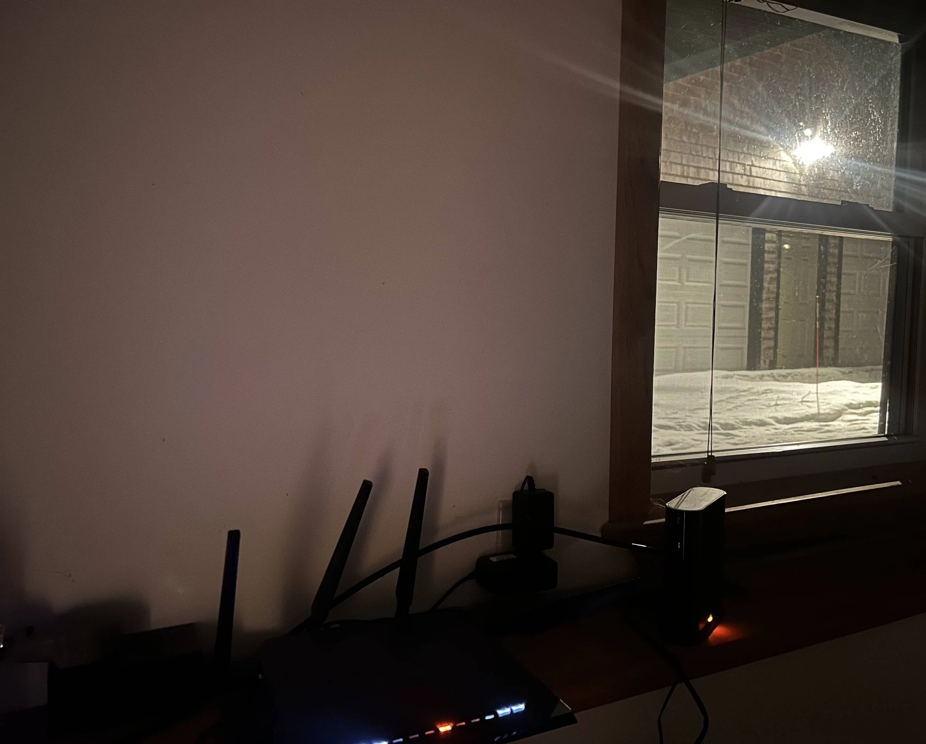

Although my friend ended up not bringing his Prius PHEV, the setup seems perfectly straightforward:
  • laundry room has 10-30 receptacle
  • hooked up to a 30a breaker (#22&24 in the picture, which I tested by turning off while running the dryer)
  • receptacle is adjacent to window
  • window is adjacent to parking
  • window is also close enough to detached garage to run an extension cord
