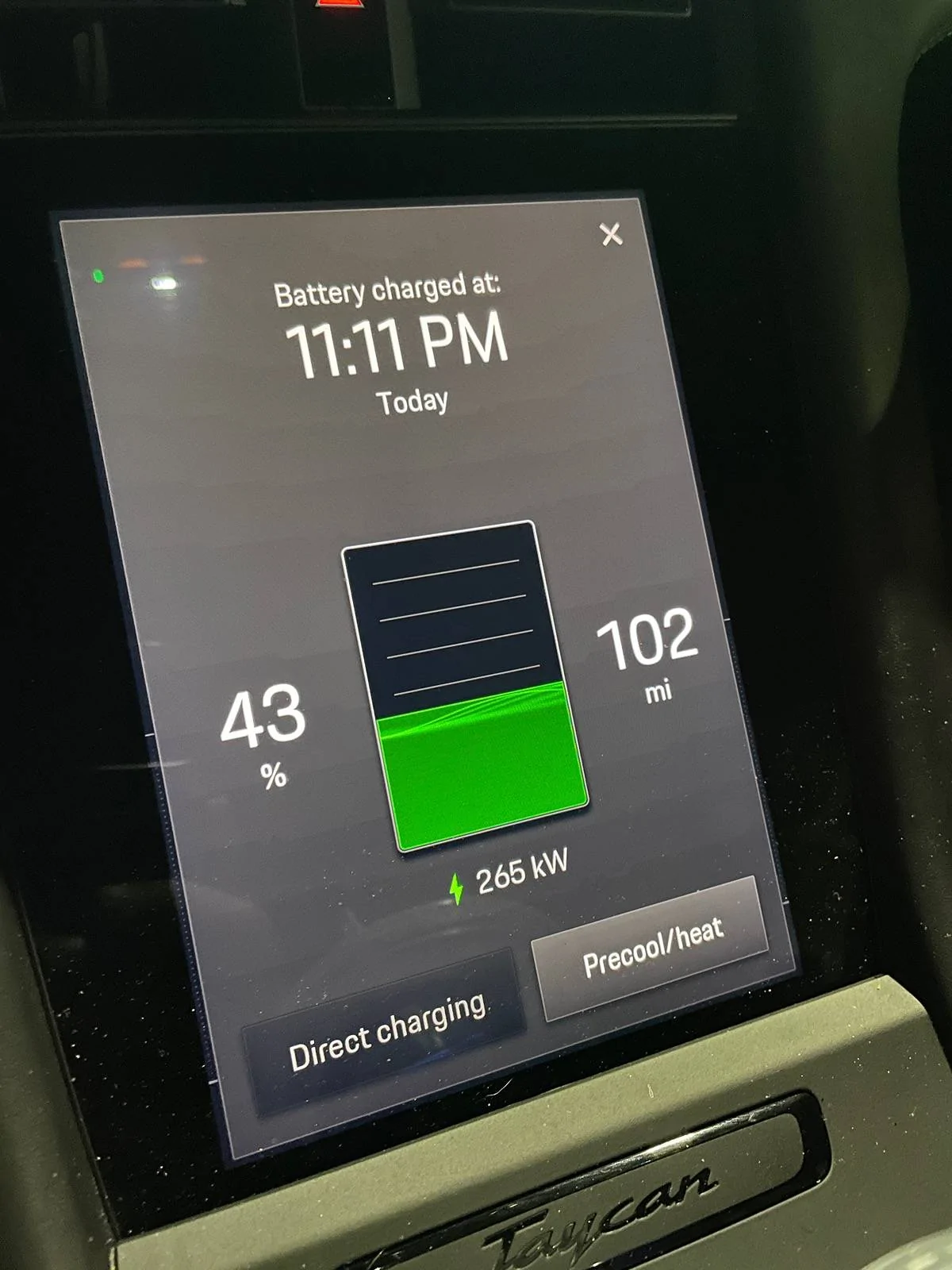

I hit over 260 a couple times at EA stations. I have been lucky and/or good and will take either ?
Porsche Taycan Charging at 269 kW IMG_1104

On the screen, is the button to select Precool/heat for the battery preconditioning? I was told by my salesman that this was to preheat/cool the interior & not the battery.
If this is for the battery then how long does it take to reach the ideal temp for charging if I select precook/heat with a typical outdoor temp between 65 & 75 degrees in my garage?
Cabin.
As was pointed out earlier, the only ways to precondition the battery are to a) select a charger (HVDC) as a destination in the built-in nav, or b) switch the car into Sport Plus mode.
