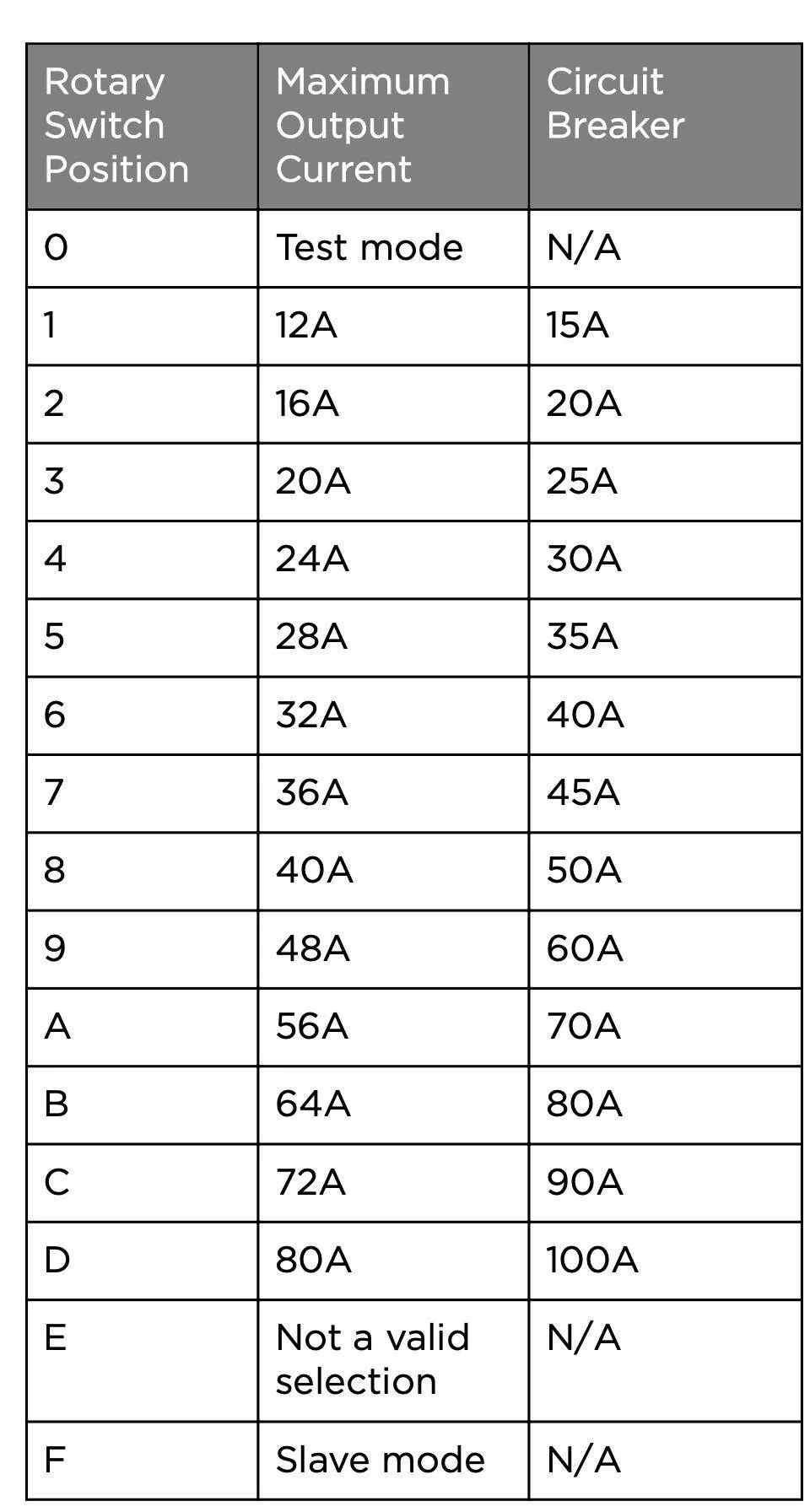

have you checked the settings inside the Tesla Wall Charger to make sure it's set to the correct breaker setting?
you can safely set the Tesla Wall charger to a lower AMP setting than the breaker - for example if you have a 50 amp breaker - Rotary Positions 1-8 are all "safe" electrically (turn off the breaker before making any changes to the Wall Charger) - I'd set it to position 7 or 8 and see if it stabilizes the charging session.

The wall charger is set to deliver 40 amps and that is confirmed on restart when four green light illuminate on front panel (5 lights would indicate 48 amps, the max for the generation 3 charger).
