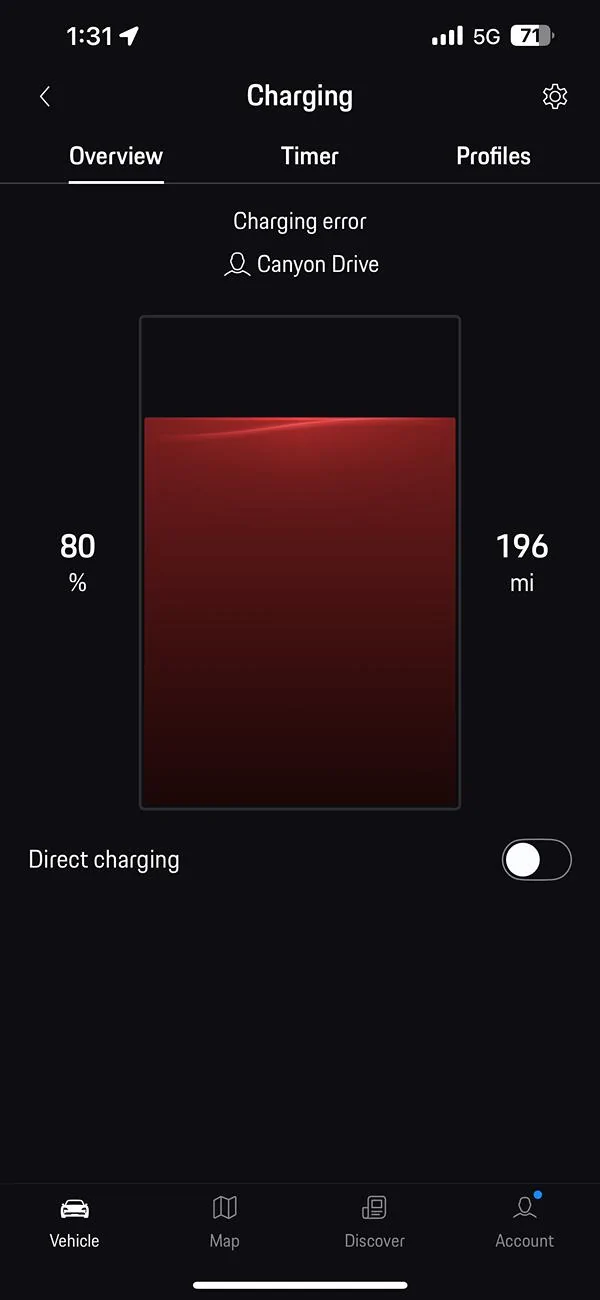

Charging error once I get to 85%

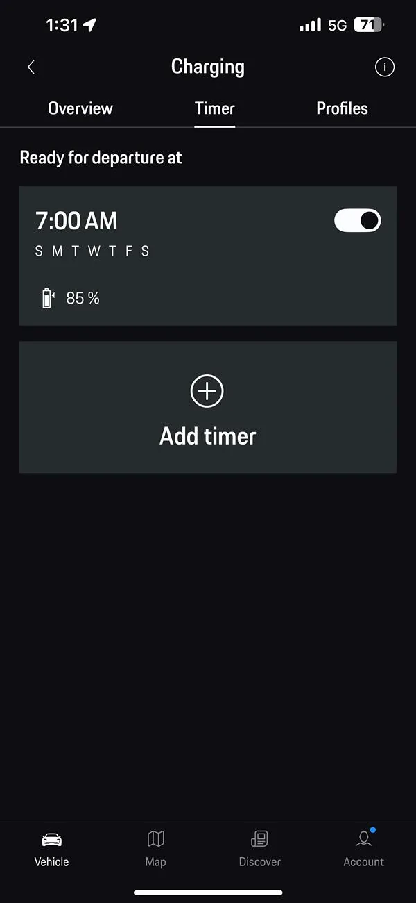

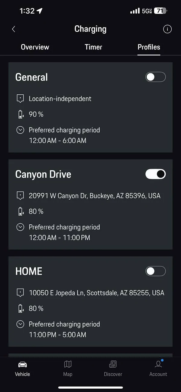

Don't know if this matters but both your profiles, home and canyon, say 80% and the timer screen shot says 85%. I'd set them all the same and see if that matters.

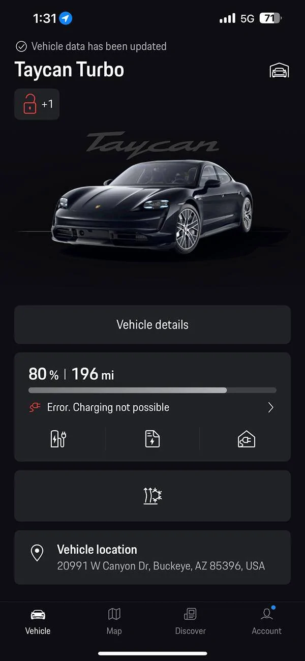

More information… I only have one profile selected now. No timers at all. When 85% was reached my home charger sent a notification to my phone that charging has stopped. I opened my wall charger app and it said “Charging stopped”. Zero amps being sent to car. I opened my Porsche app and it said 85% and the green battery graphic went to white and it said, “Initializing…”. (Typically what you see when first initializing charging). I believe since my wall charger was delivering zero amps. The car gets an error message and the battery graphic on my app goes to red. The question is… with only one profile set at 85% and no timers selected. Why is the car wanting to initialize again after completing a charge to 85%?

In profile you set the minimum battery % the car will start charging towards as soon as you connect it to a charger. It will not stop at that % after reaching it, it will continue until 100%, if you don't have a preferred charging time. Otherwise, it will pause, and continue until 100% when the preferred charging time comes (or however much it can charge until the preferred charging time ends)
Under timer, you set a max charging limit that the car will reach before the departure time you set, for example 7AM. The car will charge to that % limit and stop. For it to work, you need to activate the "Repeat" slider, otherwise that timer will be 1 single use, and you need to select in which days of the week the timer that sets the max % limit will be used - if you want every day, select all 7 days.

@chun does a good job of explaining how it works. You do have a timer activated based on the screen shot in your original post.
My profile is "location-independent" set to 25% (which means it charges up to that amount when I plug in, and optimized charging; yours looks to be set to 80%. I do not have a time range setup in the profile). My timer is set to "ready for departure" at 7:30am, 7 days a week, at 80%. If I plug my car in at noon, it charges to 25% immediately and then sits in "pause" mode until it needs to start charging again in order to get me to 80% by 7:30am. Works every time and I don't ever get an error.
I'd suggest you change your profile to be location independent and set whatever min charge you want with no timer. Then when you plug in it will charge to that min charge and sit in pause until it needs to come on to hit your "ready for departure" time.
