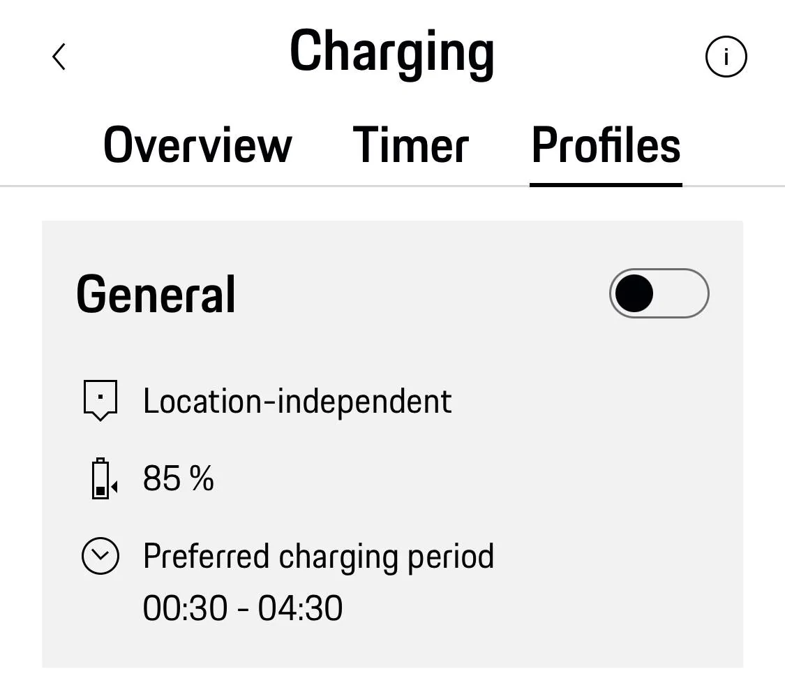

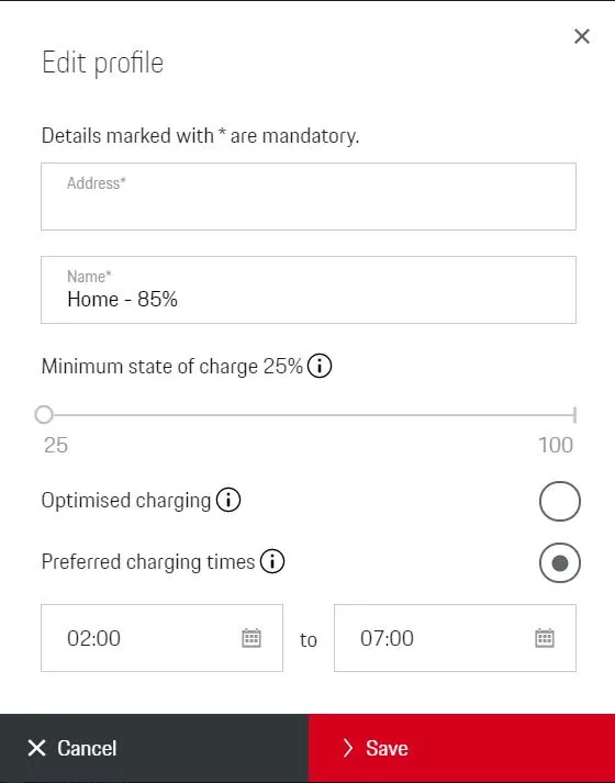

So if already charged then I assume you've disabled the Profile (and Timer) if still connected to your wallbox.
I'd recommend the Location based Profile and TImer setup - here's what I've used since 2020 (until I went OVO Charge Anytime (£0.07p / kWh) which automatically creates and controls its own Profile in the PCM) - works flawlessly. Leave your car connected and as the example is a daily timer it only comes into play if the car is physically connected to your wallbox (EVSE) - so set once and forget.

That's exactly what I've set up now folliwing the instructions in the first reply.

Hey folks,
New Taycan owner here. Set up a charging profile for 85% max on the hours of our cheap overnight charging (it was enabled, I disabled it in case it was the problem).
But now I find it keeps charging to 100% and I'm away for the week and left it plugged in (as I've done for years with a Tesla and it would just sit at 85% no problems).
What am I missing? Why is it overcharging?
Thanks!
