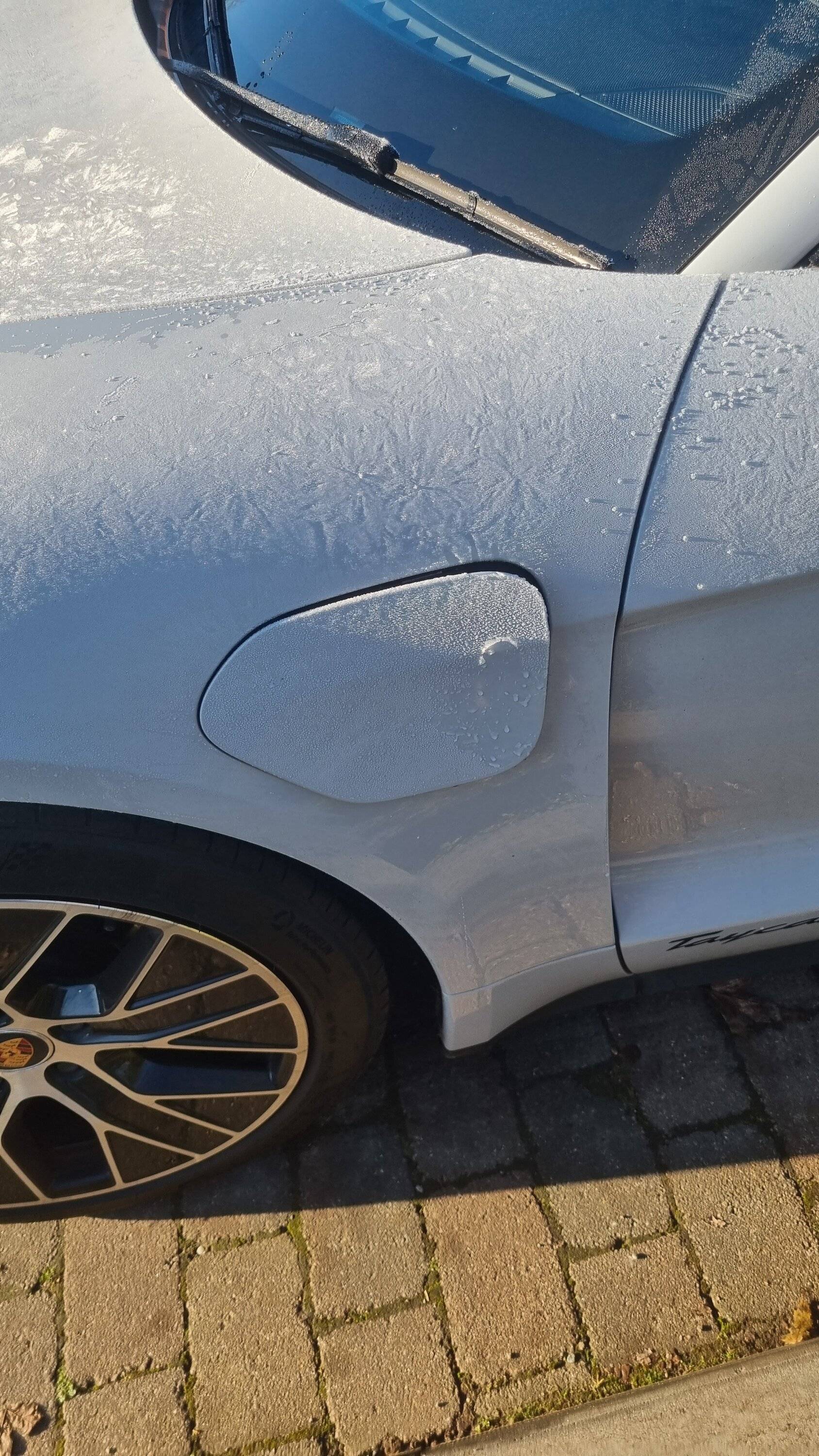

Neither of the automatic charging ports will open. This happened before and it was at the dealers for a week. Worked ok for a around 2 weeks and now gone again. There is a tool in the toolbox to over ride the switch which rather implies a known problem. I’m nervous about damaging the port if I use it. Anyone else experience this?
Me also TAYCAN 4S 2020 with no reason.Dealer does not know ,i will take them tomorrow again to see.The problem is now 2 weeks

Finally they found the problem.It is the outside sensor of the drivers side.They took it out and the port is working from inside and the passenger inside and outside.Thanks god

Same issue. Dealer said they could not ID if it was left or right sensor through system log, so they needed to dismantle door and panels to check. One would expect the IT-designers at Porsche to be a bit brighter than this...
They also only had right sensor in stock. Delivery of left sensor from Germany would at least take 1-2 weeks. So I gambled and asked them to replace right sensor. Car is just out of warranty, so cost will be around €500. The cost is 20 % sensor and 80 % mechanical access……. This issue will be cause a lot of problems/bad publicity for Porsche, since it will affect a lot of cars...
