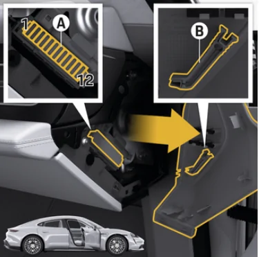

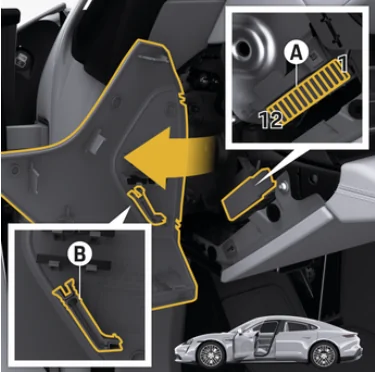

Check the fuse box in case there is a dedicated fuse for it which might have blown.
Can i check myself?Is it on the left or at the right side? Or will i tell them to check it themselves?
