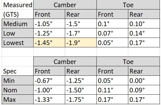

This is a chart from another thread that I found interesting, not only for the difference between a real car and spec, (which I would expect on a Chevy Malibu but not a Porsche) but the difference at heights. In all cases I’d expect camber to be impacted but it’s a very strong case for absolutely neutral toe at the center of the arc
