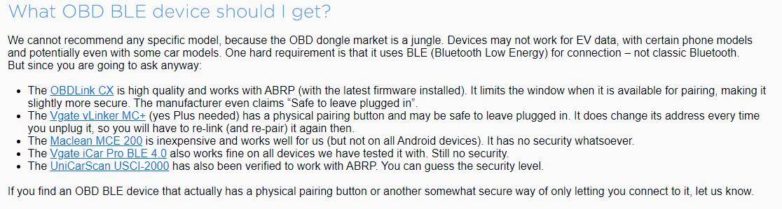

So right now I'm torn between:
OBDLink CX €96.50 shipped from France
Vgate vLinker MC+ €44.95 shipped from Germany
Vgate iCar Pro €29 shipped from Tschechia
What's the difference between the iCar and vLinker? Hmm

I ordered the "Vgate vLinker MC+" basically because it apparently is the model superseding the iCar Pro (supporting larger data packets?) and because it's half the price of the OBDLink CX.

I haven't found major differences. I didn't know about the "Vgate vLinker MC+" having physical pair button when I ordered it. It is probably more secure but a chore to unplug/replug unless you leave it in plugged but then you get that Red error on startup, right? Or is that just a one-time message when you plug in the device?
Will be cool to have it plugged in and display Car scanner live on the PCM while you drive. I always appreciated that in my other cars. Of course the novelty wears off quick and I'm not interesting in seeing the kW flow while driving (at least not all the time).

Like others who have commented, I have the verbosely named 'OBDLink CX Bimmercode Bluetooth 5.1 BLE OBD2 Adapter'.
I tried to use OBD link app and I am getting the high voltage warning message. How do you get around this as I am interested to see my battery SoH. Thanks
OBD link app doesn’t work with Taycan. Use the CarScanner app and ignore the HV warning message that pops up in the Taycan.

There's a thread logging "Baseline for HV Battery SoH Performance" and he's using Vgate's vLinker MC+
Yes, Vgate vLinker MC+ and Car Scanner are the recommended OBD solution for Taycan. I have those.
