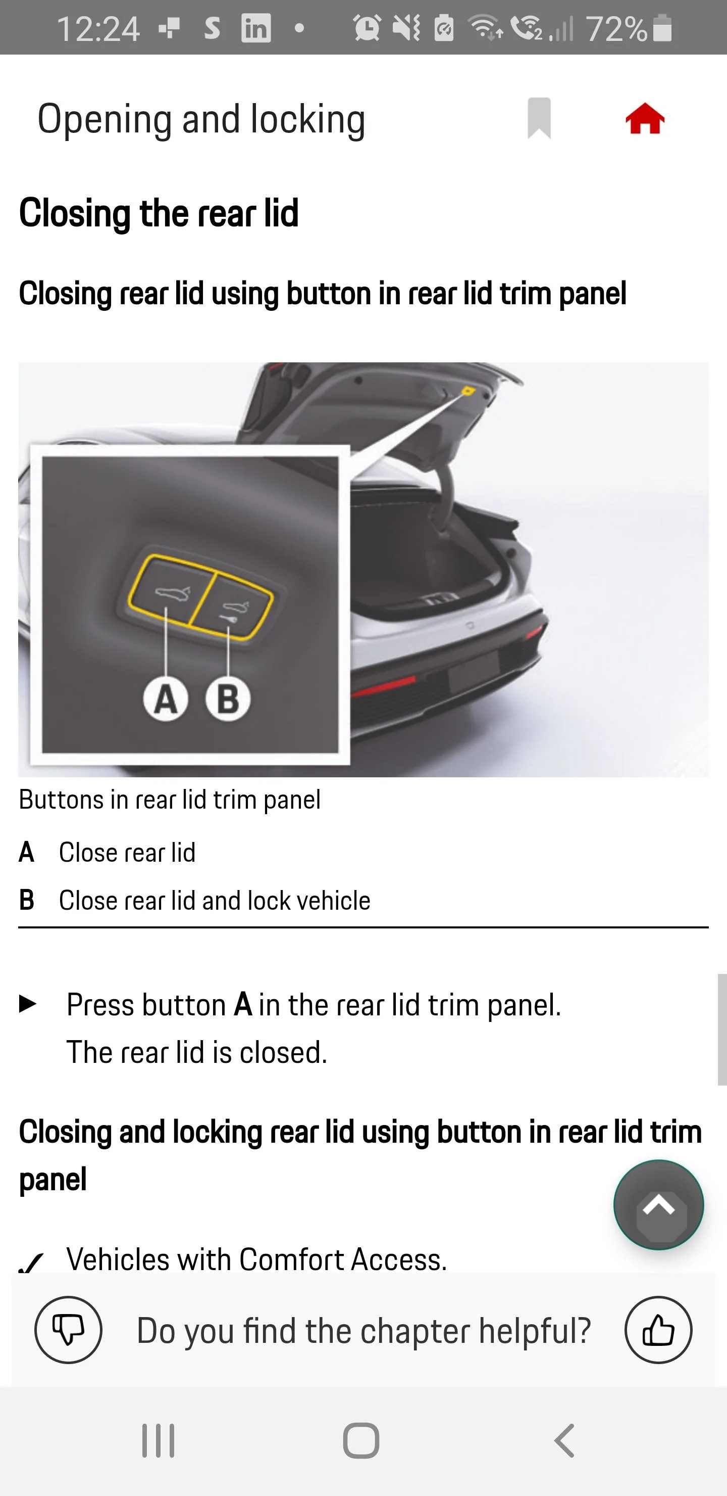

The standard trunk has power opening and closing - a single button to close. Cars with comfort Access have 2 buttons. The 2nd closes the trunk AND locks the car.
Lock the car with the key fob.
That’s what I’m saying - you either have to touch a door handle or use a key fob to lock the car. Otherwise, you’d be able to just press a button that would close the trunk and lock the car. Thanks!

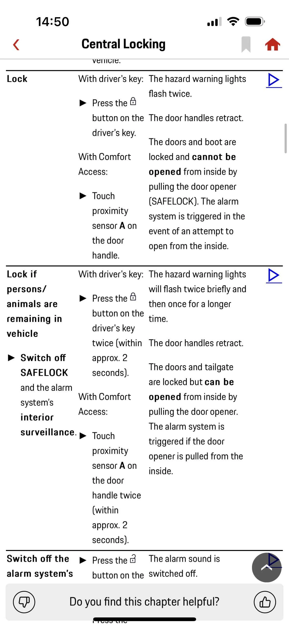

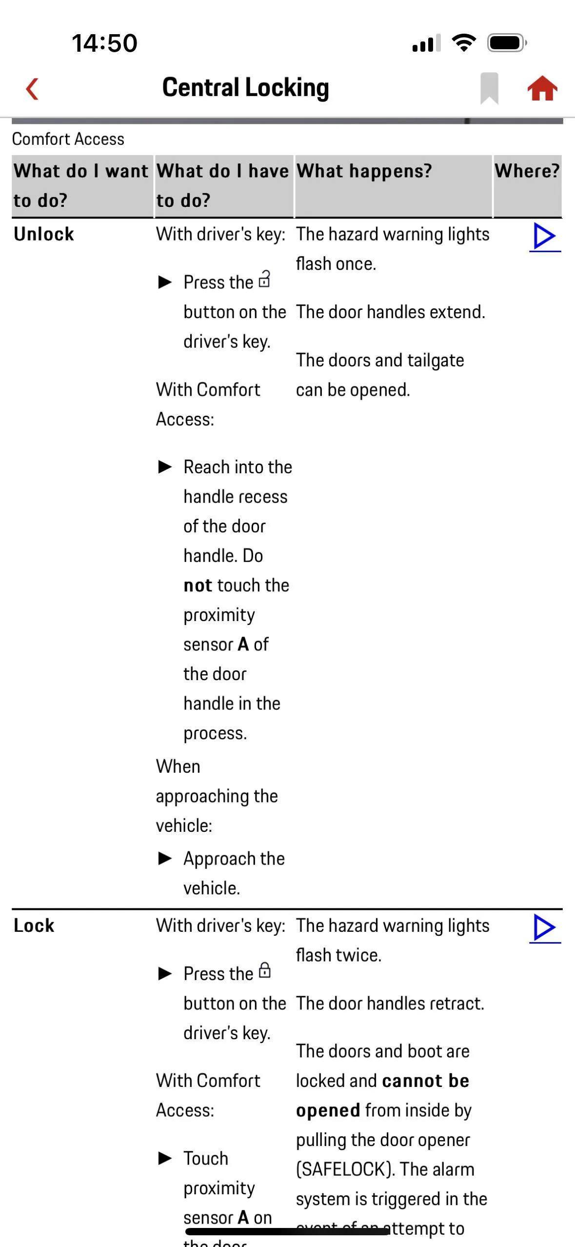

The car only auto locks if no door, trunk, frunk is opened within 45 seconds after unlocking.
In all other cases you physically have to do something to lock the car via one of 3 methods: 1) key fob, 2) touch a door sensor if comfort Access installed, c) press the trunk close and lock button if opened and comfort Access installed.
This really doesn't need such a discussion and there's also the owner's manual if it all gets too difficult.
