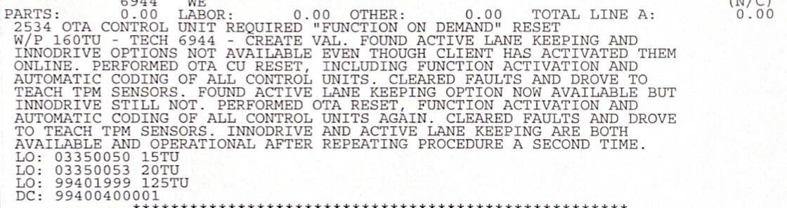

Well I got ALK and InnoDrive activated today at the dealership.
I am not sure it was activated "correctly" though - it still shows waiting for activation on the web, and there are no entries to toggle it on/off in the Porsche Connect PCM settings. I hope I like them since there now appears to be no way to turn them off other than in the cruise control settings. :)
One suggestion: turn off Innodrive speed limit obedience, to prevent sudden decrease in speed from for example 80 to 50 whenever it spots a 50 sign.
