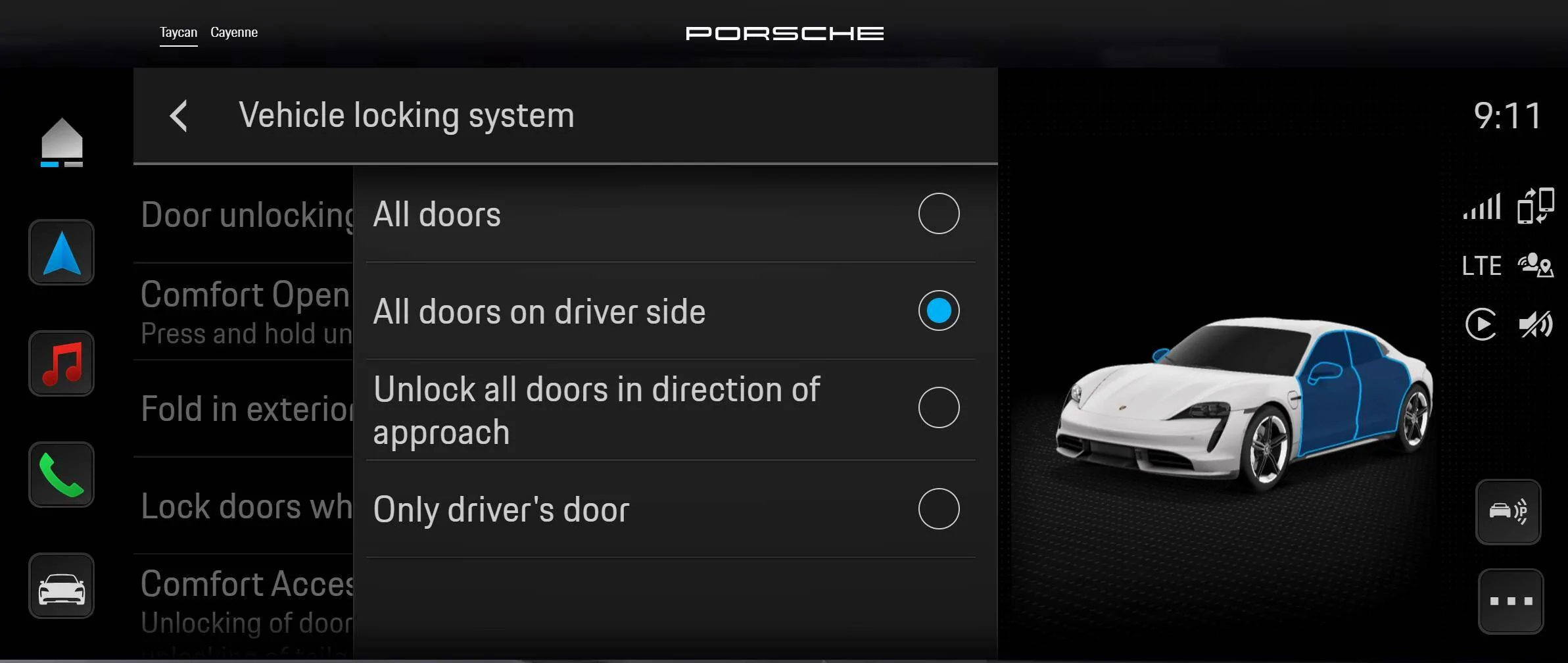

There is an option to do this. If you go into ‘settings’ on the PCM you will find one that will offer the option of opening either just the driver’s door or all four. I can’t remember exactly how you find the option, but you should be able to find it in the ‘manual’ on the app.

It’s a safety feature to prevent someone from waiting next to your passenger door and carjacking you, but yeah… easy option to change.
This.
I think it's in "settings">"vehicle/car">"locking systems" or similar.

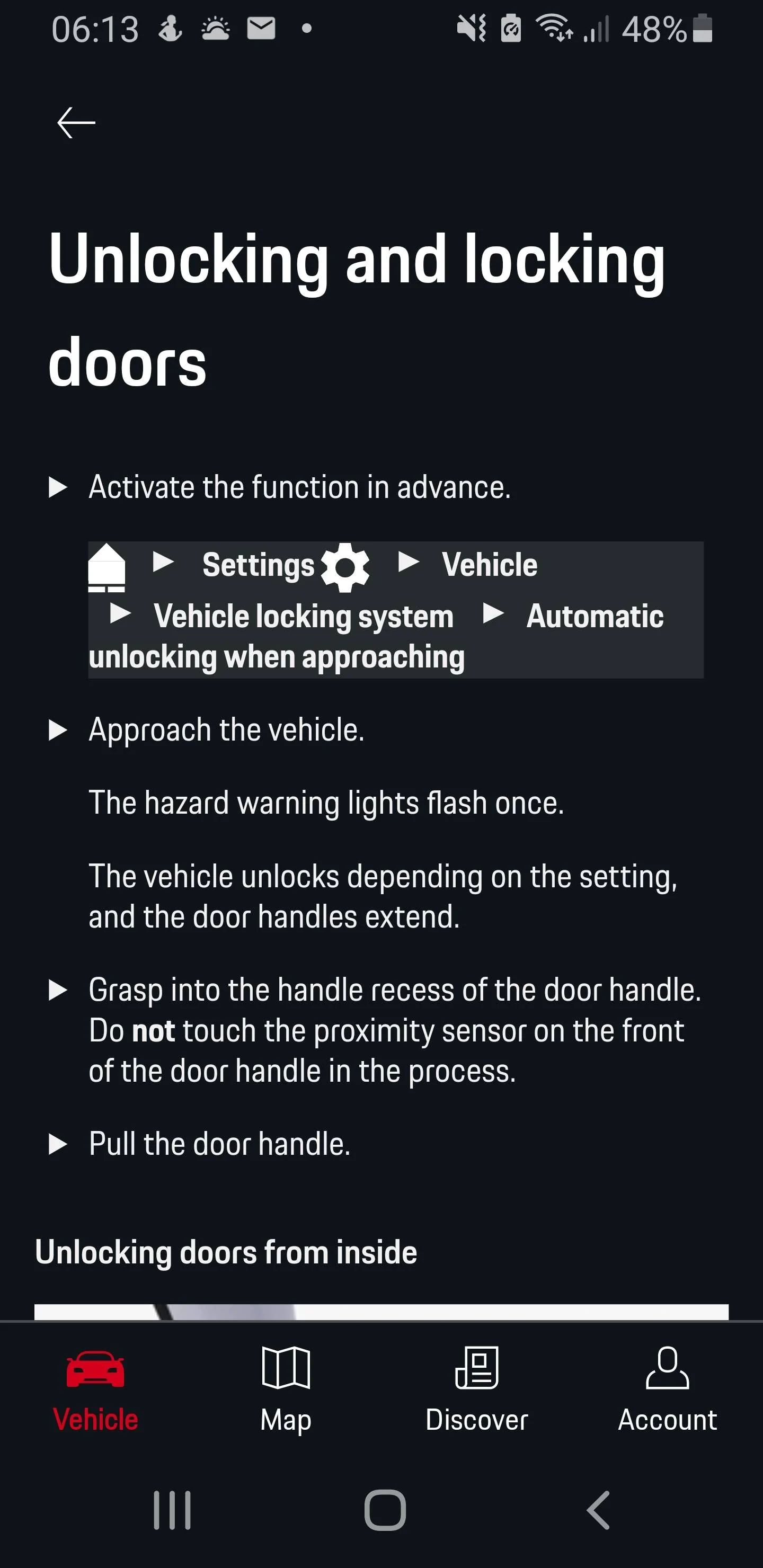

Consult the Owner's Manual
A feature on many cars these days where the behaviour of the central locking can be programmed.
Double tap on the keyfob to unlock would deploy all handles.
Can be configured for all doors, driver's side or driver's only.

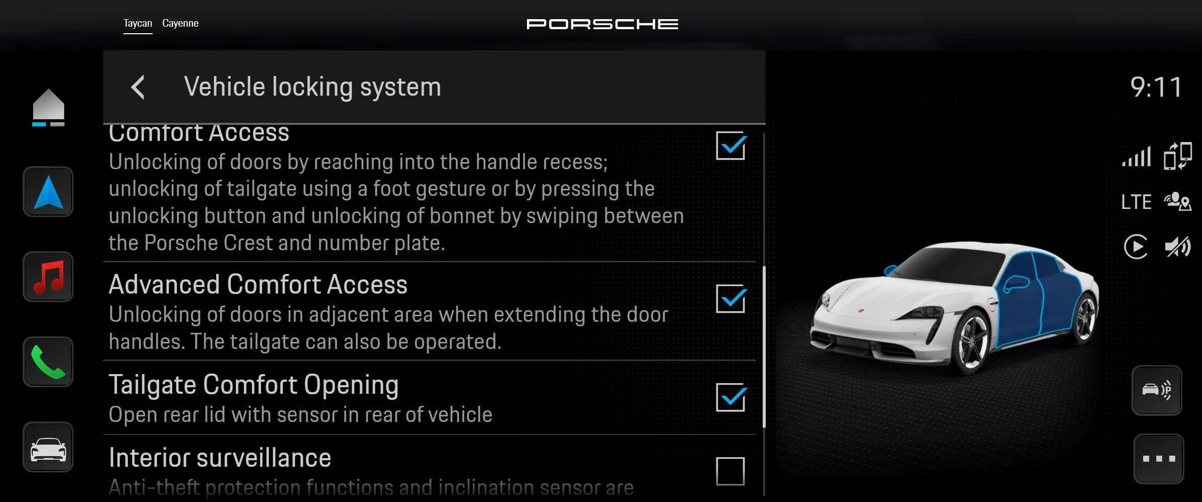

Thanks for your reply but I think the option I would like is not available in the menu. Comfort access activated, no option to unlock all 4 door when approaching the car.
As I see the only alternative is to double tap the Keyfob. Software in the car is updated.
Any other car I have or I had did that by default. Weird.

I was going to note that maybe it's region specific. But you're in the UK and mine works as we've noted above...
So either you're not looking in the right place, or there's something not right with your software set up - that would be a trip to a dealer.
Does this help:

Thanks mate! That answer my question! I do not have, see that option!!! Door unlocking not there!
I thought I was losing it 😃

I have phoned the dealer and they have suggested to pop in so they can have a look. at why it is not displaying the door unlocking otpion.
Ill let you know. I might be able to pop in this afternoon...

Just checking that you paid for Comfort Access as an option?
