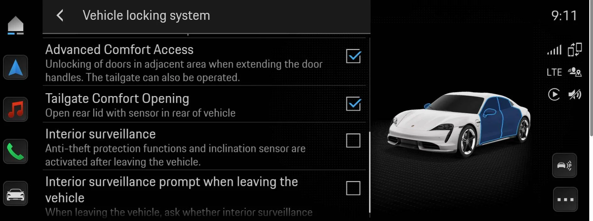

Without comfort access, you need to use the key fob to lock and unlock the doors. When you unlock with the fob the handles pop up /deploy
With comfort access, you touch the underside of the door handle and the handle pops up /deploys (no need to use key fob)
With Comfort access, you can also select "enhanced comfort access", this will pop the handles out when you walk close to the car

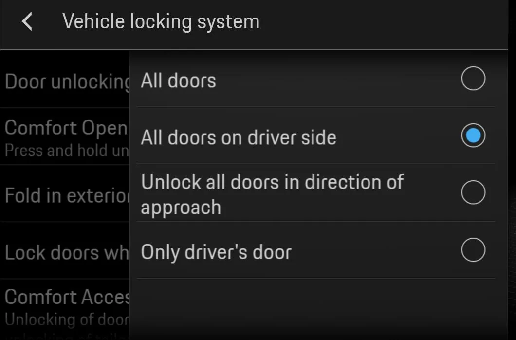

That’s good to know, thanks. Do you have any options to enable or disable the settings on the pcm?
