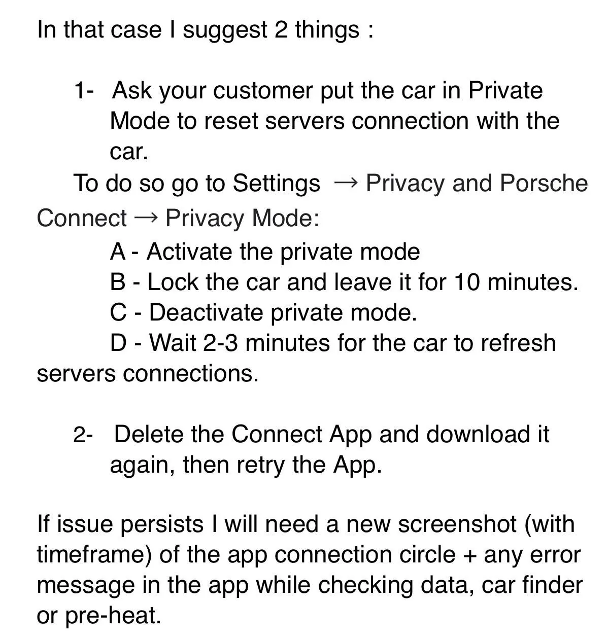

I don’t know if this will help but my dealer sent me this when I was having connection issues. Your situation sounds different but worth a shot perhaps.
Porsche Taycan Connect App / Website F3AA386C-21B5-4630-9BC9-710EEFBB2166
