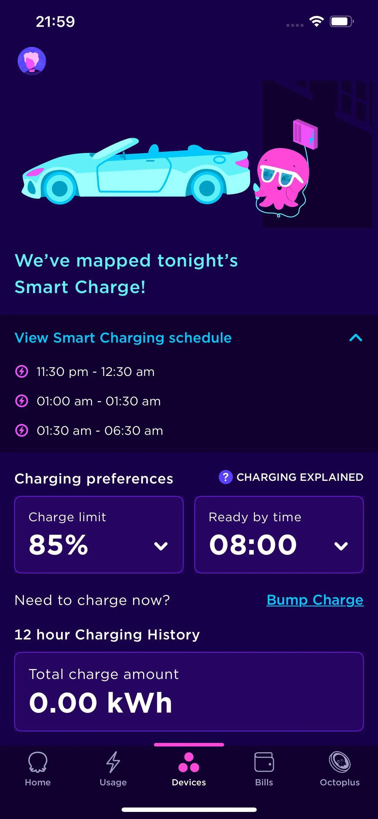

I have the dreaded red ‘no connection’ dot in my app, but the Octopus Energy smart charge service has mapped my charging session for tonight so the connection must be working?
