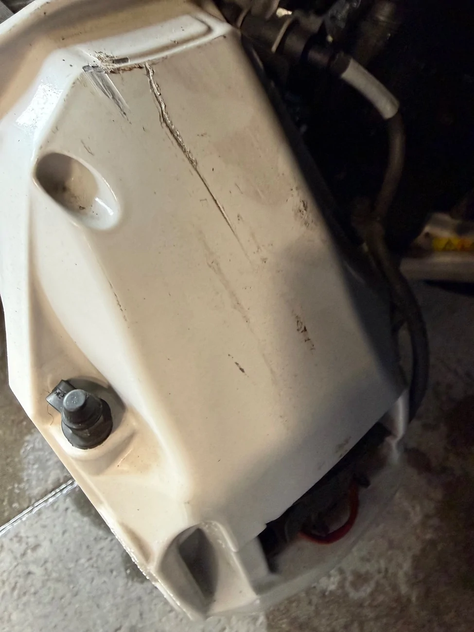

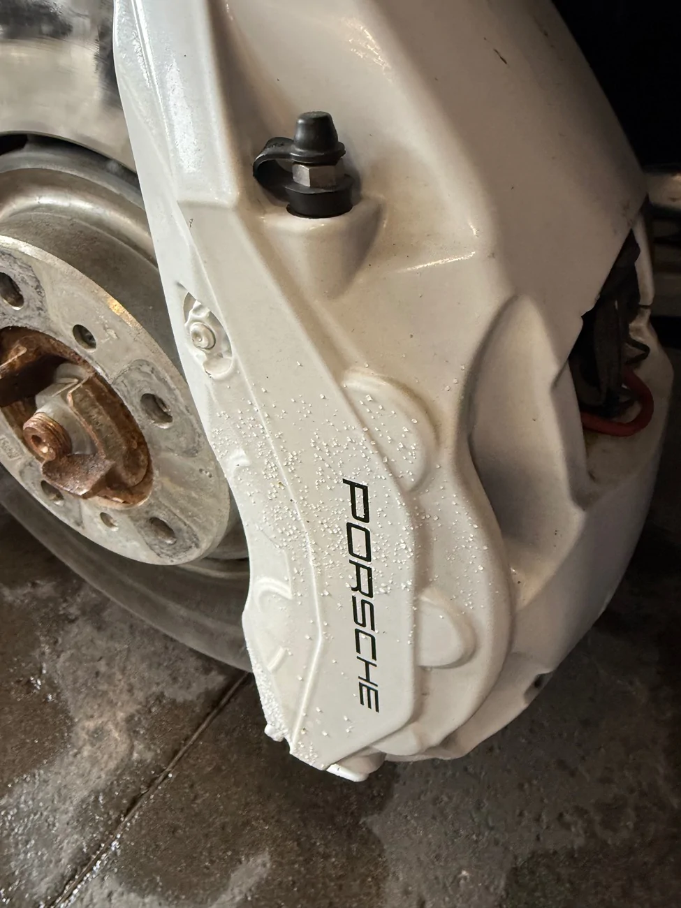

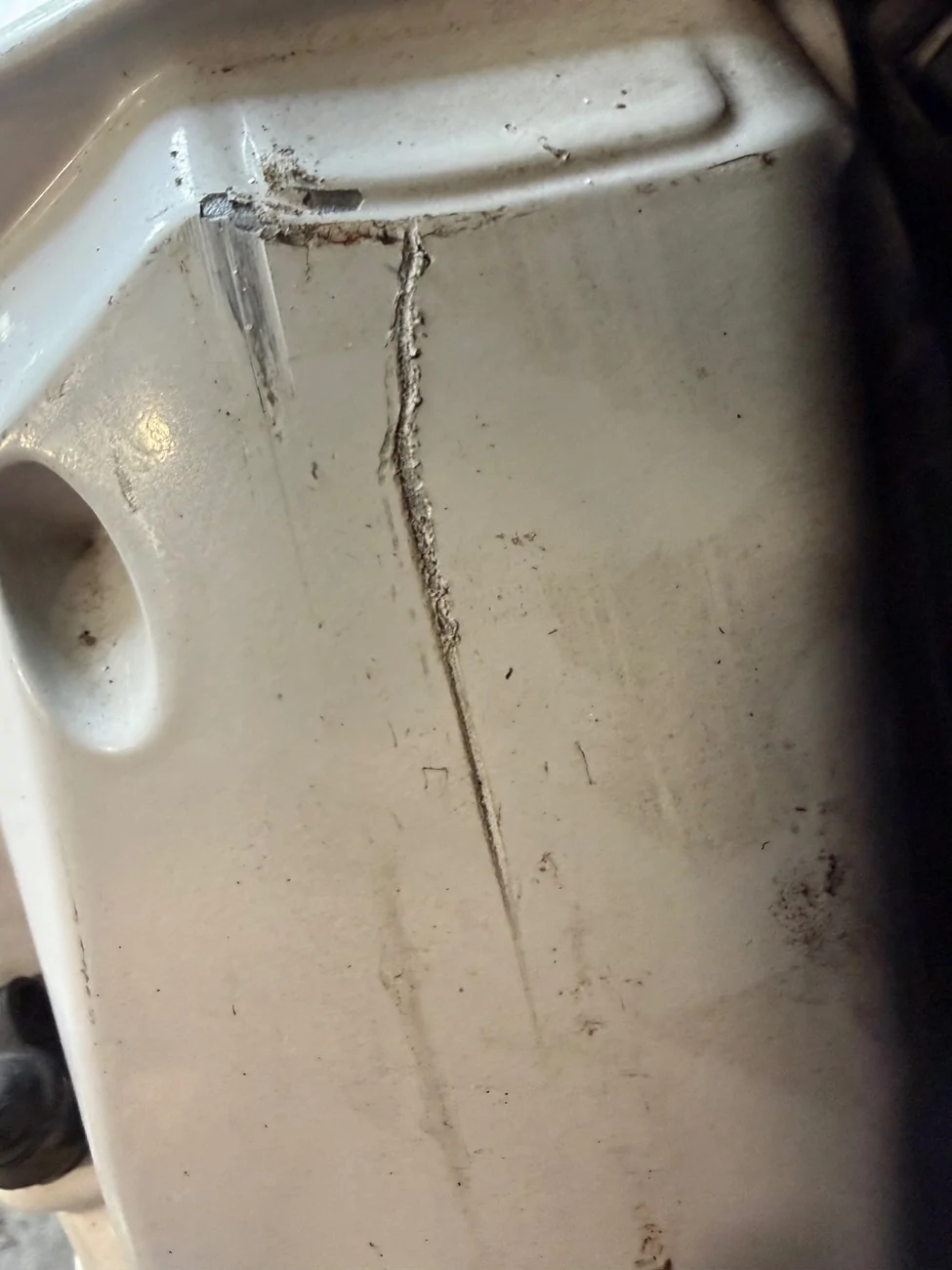

Changing tires and found a crack on my right front caliper. I bought the car out of warranty. How big of a deal is this?

If that's a crack, I'd imagine it would be spraying brake fluid. Seems like a nasty scratch. Maybe a stone got caught up in there for a while. Maybe matching damage on the inside of the rim?

Deep scratch and cracked paint, nothing major. I would definitely check the rim, it might look worse if indeed something got cought inbetween.

From the pics it doesnt look deep at all only cosmetic, these calipers have a lot of material to help with heat dissipation. Looks like some road debris got flung inside the wheel while driving since it follows the direction of rotation.
As someone else noted check the wheel as well and see how deep the gouge is there.

I'm very curious how the inside of the wheel looks like...
Unless the wheel has been refurbished it must have left a huge scratch.
