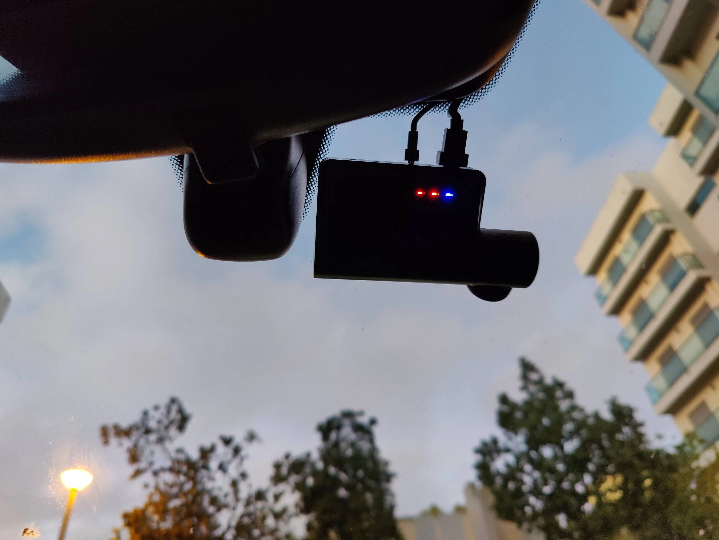

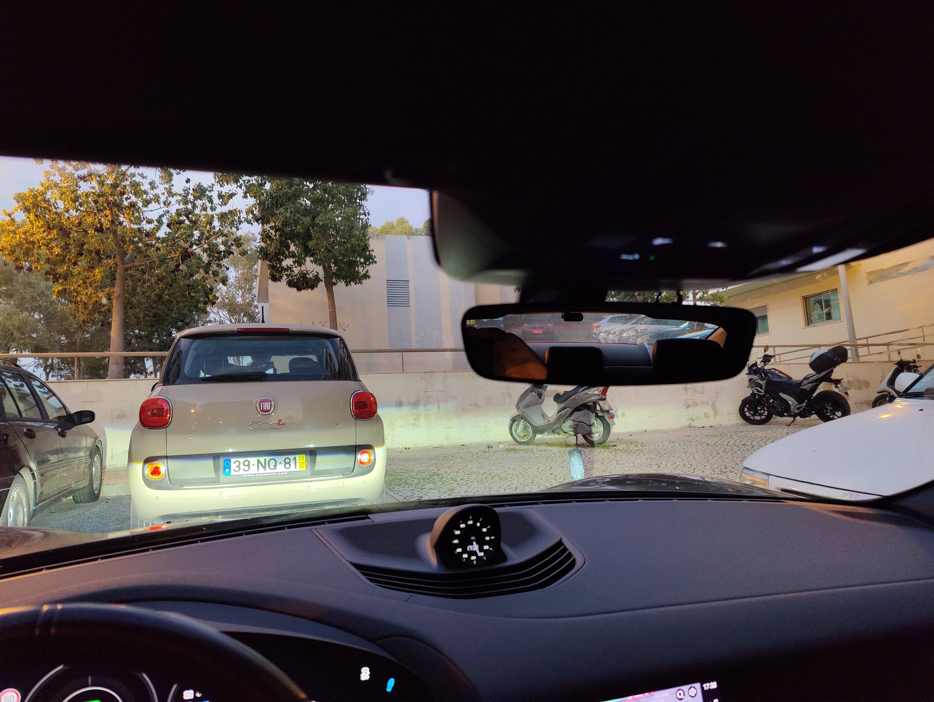

@tchavei any chance you could share a picture how you positioned your camera in a LHD car? I just ordered mine and especially wondering how to put cabling behind the rear view mirror (assuming camera is on the right side and fuse box is on left side of the car).
Sure. I'm not home right now but will take a couple of pictures tomorrow.
Sorry. Forgot the pics. It's a bit late rn but I took a couple. Lemme know if you need more details.
Porsche Taycan [Dashcam] Viofo A139 Pro 1/2/3CH HDR IMG20240102173828
Porsche Taycan [Dashcam] Viofo A139 Pro 1/2/3CH HDR IMG20240102173835

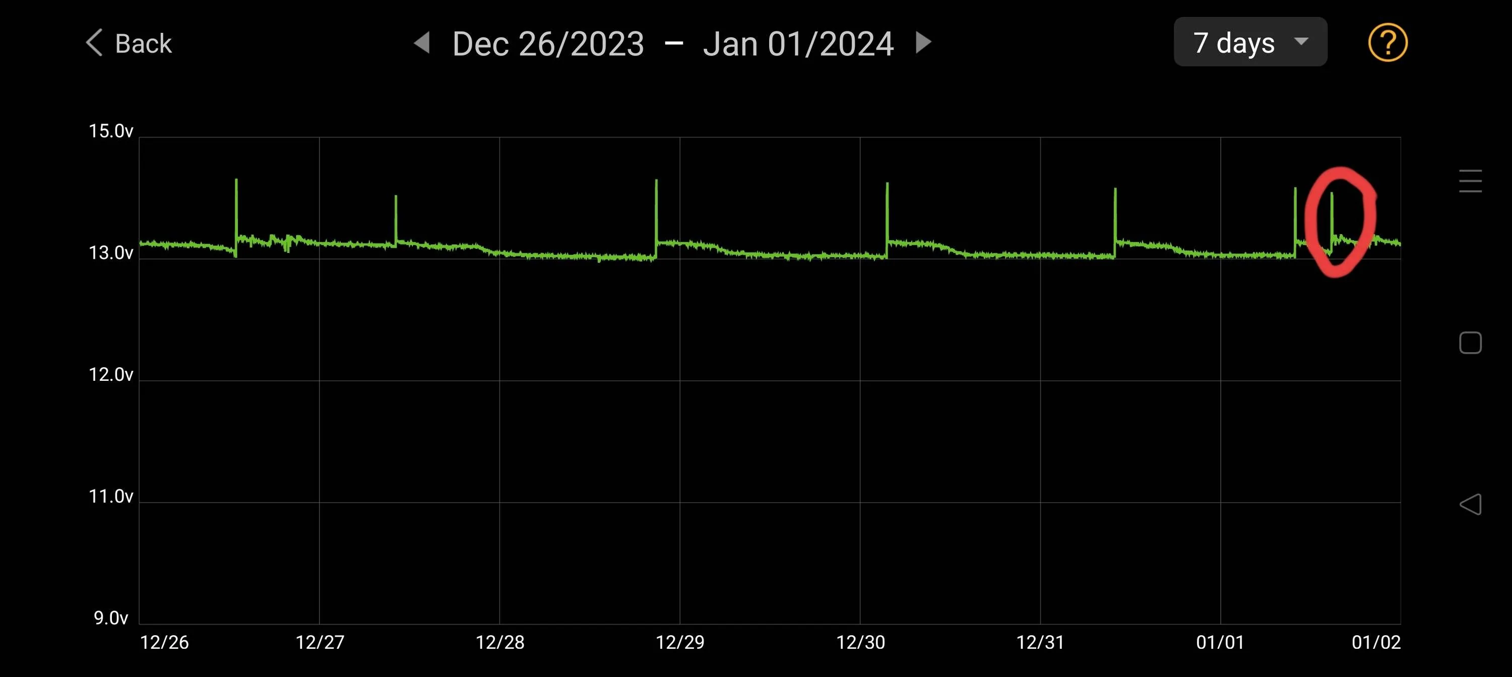

BTW, in case someone wonders how the 12v battery held during my absence, here's the graph. The red circle marks when I returned and started the car (to make sure it would power on). Overall it seems the internal battery protection system kicked in almost once a day whenever the battery voltage dropped to 13.01V and the 30 min charging put it to around 13.29V.
I really hope that some software update has removed the 6x recharge limit but I couldn't test that since apparently the car had completed the 6th cycle by the time I returned.
Porsche Taycan [Dashcam] Viofo A139 Pro 1/2/3CH HDR Screenshot_2024-01-02-21-05-48-65_50dec7016723fbfaf1a0791a16168120
