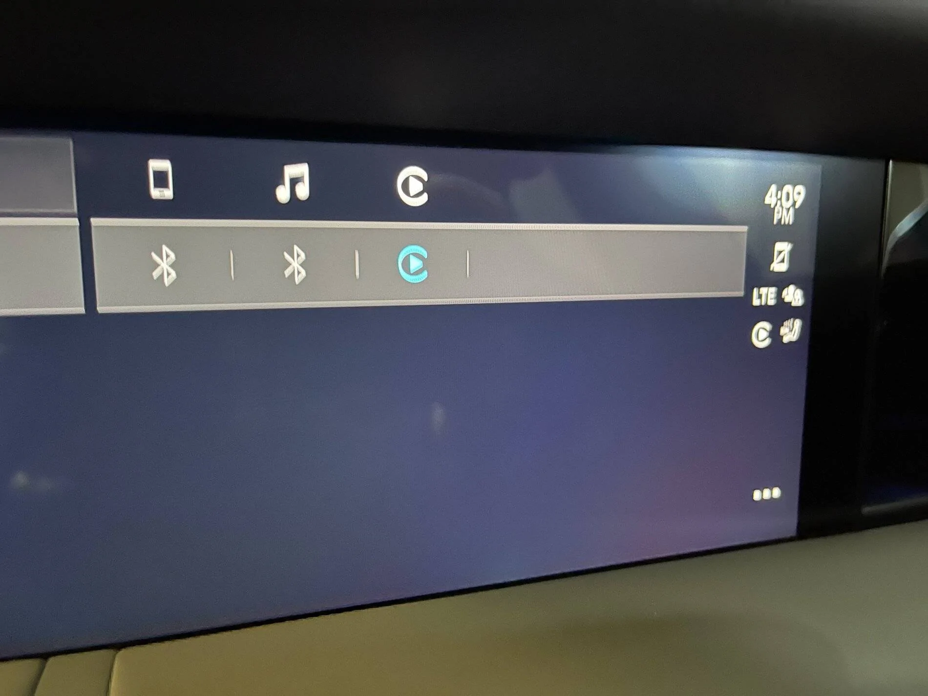

How did you end up making your wireless carplay work? I have a 2021 that I just picked up as well in the US. When I check my phone's CarPlay, it recognizes my car but my car doesn't show that anything is connected via bluetooth (second pic). Thoughts?
I read that wireless CarPlay requires more bandwidth than Bluetooth allows, so your iPhone must be connected to the Taycan by WiFi for wireless CarPlay to work. I'll update this post if I find the reference.
Update:
@Tay Tay said, "Both wifi and bluetooth are bidirectional communication protocols. Wifi has greater bandwidth so is required for things that are more data intensive (like wireless Apple Carplay)." https://www.taycanforum.com/forum/threads/what-is-the-pcm-hotspot-for-anyway.2200/post-30554
Also, from the Porsche Connect Good to Know manual: "When Apple CarPlay is used, any active Bluetooth® connections (e.g. for telephony, media playback or news) are automatically disconnected."

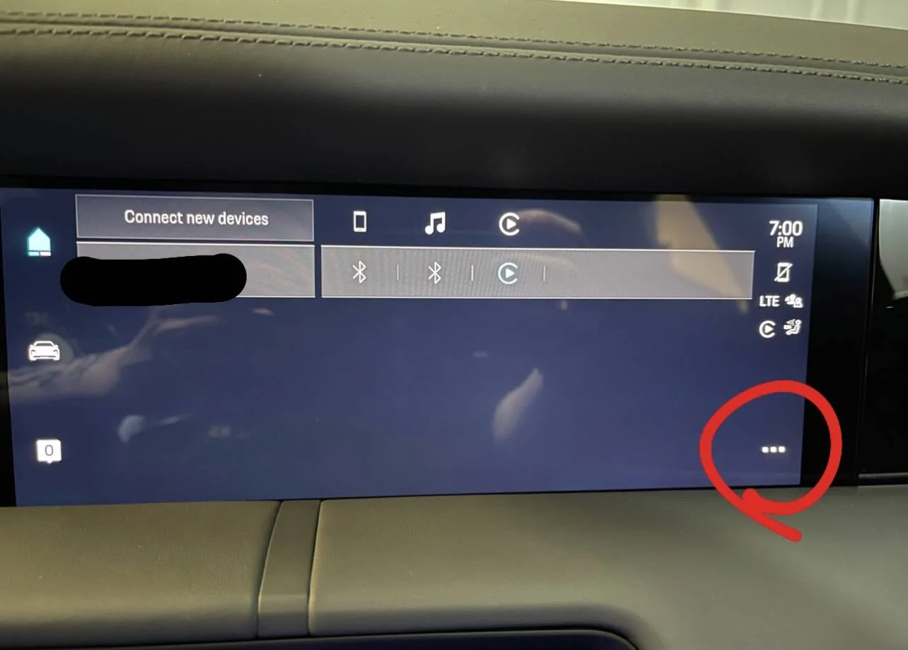

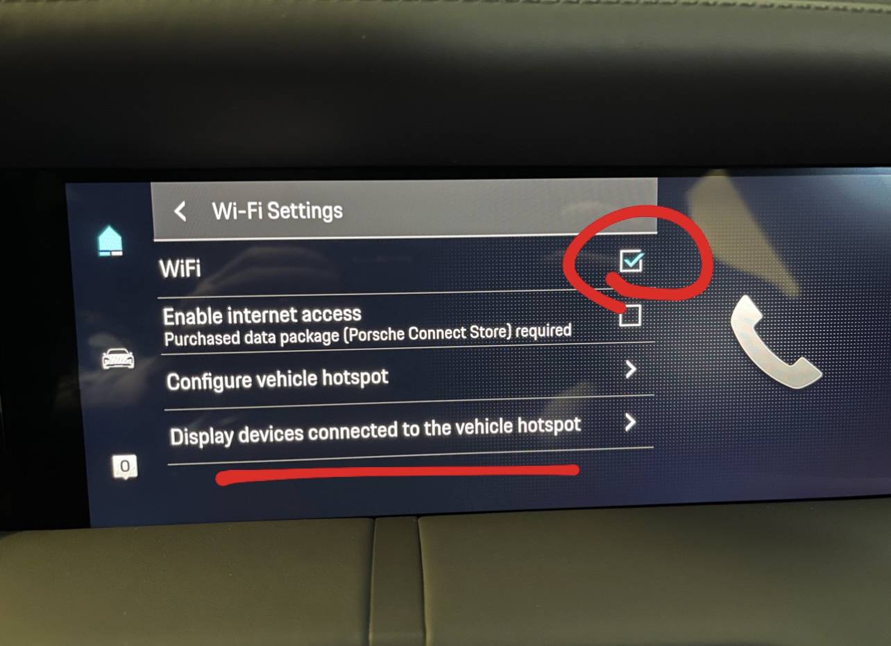

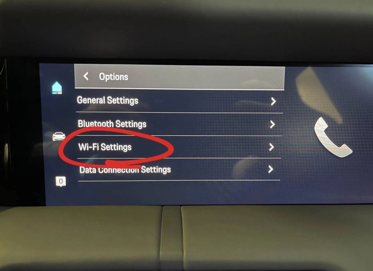

Awesome, that tip actually did the trick! When I was setting up my PCM the first time, I wasn't able to activate the WIFI and so I just skipped that step. I went back this time and dug around until I found the vehicle's WIFI settings (Home > Devices > the three little ellipses shown below) and checked the WIFI box to "on" in the car, and it activated wireless CarPlay right away. And as you said and seen below, everything goes through the WIFI connection unstead of bluetooth.
Thanks!

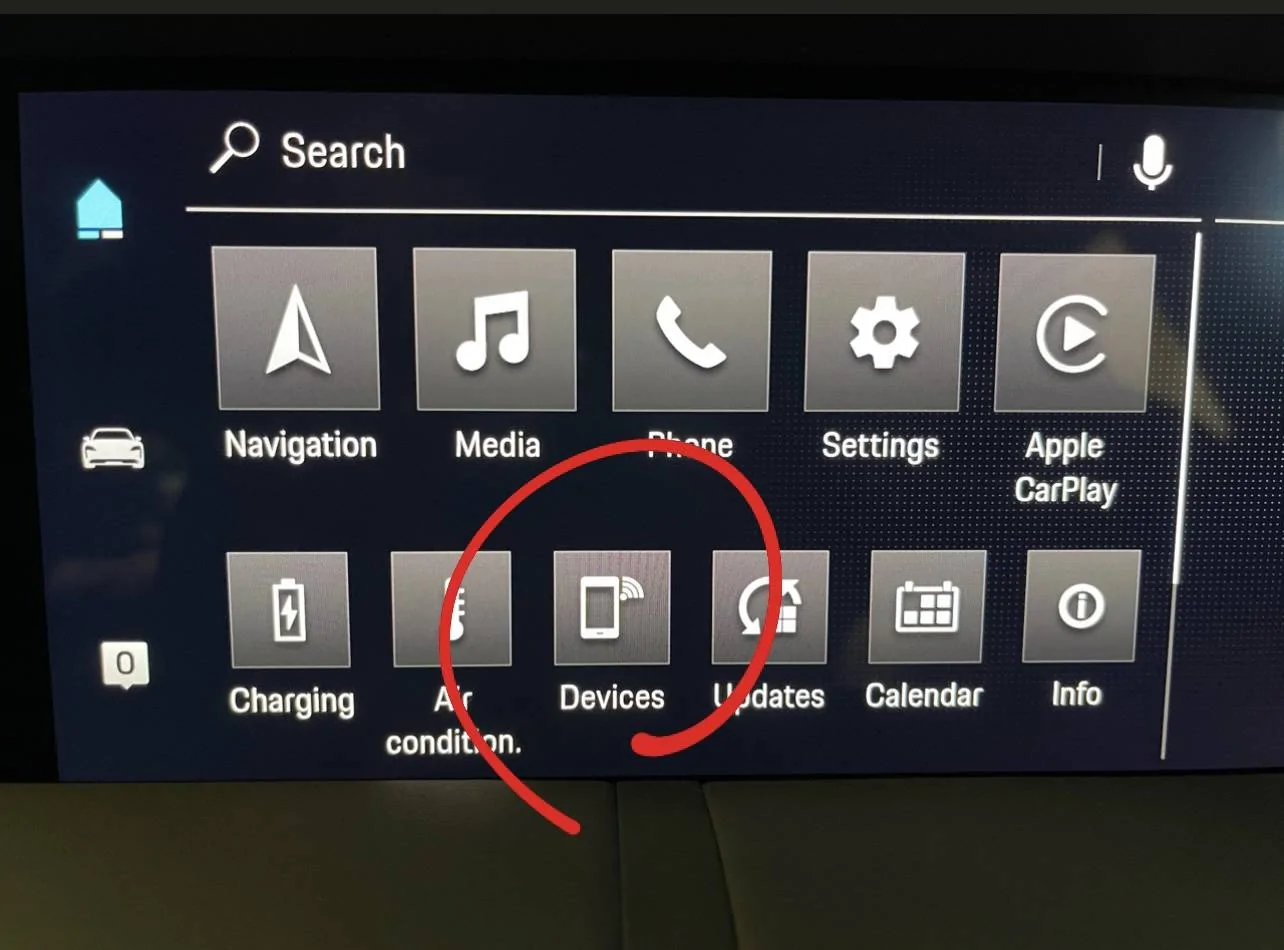

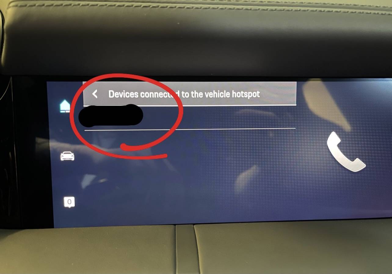

Hope the below images help to guide you to where the wifi settings are. Once you check the wifi box to turn the Taycan's wifi hotspot on, go into your phone's wifi settings to find your car and connect to it. If it connects successfully, you should see your device listed. Then you can go into your phone's carplay settings and see your car there too.
Once you're connected, go back to your device's menu (the second picture) and click on the carplay icon. Alternatively, you sould have a carplay icon on the main menu like I do too (first picture).
