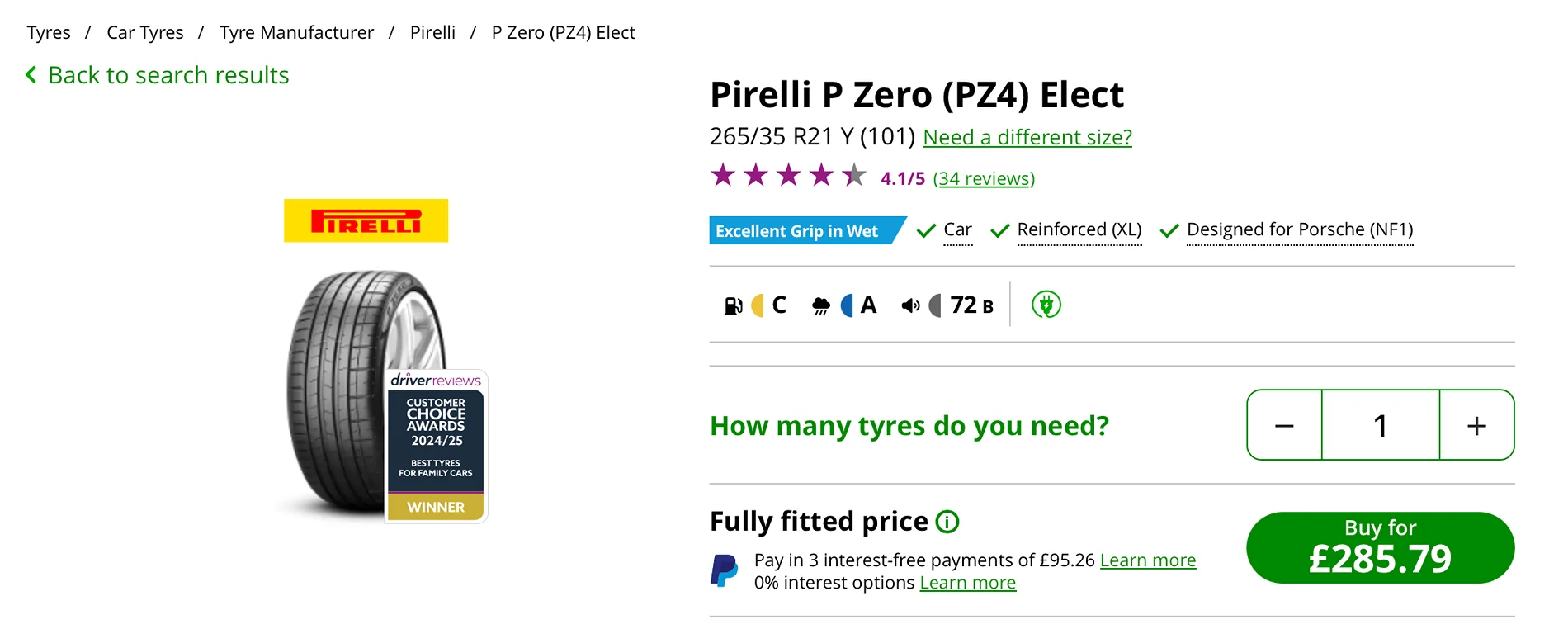

Currently have the PZ4 Elect NF0 on my ST GTS, need new front tyres after approx 10k miles on the front and have noticed that the 265/35/21 NF0 I currently have are now available in NF1 (that seem substantially cheaper) assuming these are just the newer version of the NF0 and will be fine?

Correct: NF1 is a newer version of NF0.

I think I must be searching incorrectly - every NF compliant tyre I can find is still NF0 - No NF1s show up - the term NF1 gets not results.. - Has anyone a link to an NF1 Taycan tyre (preferably R20) - cheers
