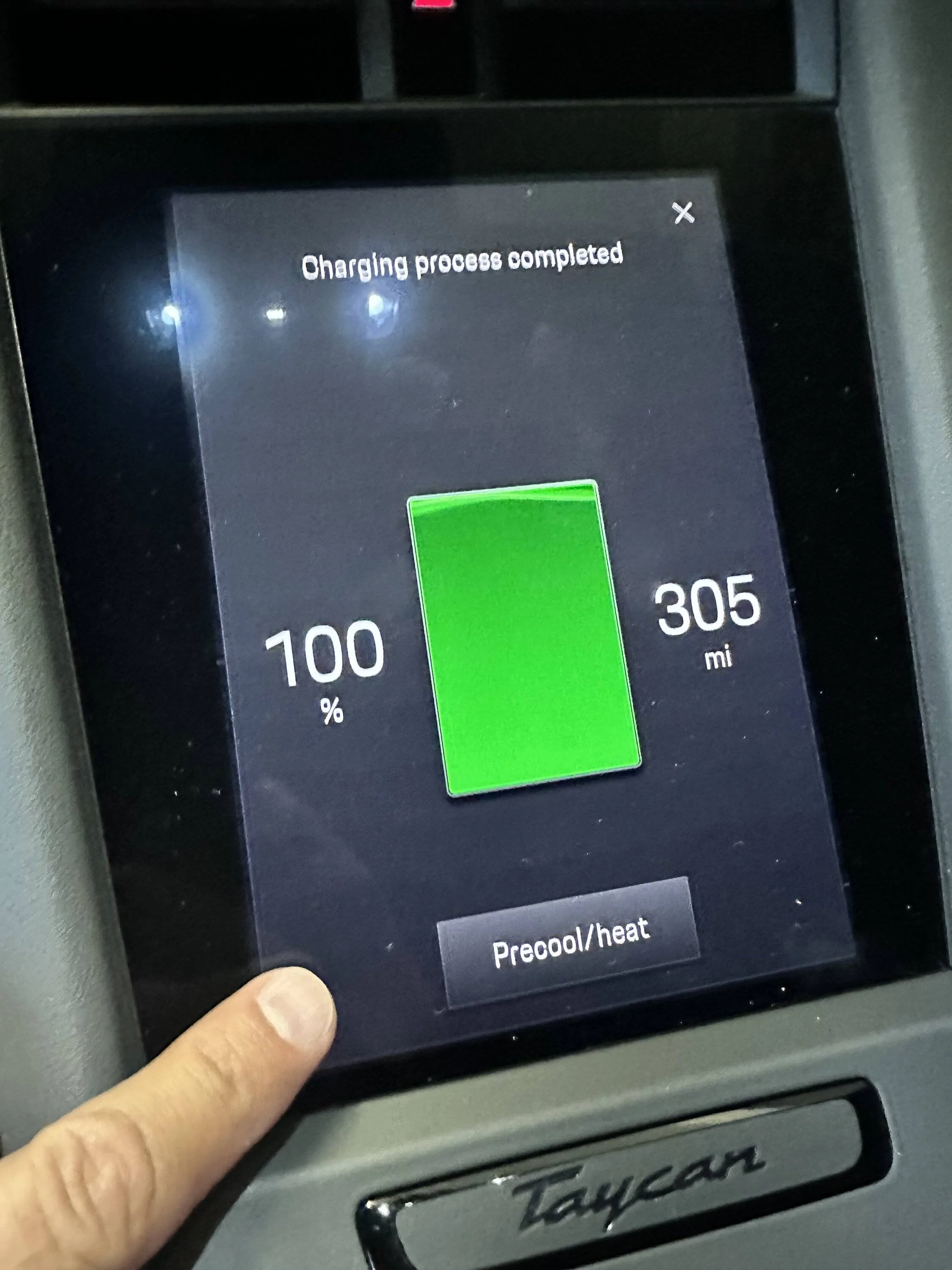

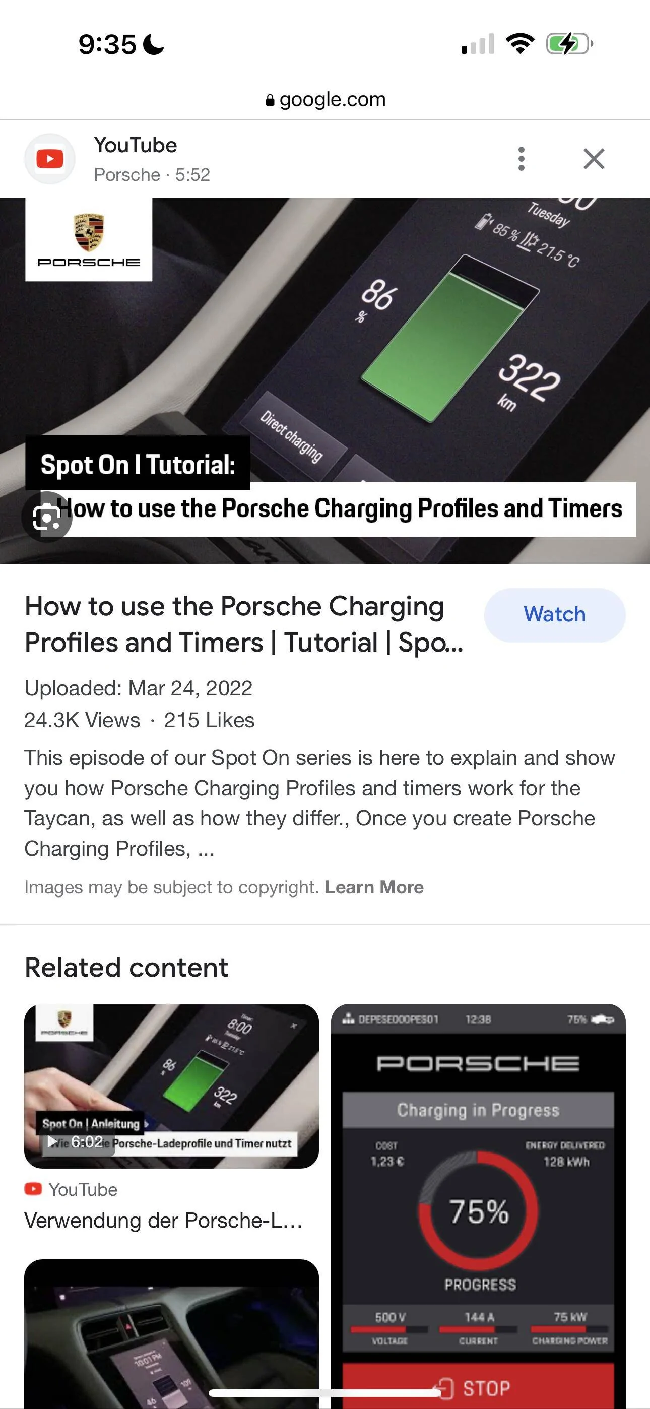

Took the Taycan for service and last week. Reflashed system. Also did the new OTA update. Now the direct charging option is missing on the console screen. Car is charging to max battery. How do I adjust so it’s not charging all the way?
Read this post https://www.taycanforum.com/forum/threads/charge-over-the-80-i-setup.10298/#post-148575
If you set a general profile, say to 85%, then you will see the direct charge option again.
PCM...home...charge....profiles.....general charging profile checkbox checked....85%
Use the PCM or APP to configure / enable charging profile and / or timer(s).
The display will sort itself out in time.
