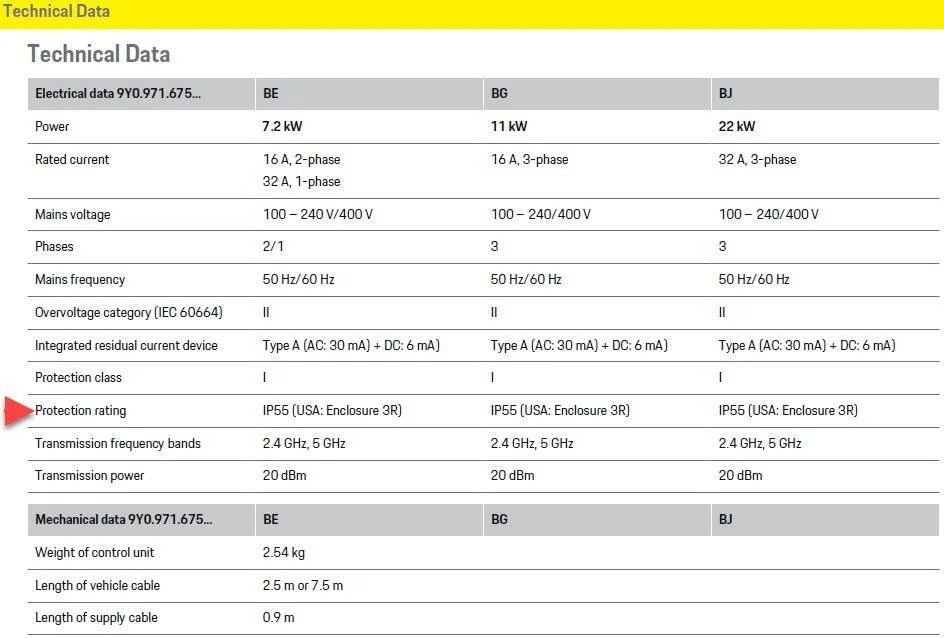

It is not IP65 rated - IP55 only (so weather proof to a degree)
Apologies - should have double checked!
The last digit is water so at least that's the same. And if wall mounting I imagine water is the bigger deal.

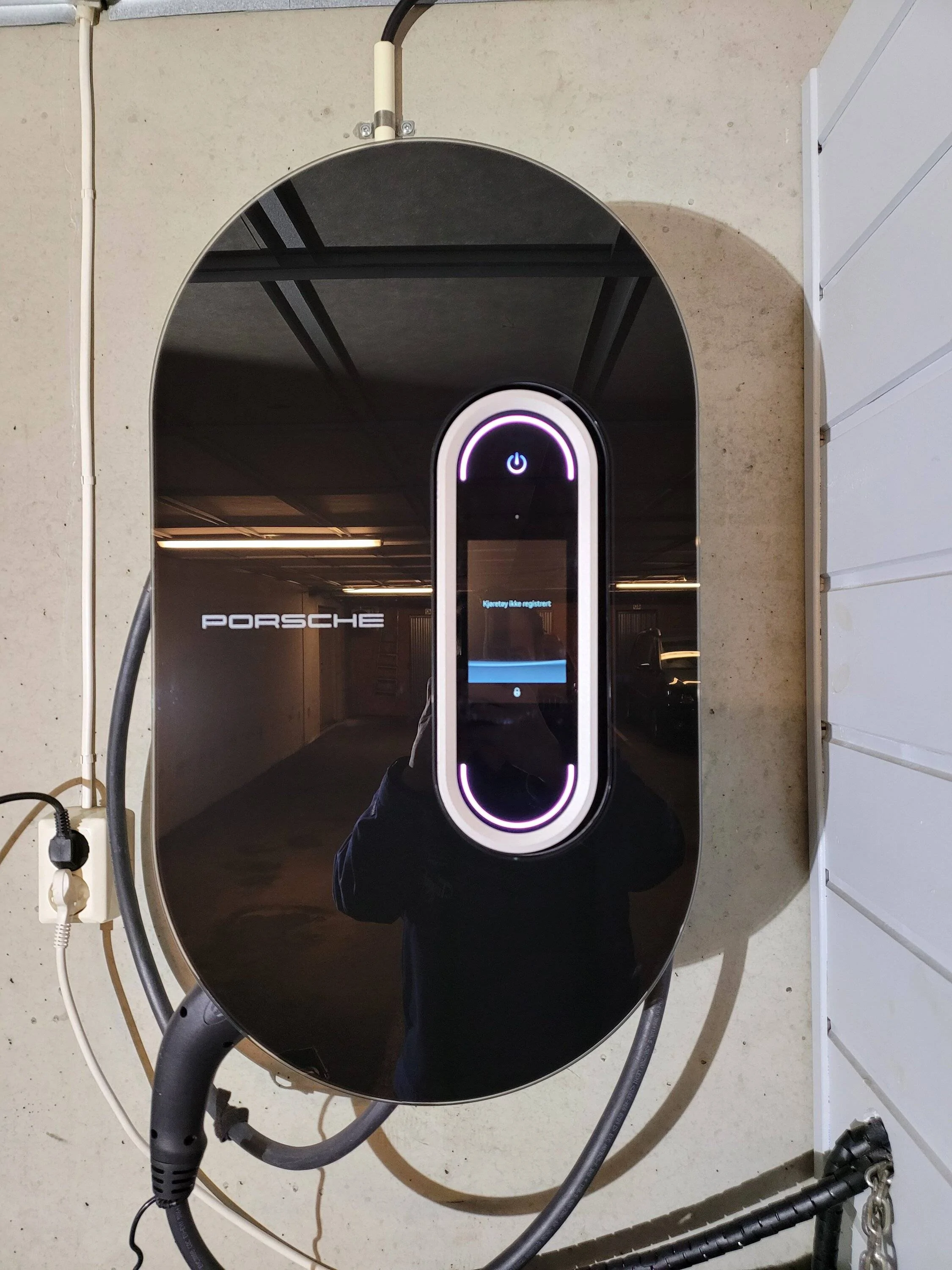

New to EV’s so bear with me. I pick up my Taycan soon but getting confused charger wise. It comes with mobile charger connect. I’ll be charging at home 99% of the time. Do I need a different charger too? Also, is the mobile charger connect waterproof as would be installed outside.
No. You don`t.
I use the supplied charger 99% of the time (400Vac and 16A).
