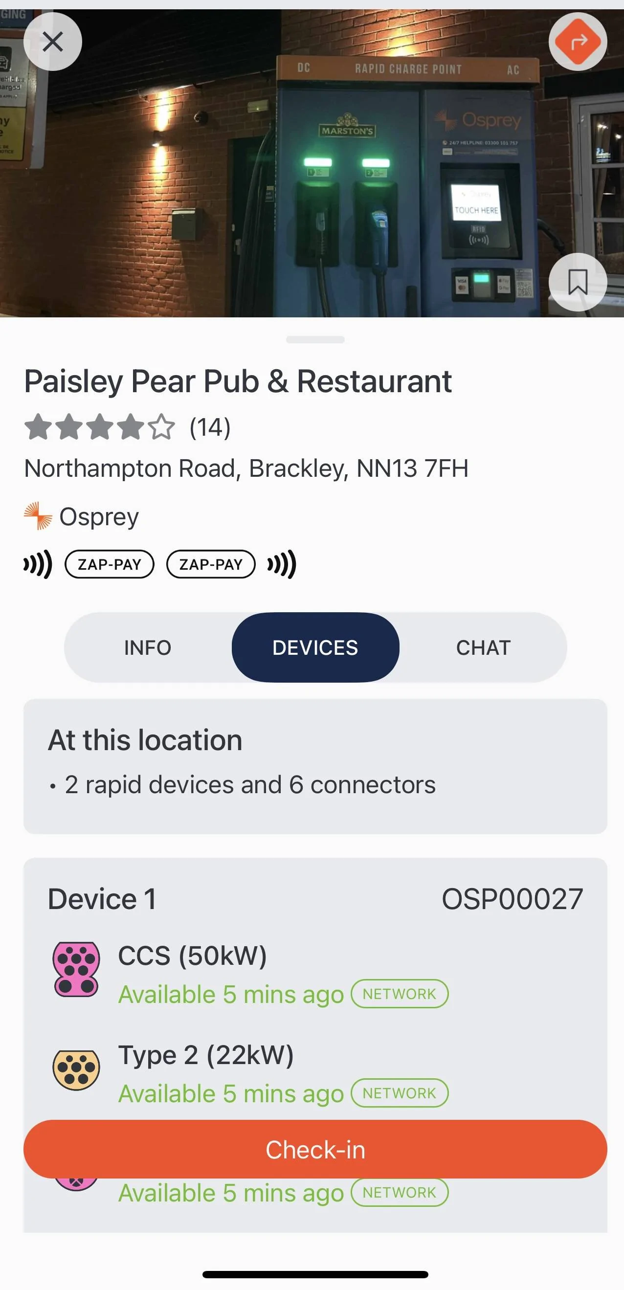

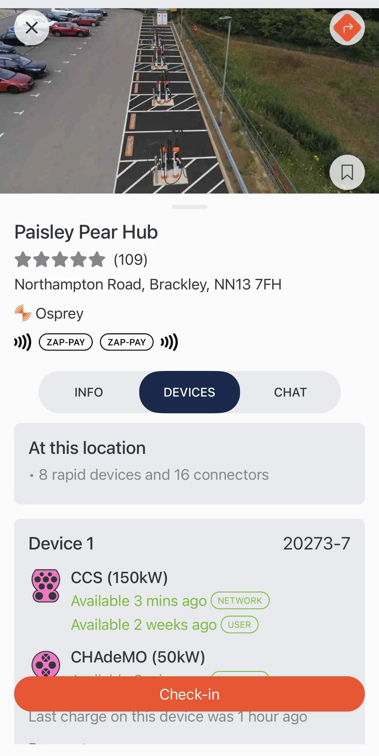

Sorry if silly question but any idea to find out what the site is before heading there?
Zap-Map is usually a decent guide for all charge point operators. Often folks will post photos etc there and commentary on the chargers.
For example…
- at the pub, they’re Circontrol charge points.
Porsche Taycan Do I need another charger ? IMG_0509
- at the Osprey hub over the way, they’re Kempower:
Porsche Taycan Do I need another charger ? IMG_0508

Thank you. So my card should have worked then.
I’ll give Porsche a call tomorrow.
