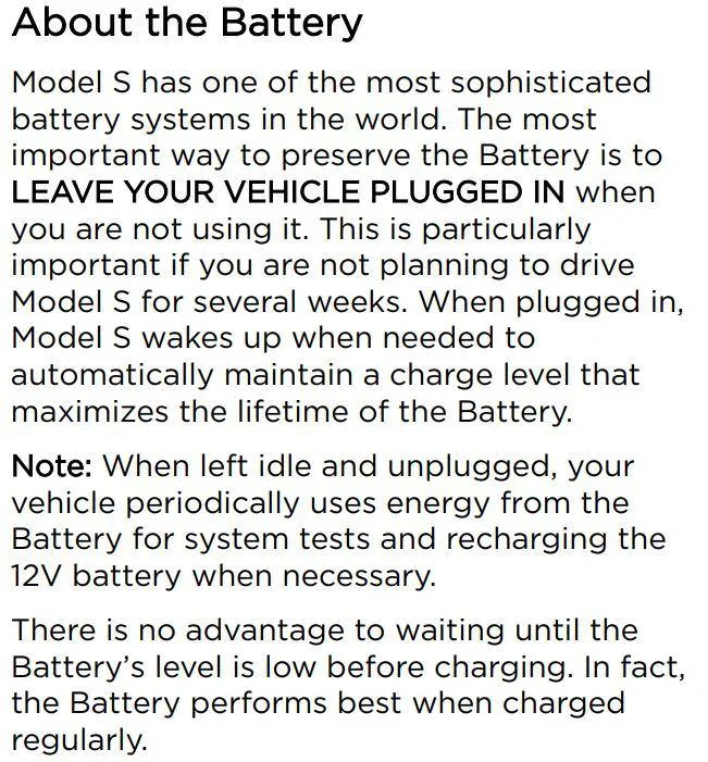

I own a Tesla as well. The section of the manual you showed doesn’t refer to the recommended state of charge. It refers to always keeping connected to a power source so that the battery pack can be kept at an optimum temperature. It’s saying “let the car‘s computer manage battery state of charge and temperature”. Which I think is spot on.
The technical answer is that a lithium ion battery pack has a limited number of deep charge cycles. Going from 80% to 20% will lengthen a batteries life. Going from 100% to 0% will shorten a batteries life. Fast DC charging can also damage a battery due to over shoot. That’s why DC chargers slow down once the battery has hit an 80% charge. In the early days of the Tesla Roadster, you could kill the battery in a few years by using the original Tesla DC chargers which didn’t lower the charge rate at 80% charge.
Over time engineers and scientists found ways to maximize battery life which is why we have the recommendation “charge to 80% for daily driving, charge to 100% if needed for a trip, keep your car plugged in when possible”.
