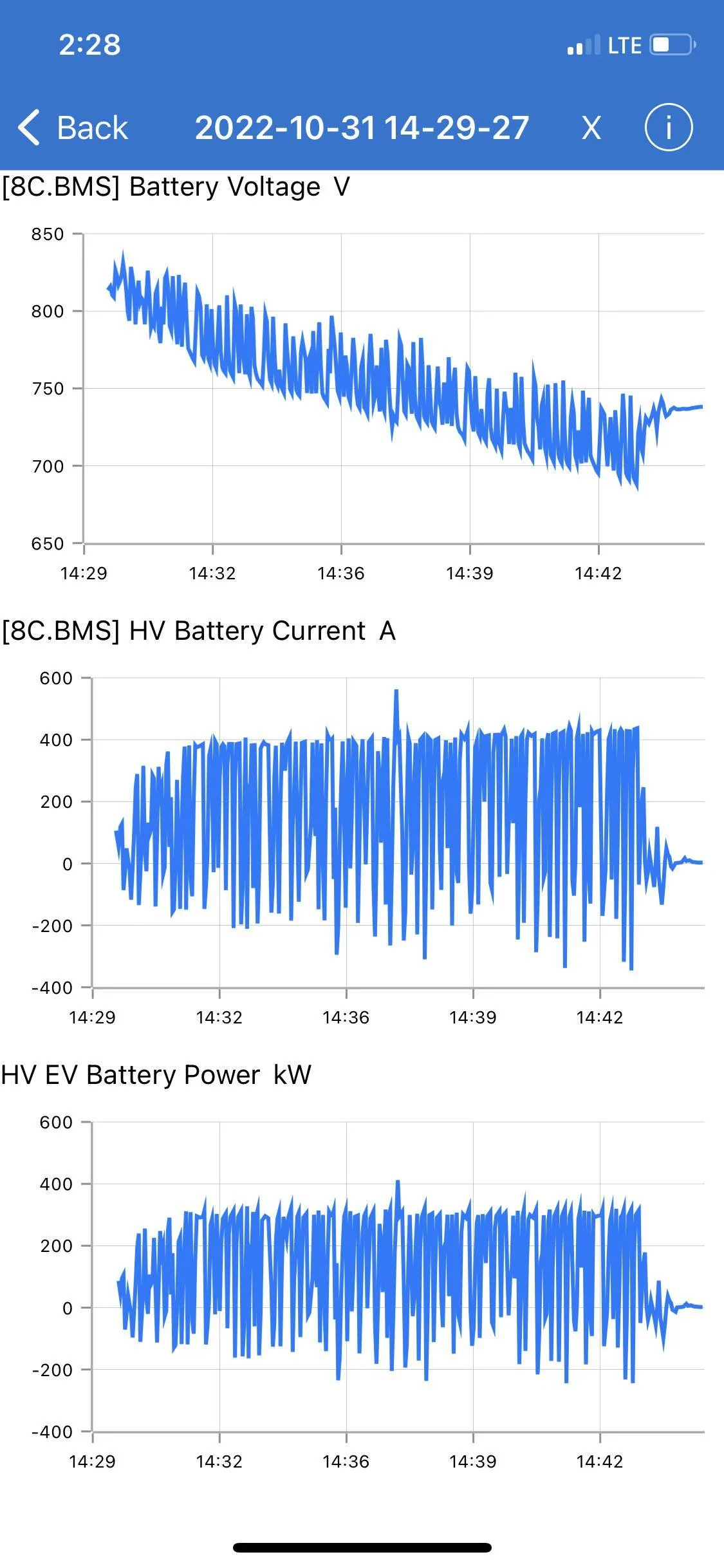

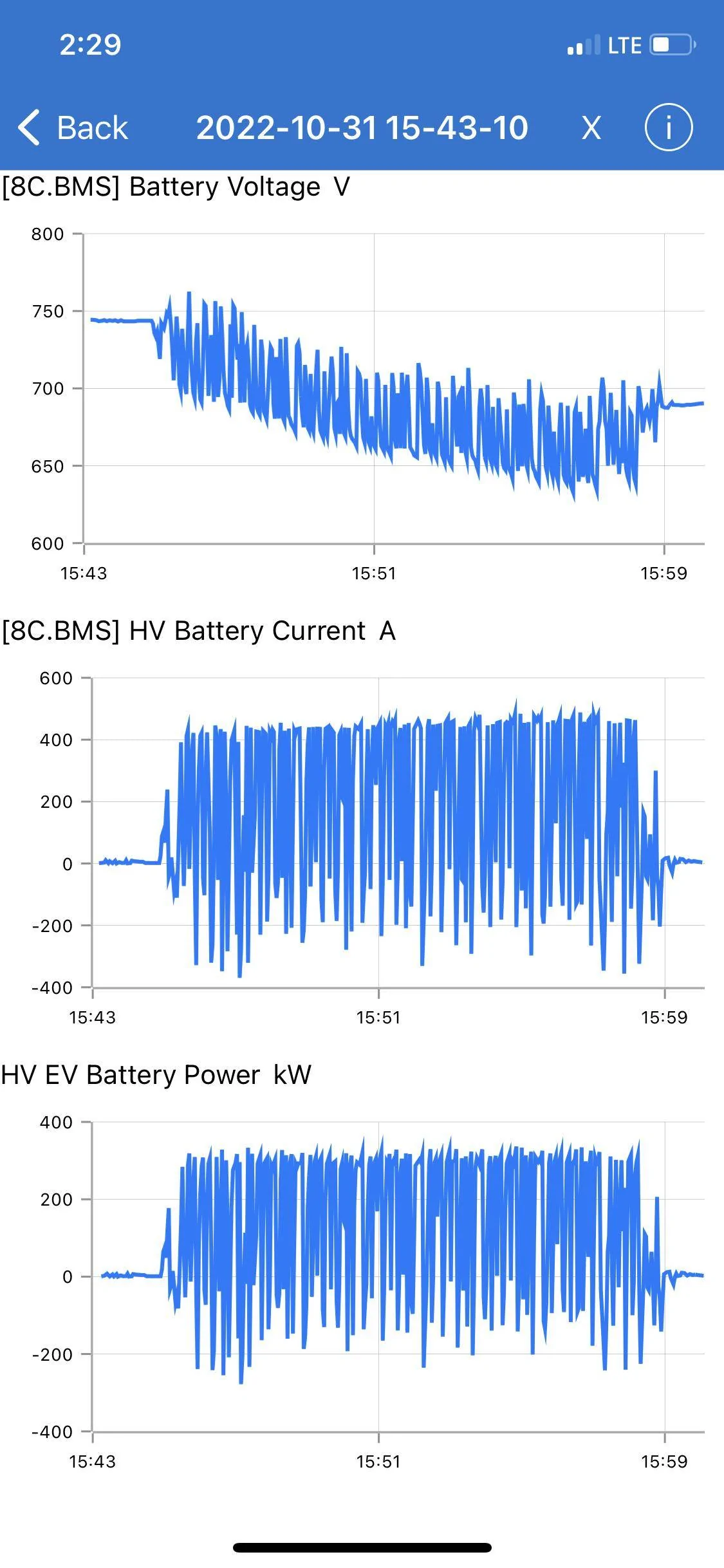

Every EV loses power to some degree as SOC drops.
Some mask the power drop better than others, but physics dictates that power will eventually drop as the battery voltage drops.
My 4 maintains power very deep into the battery. I think the lowest I've ran it on track is down to about 5% with zero loss (see pic below). But that's mainly because the power is already capped, while using the same components as other models.
It hasn't been pointed out yet, but the reason low SOC could result in power loss is because as the voltage drops, current needs to be increased to maintain the same power. Running higher currents is the main contributor to heat generation in the battery, invertor, and everything else in the power electronics. It could be that the higher output Taycan models actually have a cap in max current output.
A different issue is low temperature, which limits the available current the batteries can output. But the rest of the electronics are not limited in low temps.
Here's an example of how voltage drops and current increases to maintain the same power: (look at the peak values)
SOC from 95%-50%

SOC: 50%-10%
SOC from 95%-50%
SOC: 50%-10%
What you are showing is what I expected to be how the power is maintained. Maybe the GTS is closer to the upper limit and not able to provide the BHP as the voltage reduces. If that’s the case, Porsche should have mentioned it in the specifications.
