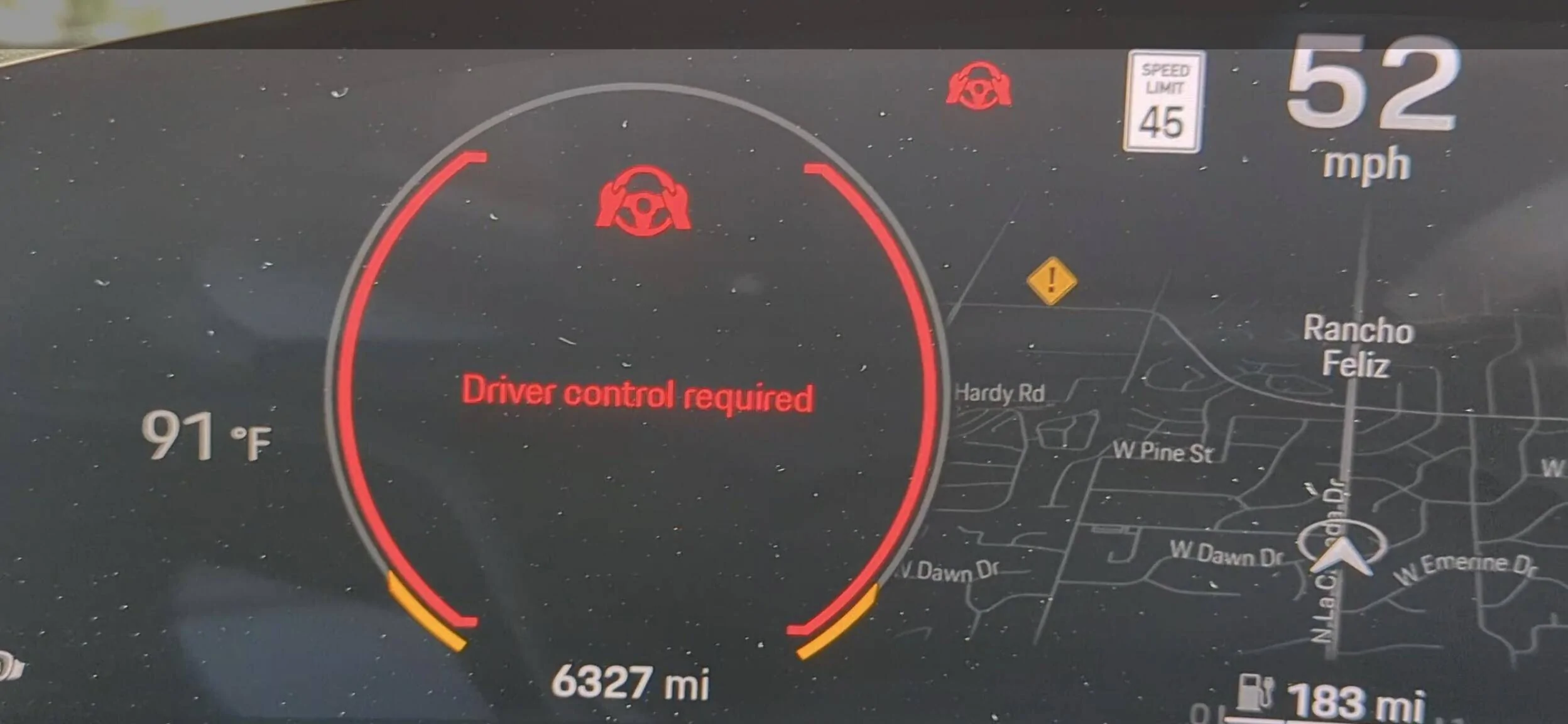

I just bought a preowned 2020 Taycan Turbo and I am getting the "Driver Control Required" warning along with gentle brake application. This is definitely because the car thinks you don't have your hands on the wheel. I have been able to replicate it both by not actually having my hands on the wheel and simply not providing any input with my hands on the wheel. I believe that on my model Taycan it is using a pressure or torque sensor on the steering wheel. I've tried just about every iteration of Driving mode with deactivation of most of the safety assistance options. The only one that seems to work is to completely disable PSM (long press until it says it is off), however, I have to do more testing to really confirm. I have been able to take a video of it happening. What really gets me is that there is no option to disable this. This happens several times a week on my daily commute to work. I have an appointment with the dealer on Aug. 5th. I really hope they can get a solution from Porsche, if not, I hope they can at least disable it. This is really frustrating to me and it is really souring the experience I am having with this car.
Here is the video: https://photos.app.goo.gl/KDkkoirkw3sCDnbv8
After you get that warning, if you continue to not provide input on the steering wheel, it then proceeds to aggressively tug on the seat belt to get your attention. I didn't go further than than for fear that it would slam on the brakes.
Porsche Taycan Driver Control Required message Screenshot_20220721-114253

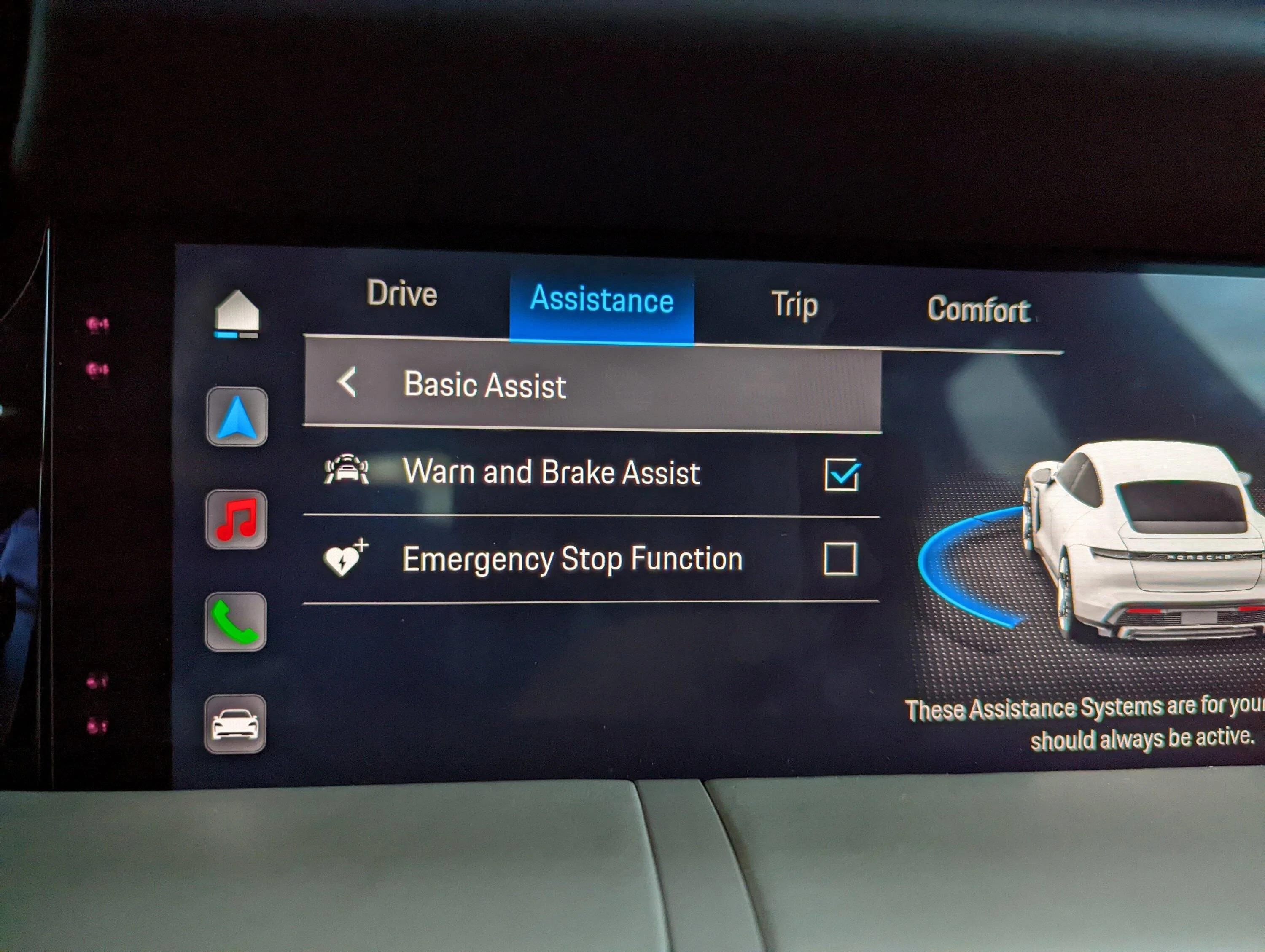

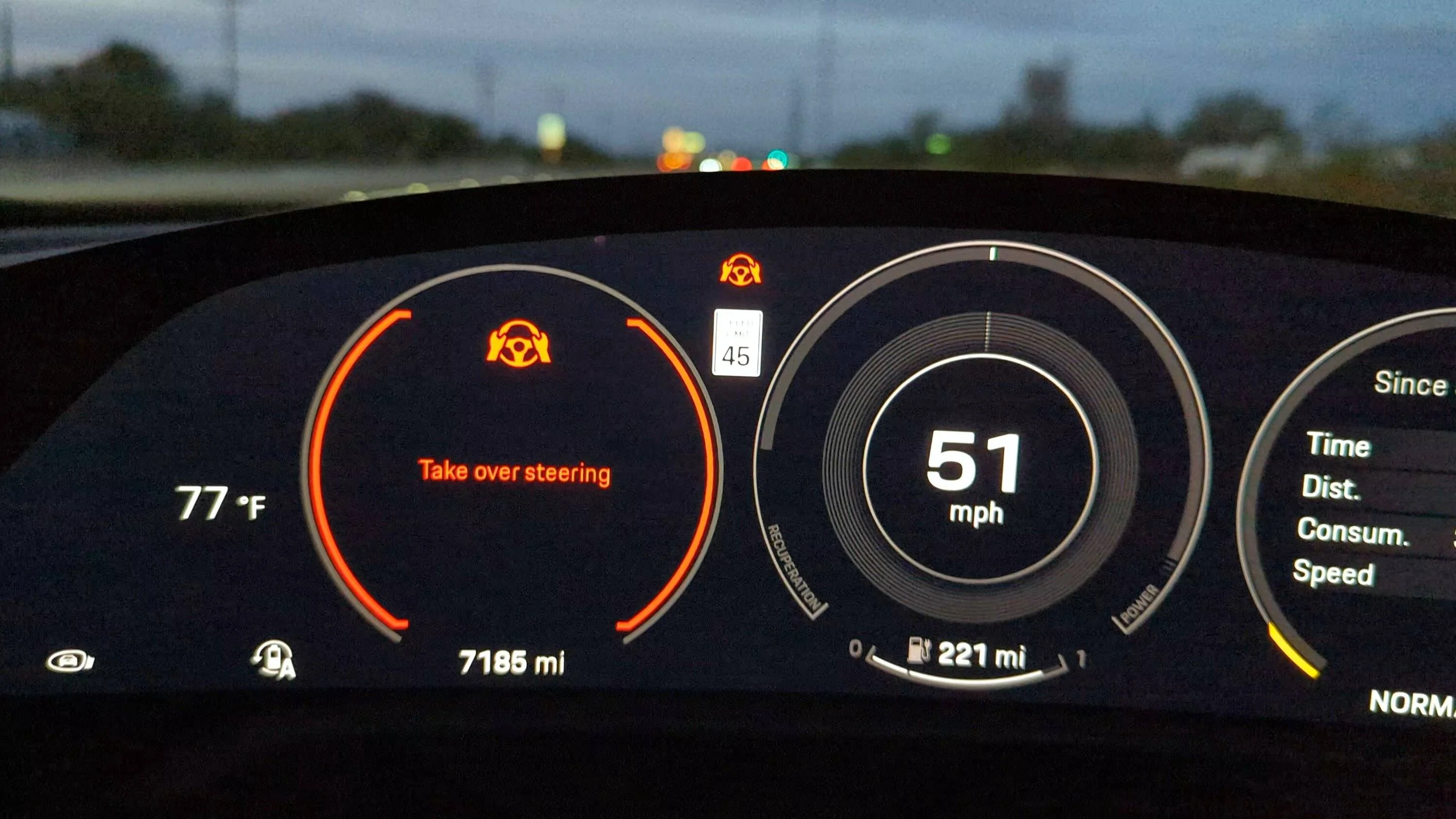

After getting the big update for 2023 on my 2020 Taycan Turbo it looks like the message has changed to "Take over steering".
Porsche Taycan Driver Control Required message PXL_20220822_123226069_exported_10912
And it appears that you can disable it by disabling the "Emergency Stop Function" from the Basic Assist menu. Previously I stated you had to disable both options from Basic Assist but after more testing it seems that you only need to disable the one.
Porsche Taycan Driver Control Required message PXL_20220822_130445774
Before the update that did not work to disable the warning. Previously, I had to completely disable PSM in order to disable the steering wheel warning.
This is the 2023 update I got on my car:
https://newsroom.porsche.com/en/202...ge-software-update-2023-model-year-29112.html
Overall, this is a small improvement since you don't have to completely disable PSM anymore. Unfortunately, you have to disable "Emergency Stop Function" every time you get in the car because it resets to being enabled after you turn off the car.
