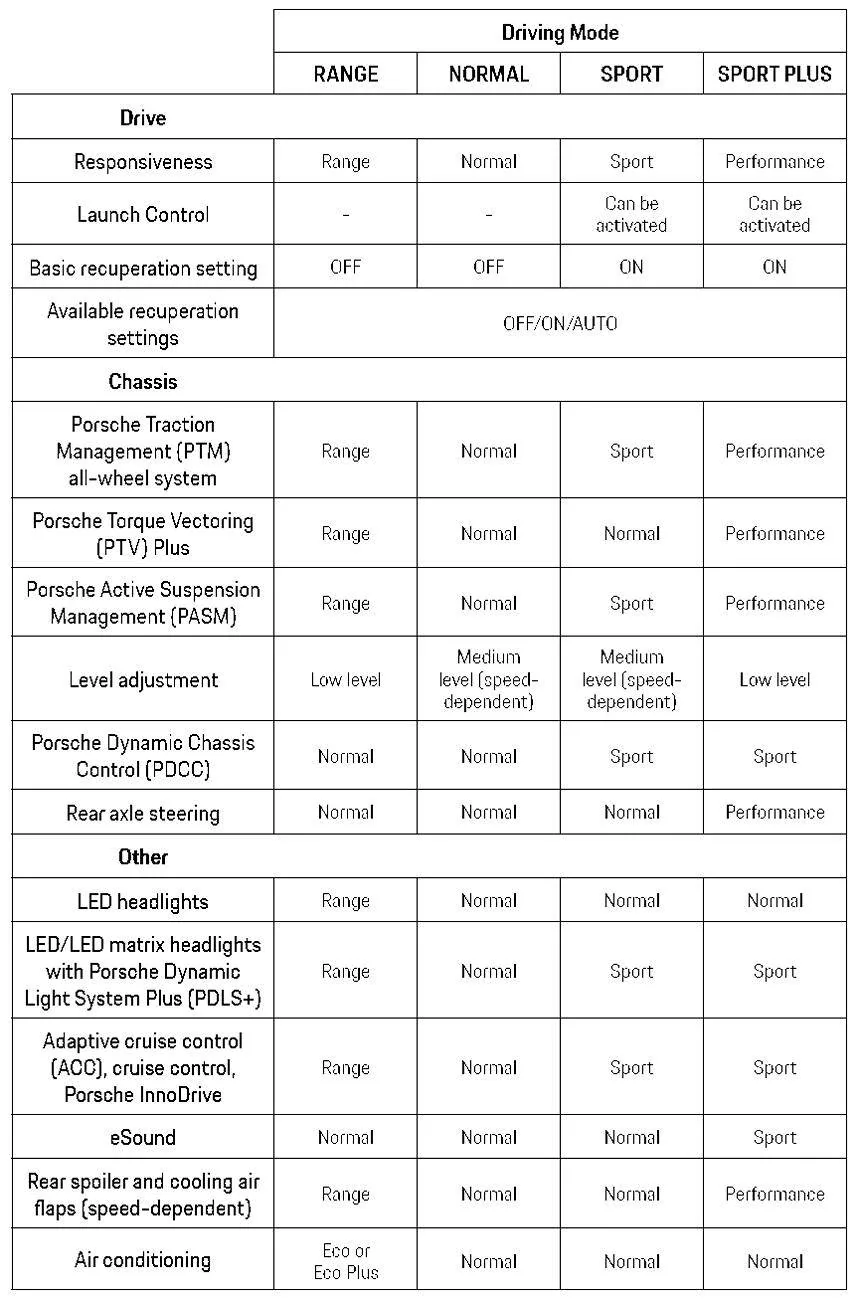

Hiya,
Just wondering, outside of Range mode where it apparently only uses rear wheel motors (?) is there any actual difference between normal/sport/sport+ or are they all just predefined chassis/suspension/sport-sound etc which you can edit in the menus anyway?
Also , what is the point in being able to change those settings within the car menu for the different modes, when they don't save those settings, only individual saves?
Yea there is a difference…especially if your car has the performance related options ticked. The car can range from GT cruiser to a fairly high strung track toy with various settings in between.

the chart is interesting to show the different variables influenced by the drive modes, but too bad it didn't come down with a brief description --- like for rear axle steering, what's different about 'normal' vs 'performance'
that's great. thanks. only just need to know what normal sport range and performance actually means lol
From what I can remember reading from various tech articles, range mode either takes away power from certain components, or sets them as to achieve the greatest efficiency and/or allows for least amount of drag.
For example...
PDLS+
Range: Your lights are handicapped. Lowered brightness, less beam control if any at all. Not entirely sure but high beam assist might also be disabled
Sport: Light intensity, range, and swivel (beam direction/shaping for matrix) are increased and more affected by speed and steering angle.
PASM
I'm going to assume compression and rebound are dialed way back, and are passive instead of active. There's a reason why you can't change your chassis settings in range mode, because I assume there's more to PASM range mode than just setting ride height to low.
