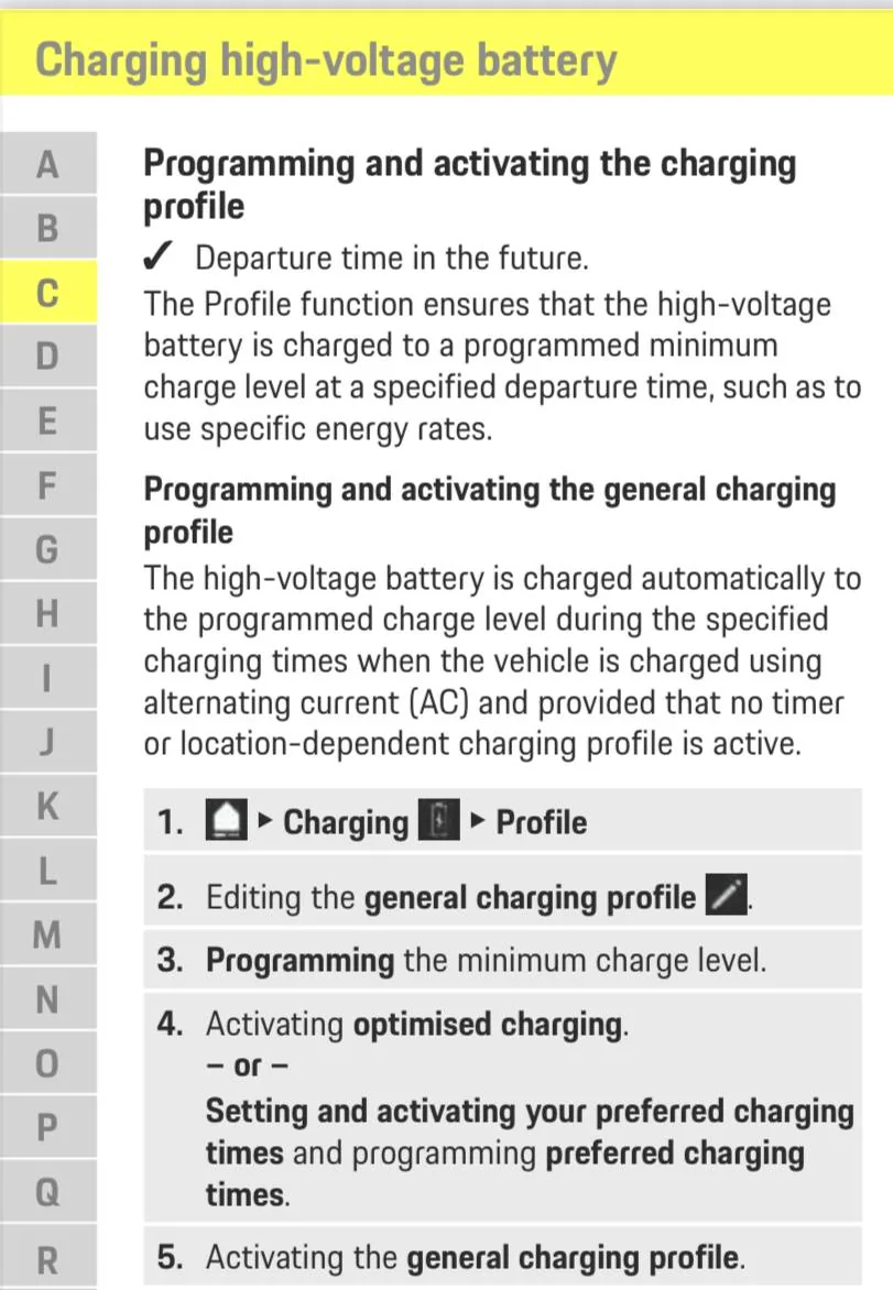

Pozuelo
Roberto
Feb 14, 2020
94
689
952
Madrid, Spain
  • Ensure "Optimized charging" is NOT checked
I don’t understand why, because it refers to AC charging… Mine always charges at full power with it marked, except on rare occasions when a charger might have issues. I just try another one if it is available.
Porsche Taycan EA charging 87097537-10F5-4052-84BD-D49CF1591610
193
7,036
10,533
optimized charging only effects fast dc charging - not L2 AC charging which maxes out at 19.2 kw in north america - 19.2 kw is not much of a load on a 93 kwh battery
fast dc charging maxes out at 270 kw and optimized charging limits that to 200 kw to place less charging load on the battery to improve battery longevity
fast dc charging also ignore any charging schedules
