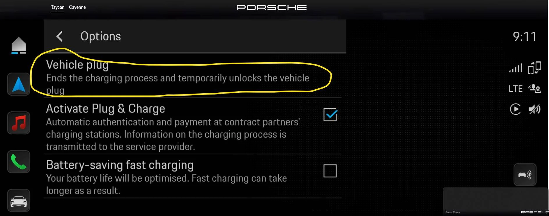

Tips to try before pulling lanyard. (I learned these from personal experience.)
1. Take your key fob and repeatedly press "unlock". More than once. No matter if you know the doors are unlocked.
If charge port believes car is locked, the plug release is locked and the port will not release the plug.
2. Use the PCM to stop charging:
PCM > charging > . . . > vehicle plug.
This only works if car believes charging process is still active. See pic below. If this works to stop charging, remove the plug quickly. Limited time after this step for plug release.
3. Do the 15 minute "reset". Turn off the car, exit it, lock doors, and take all key fobs out of range of the car for 15 minutes.
On sunny days it is hard to see the white light shining down on the plug that indicates the plug may be removed. You have to shade the port to see the light.
Porsche Taycan EA Charging Plug Fails to Release 1711306702135-ee
Re to your question has anyone else experienced this? See this thread, one of many.
