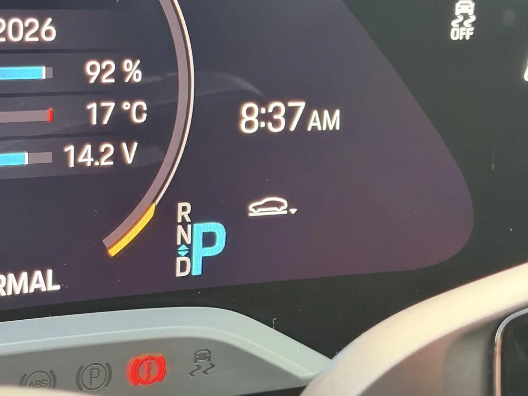

Look for this on the dash when you're on the highway:
Porsche Taycan Enable Low chassis option via PIWIS 1775520314880-gq
I didn't notice it was missing for a few days and now that I know I must have it :D
In Sport Plus it shows even lower with 2 arrows pointing down.

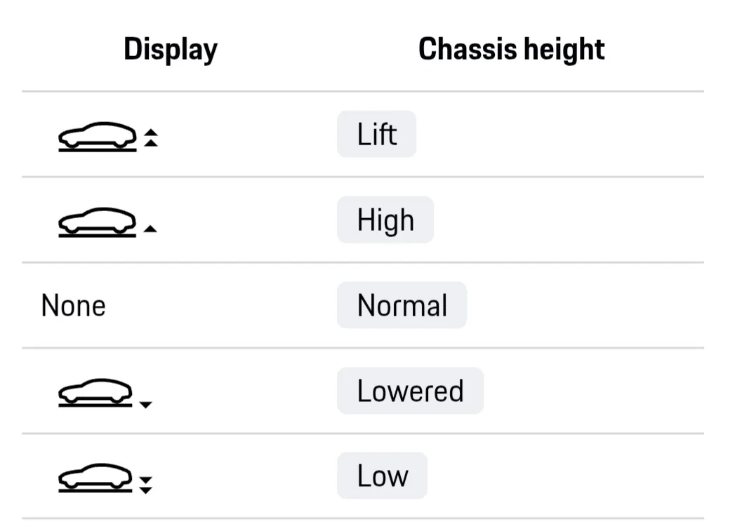

Not sure but probably.
All chassis level modes are listed below:
Curious to know what the Australian Owner's Manaul lists as available heights?

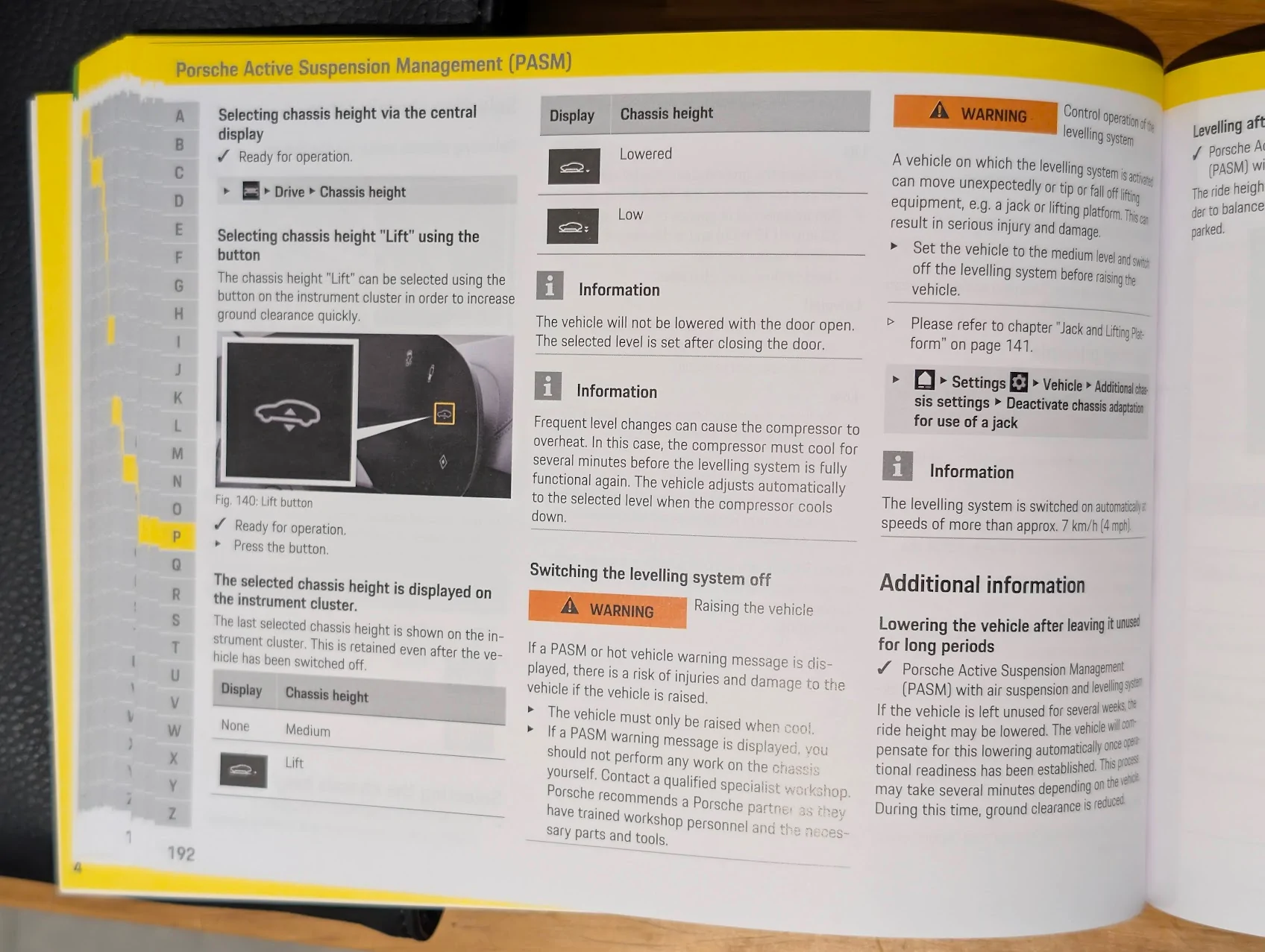

Porsche Taycan Enable Low chassis option via PIWIS 1775544832743-ut
Wonder if I can just get Porsche to enable it, since it's in the manual. Warranty claim, software bug? :p
It's not a bug but I suspect limited by regulation(s). Does the owner's manual in My Porsche App and PCM list the same?
AI tells us:
Air suspension settings are limited in Australia primarily to ensure vehicle safety, stability, and regulatory compliance under strict National Vehicle Standards. Excessive lowering or raising reduces suspension travel and compromises handling. Modifications beyond roughly require strict engineering certification to maintain roadworthiness.​
Key reasons for limited air suspension settings:​
  • Safety & Handling:Altering suspension height changes how a vehicle handles, potentially reducing stability and increasing the risk of accidents.
  • Reduced Travel: Lowering a vehicle reduces available "bump" (upward) travel, while extreme raising reduces "droop" (downward) travel, leading to harsh rides, damaged components, or reduced traction.
  • Legal Regulations: Australian design rules generally restrict suspension modifications to a maximum of
  • (up or down) without formal engineering approval.
  • Operational Constraints: Many systems automatically return to standard height over certain speeds (e.g., 18 mph) to maintain safety.
  • Component Damage: Excessive pressure from over-lifting can cause damage to airbags and surrounding components.
Note: In some cases, such as in Victoria, modifying suspension to air must be certified by a VASS approval certificate.
For this reason your dealer won't risk breaking the 'law'.
Odd that this isn't caveated in the Owner's Manual specific to Australia.
