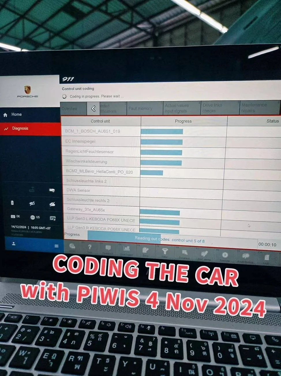

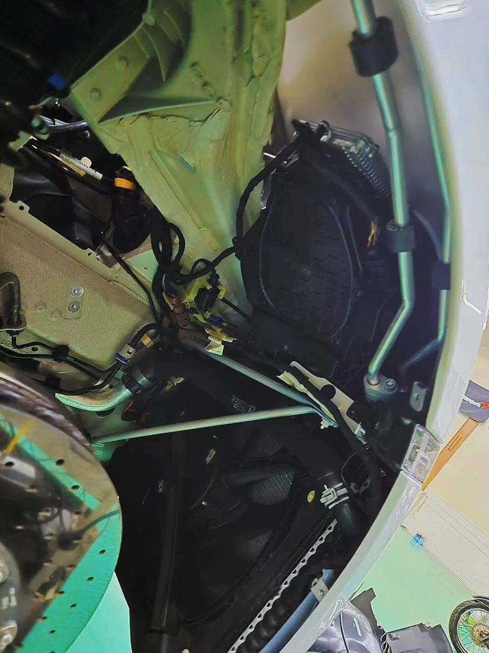

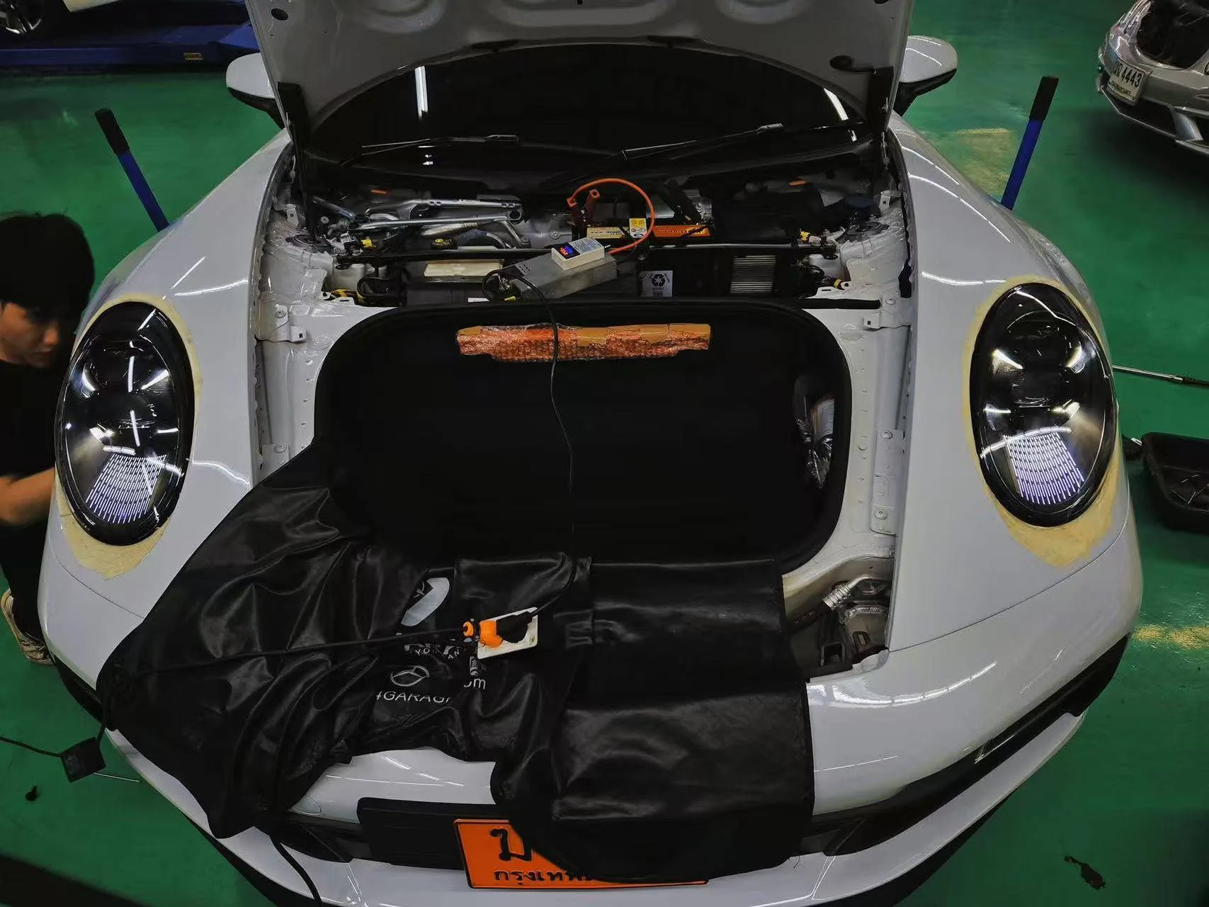

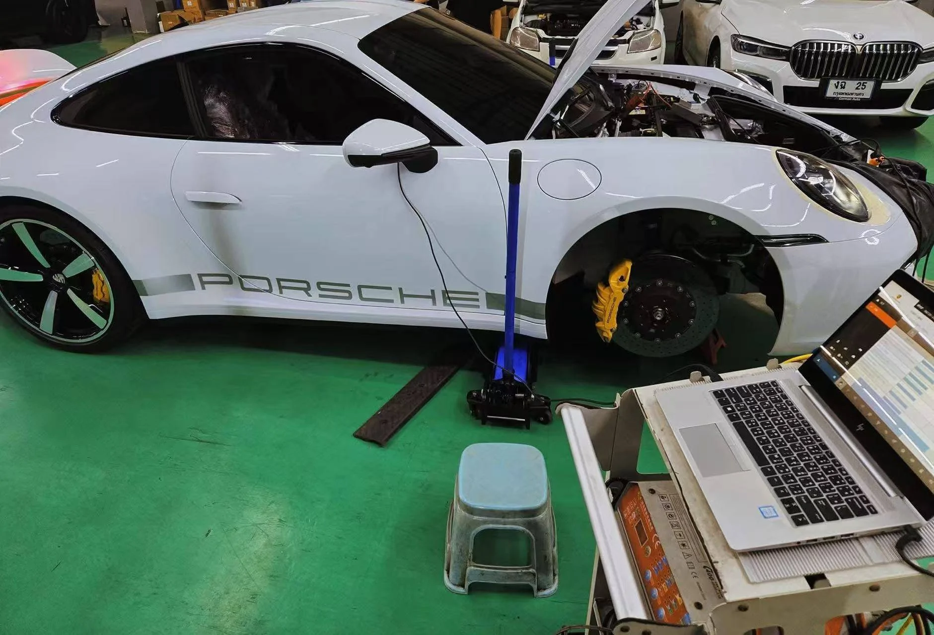

Porsche can’t even provide meaningful PCM updates beyond the first couple of years after launch. No way they are going to enable Full Matrix LED headlights.
Porsche maybe not. But I certainly can ?
Porsche Taycan Enabling U.S. matrix LED headlights -- will Porsche follow Tesla's lead? 796d820dbd4cda082ebc3b46757bf06
Porsche Taycan Enabling U.S. matrix LED headlights -- will Porsche follow Tesla's lead? 1745859273151-nn
Porsche Taycan Enabling U.S. matrix LED headlights -- will Porsche follow Tesla's lead? 1745859283586-5h
Porsche Taycan Enabling U.S. matrix LED headlights -- will Porsche follow Tesla's lead? 1745859294767-wk

Very unlikely. The issue is US newly minted standard is not compatible with the rest of the world, requiring new designs for US market. Two main sticking points are testing (US requires much more rigorous testing and with real cars, no dummy/simualted cars) and shading (US requires the exclusion area to fade through shades of gray, the rest of the world standard is just a on/off border). So while Porsche or Tesla could retest, they cannot make LEDs designed to only have ON/OFF states to suddenly project shades gray. Maybe someone like Tesla could eventually figure out a software workaround, like PWM modulating the LEDs, but I suspect the LEDs are not speced to do that. Porsche does not have that level of control over their supplier's software - this would be a whole new contract to negotiate for a whole new headlight. There is only one company in the US that has found a way to enable adaptive/matrix headlights:
https://carbuzz.com/only-car-brand-full-adaptive-driving-beam-headlights-america-rivian/
Article above has some details why too.
For US matrix owners, the only way is recode the car. It's a bit more involved than some other simple recordings. It is doable even with PIWIS3 (there have been rumors that PIWIS4 is required, I did it with PIWIS 3 before PIWIS4 was even released).
