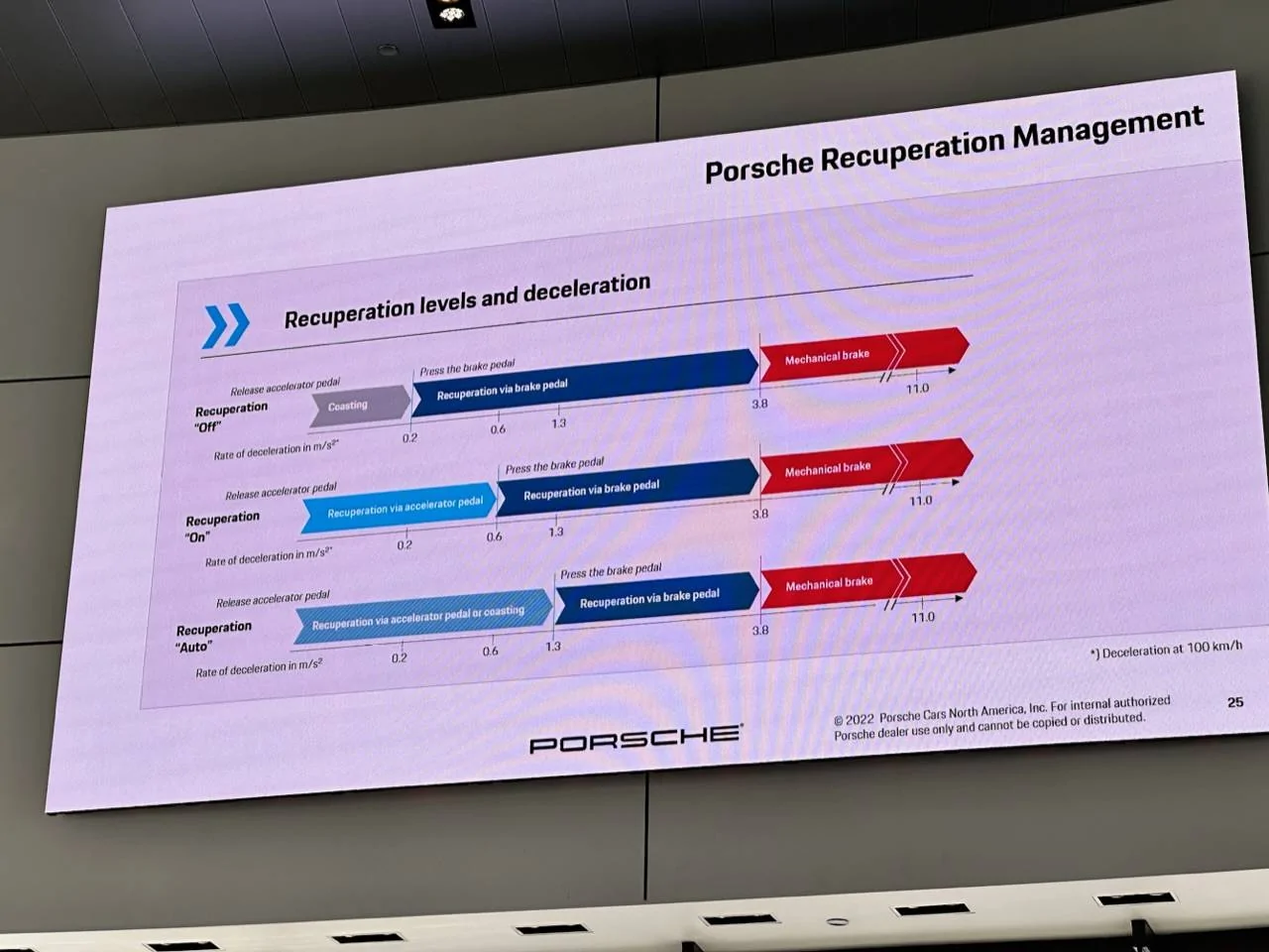

Quick update, for what it's worth. I spoke with a PCNA rep today giving a presentation on a Taycan. He told us that the first Porsche to have matrix headlights enabled in the USA will be the MY24 Cayenne (or Macan I don't remember for sure, apparently new headlight design - perhaps NHTSA regulations require something not present in current hardware?). He also mentioned that earlier cars may not be able to be retrofitted due to regulations which require a car manufactured in a particular year to follow safety regulations from that year.
The same rep told us that charging a Taycan from L1 chargers (120V) will will completely drain the 12V battery because it takes many, many hours during which the 12V battery is drained but never replenished, and that Taycan brake lights only go on if the Taycan is decelerating at a faster rate then 3.8m/s/s regardless of speed. The first one was true long time ago, the second one was never true, hence my qualifier "for what it's worth" - the rep's info may be out of date or plane wrong.
I was in Bellevue then too! Looking at my photo of that slide, the 3.8 m/s/s seems to be the right number when at 100kph. I think you got the guy in a Brian Williams moment.
Porsche Taycan LED Matrix Headlights DD74EDF4-DF54-49E2-BDC1-36D81C972F73
89
8,424
7,419
Cool. We might have even talked to each other.
I saw the 100km note, but the guy insisted 3.8m/s/s was for all speeds. Worse however was his insistence that rear brake lights only go on above 3.8m/s/s. This would definitely cause some rear end accidents for the Taycans as it would mean you can go from 100km/h to a full stop in just over 7 seconds without your brake lights coming on.
After that answer I stopped asking more questions as I realized the guy is just “coloring-in” the slides he’s been given with made up information. I got a whole lot more useful information from one of the techs when we went back to the shop to look at the Taycan on the lift.
