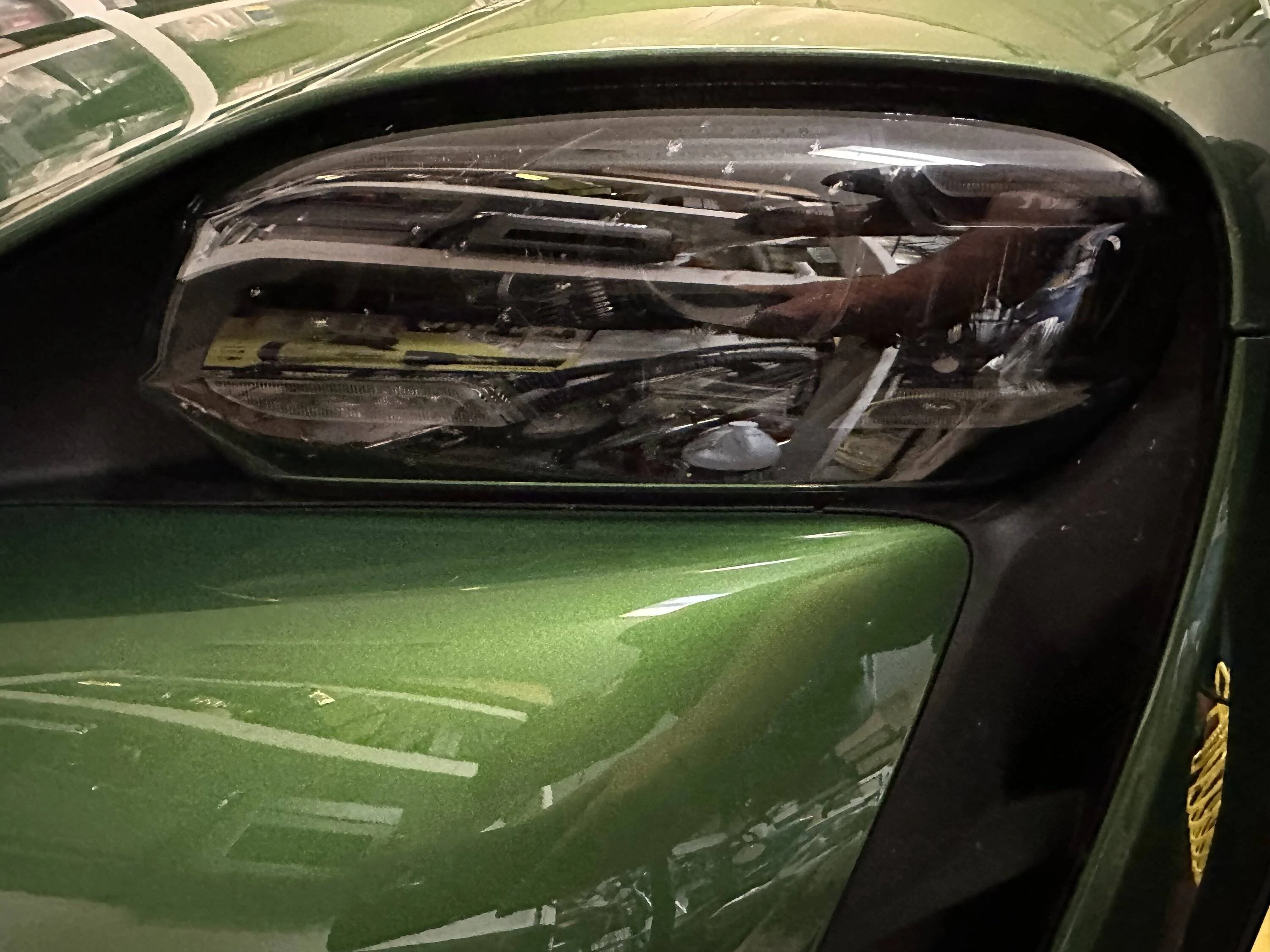

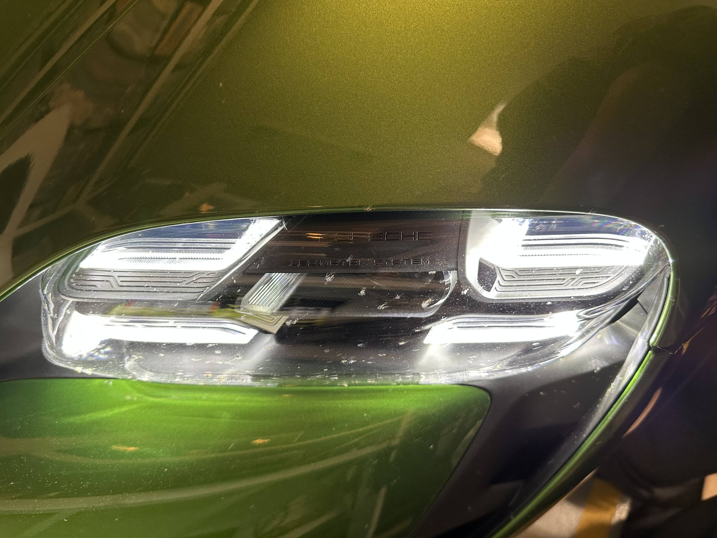

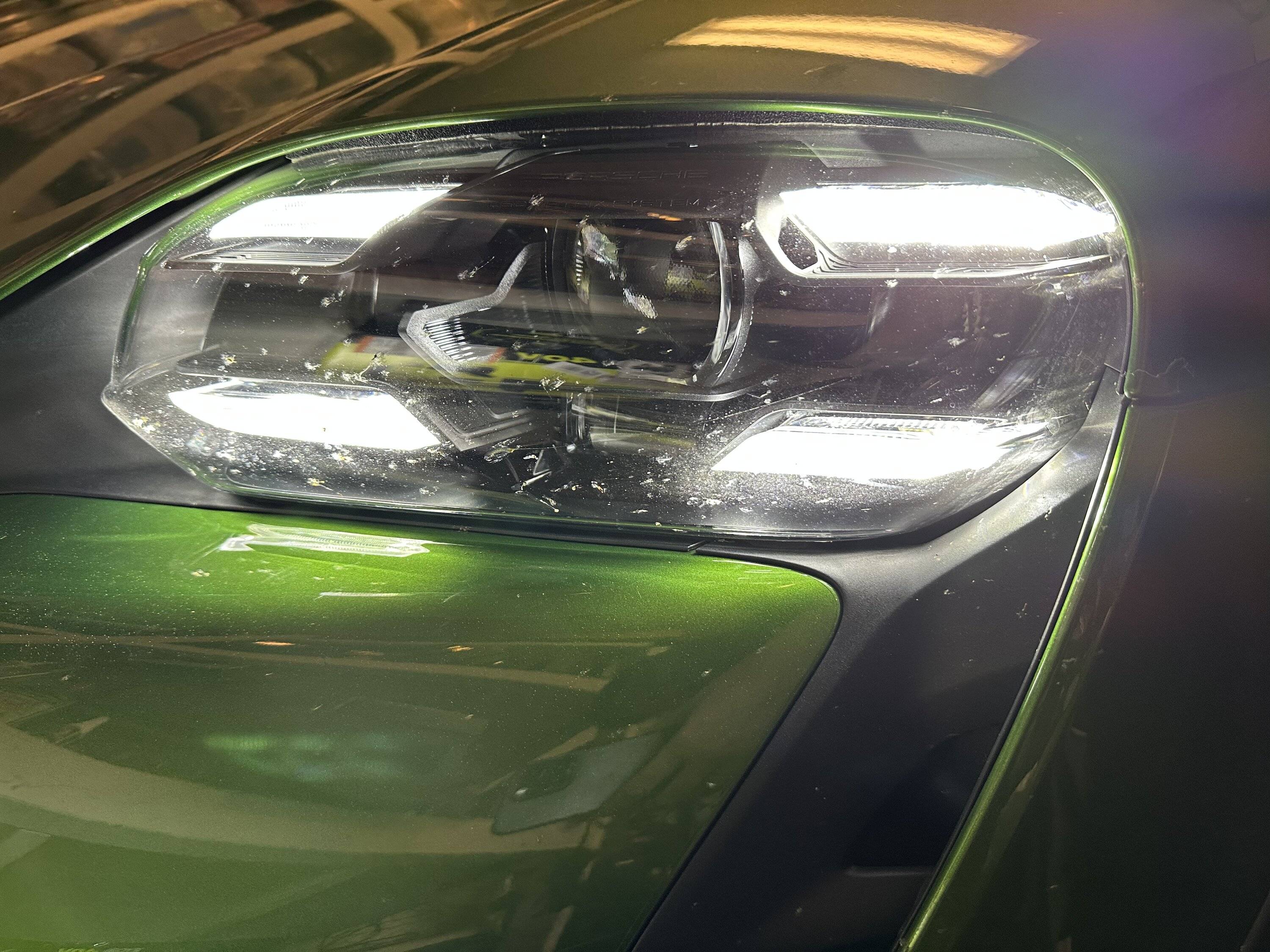

Forgive the bug splats, but here are mine.

mystermykee
Mar 30, 2022
695
477
Bay Area
9j1, 9y0 hybrid, 992.1
It's easy to tell if you have the matrix LEDs when your headlights turn on and off. They aren't an instant on/off like the single LED headlamps.
If you have PDLS+ in the US (regular headlamp or matrix LEDs, we're stuck with auto high beam on/off. Everywhere else (outside North America), PDLS+ is enabled in full. Single LED headlamps--mechanisms in the housing reflect light around objects. Matrix LEDs--individual LEDs turn on and off.

Yes, I do not notice any aiming of my headlights around corners or to block out cars. I noticed that an earlier poster in this thread mentioned swiveling headlights and wondered whether that was non-LED Matrix (for North America). Mine appear to be the same as European (albeit potentially disabled).

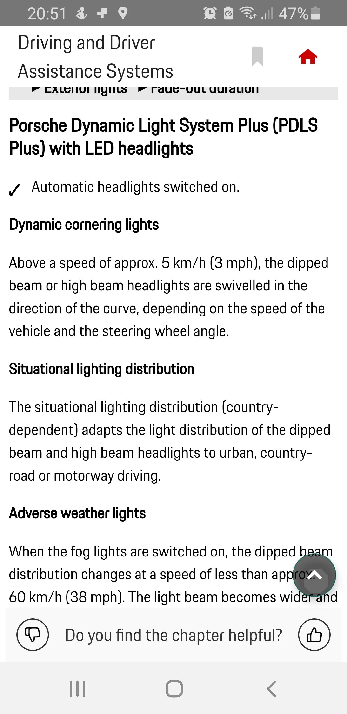

11,077
6,856
Can you post a video of your cornering lighta if possible? I have PDLS+ with matrix but have never seen the lights turn in corners. Thanks!
Matrix don't swivel.
Standard LED with PDLS+ do and you will notice straight away when you turn them on as they swivel as part of the activation.
Porsche Taycan LED Matrix Headlights Screenshot_20221117-205102_Porsche Good to kno
