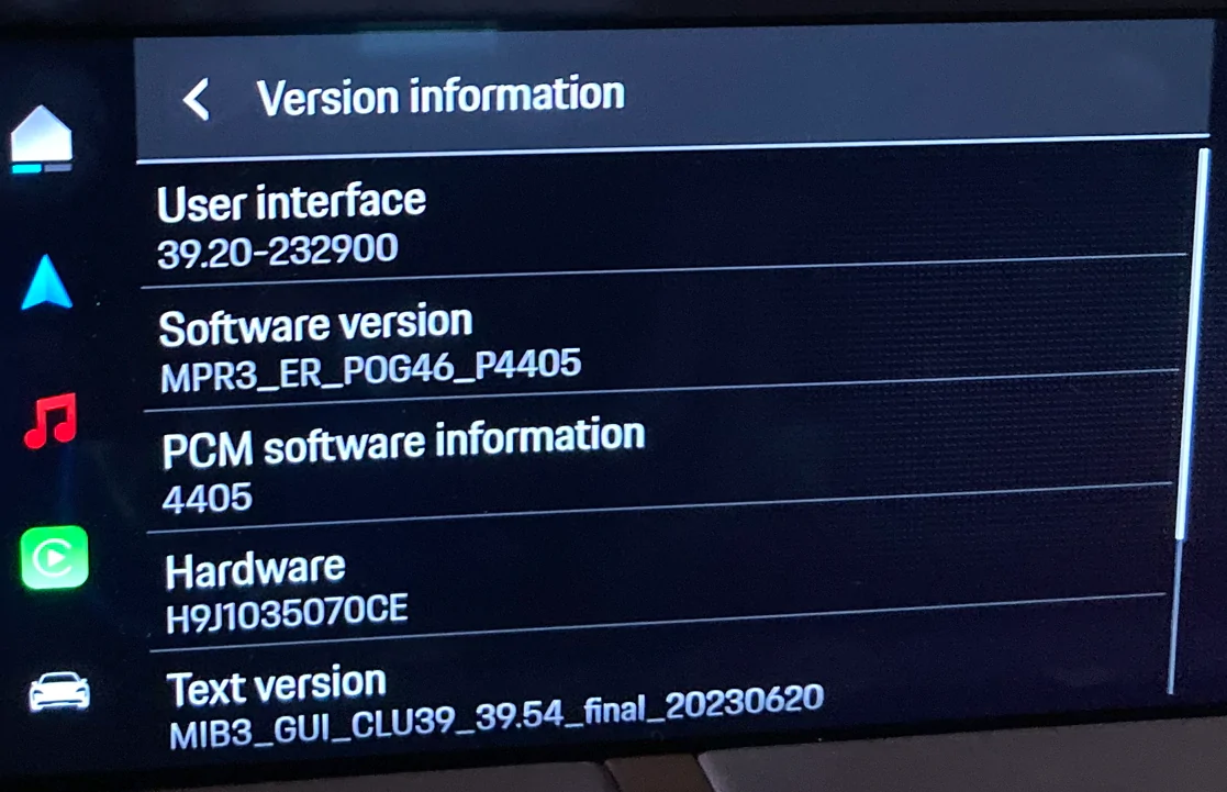

Check what s/w version you're running (there are images showing where on this thread and others).
Iirc early J1.2 cars had older s/w versions. The latest versions don't exhibit the issue, but to date Porsche won't put those later versions on J1.1 cars. They should do on J1.2.
I believe Chun posted the different versions.

I have J1.2, MY 2025, produced on May, 2025.
