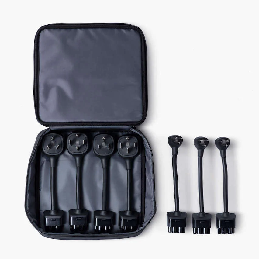

@daveo4EV I'm now building my mobile kit. Can you confirm which option you prefer?
I have already:
TeslaTap Mini 80 amp with case to charge at hotels.
Porsche Taycan EV Roadwarrior adapters “kit” 1630446475258
http://www.umc-j1772.com/index.php?route=product/product&path=17&product_id=160
My next step is to purchase the actual mobile kit.
Option 1:
Porsche Taycan EV Roadwarrior adapters “kit” 1630446520313

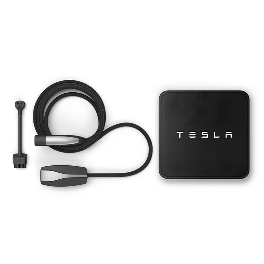

https://shop.tesla.com/product/gen-2-mobile-connector-bundle
and
Porsche Taycan EV Roadwarrior adapters “kit” 1630446552563
https://shop.tesla.com/product/nema-adapter-bundle
Option 2:
Porsche Taycan EV Roadwarrior adapters “kit” 1630446605586
https://www.mustartsolutions.com/co...rent-mustart-travelmaster-level2-ev-charger-1
Which should I go for? This is for only mobile use on the road.
193
7,019
10,498
option 1 or 2 are basically equivlent - the Tesla option comes with more NEMA adapters by default, but Mustart has equivalent choices but no nice “kit” where they are all bundled - if you get the Tesal Mobile charger you’ll need to _ALWAYS_ use the TeslaTap which is a slight pain but not too bad - I carry Tesla mobile charger around with me - but that’s pre-existing condition. the mustart might have the slight edge because you can adjust amps via the LCD screen - there is no control on the Tesla UMC - so you can’t adjust amperage.
adjusting amperage give the Mustart the edge in my opinion and the fact that it’s “native” J-1772 you won’t have to use the TeslaTap everytime you use your mobile charger.

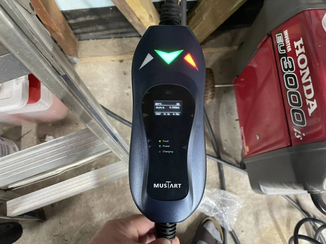

I have the Mustart Travelmaster EVSE, and just for clarification, you can’t adjust the amps on the LCD (at least not on mine). The EVSE automatically adjusts the amps based on which supply “pigtail” is plugged in.
thank you for the clarification - I thought the Mustart‘s LCD screen would provide some AMP control - I stand corrected - the proper way to adjust amps is to use the correct supply cord - but sometimes even with the correct cord it’s useful to adjust amps lower to avoid overloading old or poorly maintained circuit breakers such as outdoor one’s found at various RV parks or racetracks (thunderhill cough cough cough)
I’ve found the ability to plug into NEMA 14-50 plug which should charge at 40 amps - taxes Thunderhill’s RV plugs and being able to adjust amps down to say 36 amps greatly enhances charging relaibilty at Thunderhill…
the Mustart is maximum 32 amp charger so you get an automaticly lower rate on NEMA 14-50 plulgs since it will only ever do 32 amps
so you can’t adjust amps on the LCD screen of the Mustart?
Chalk up a “win” for the PMCC
however porsche really should have this functionality in the vehicle so that you can compensation for poorly provisioned public chargers that often times can’t run at maximum amps for several hours - I have found these in SF for example - they claim 30 amps but keep dropping off line at 30 amps - but with my Tesla I could plug in and lower the amps to like 26 amps - and these chargers would run much longer with no session interruptions.
