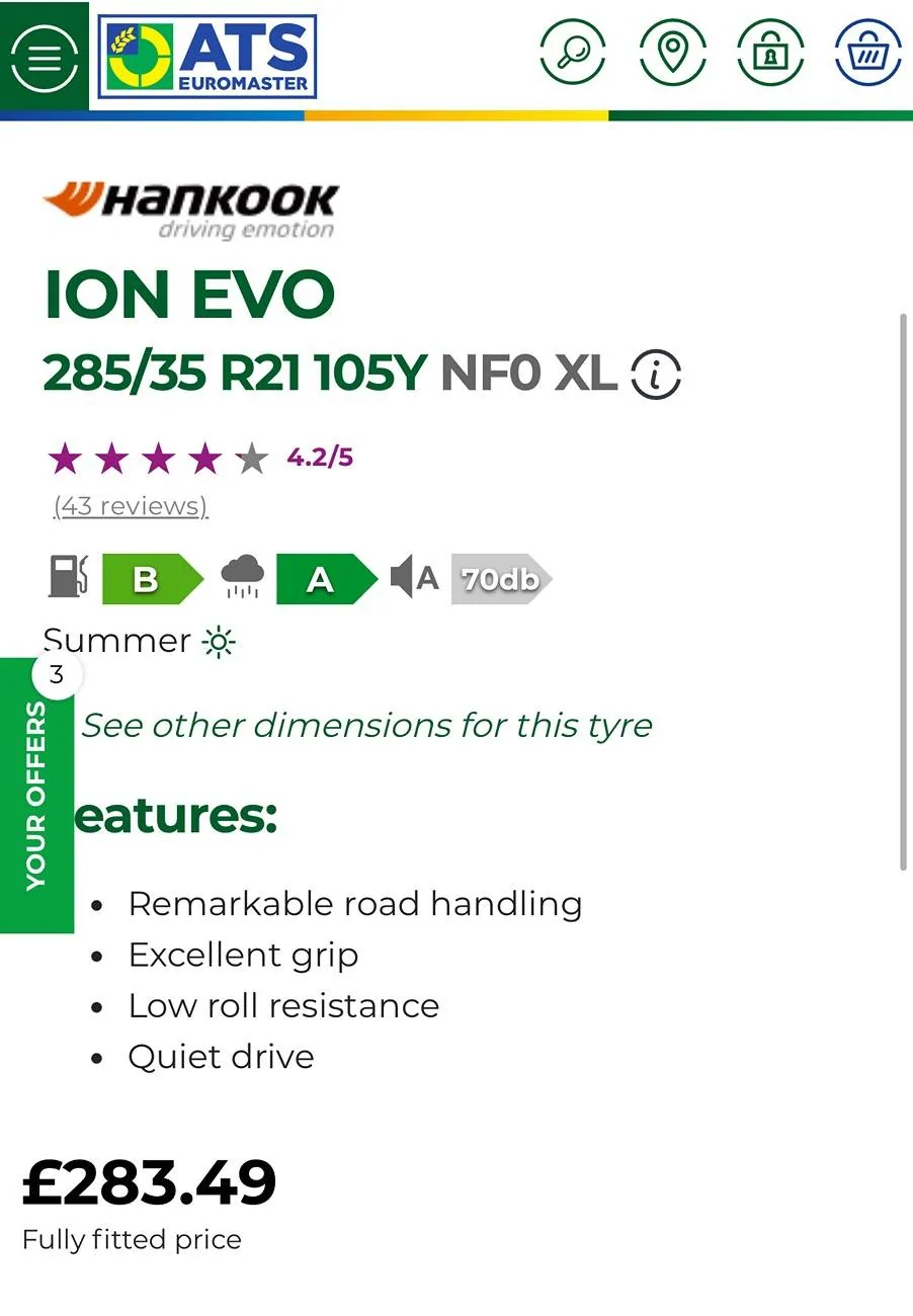

I've been running the Hankooks since April and the jump in efficiency has been amazing, coming from Pirellis. Have discussed it in detail elsewhere on here but as they are NF rated in 19 and 21 I bought the 20s and fitted them. There is no discernible difference in noise or handling, for me anyway, and the efficiency increase has been astonishing. Previously seeing 3 miles/kwh on a trip was a cause for celebration, now I get 3.1-3.4 nearly all the time for longer drives. Sadly the Winter wheels go back on soon.
But they are not NF rated in 21s? Not that I can find

Those are too narrow for RS Spyder rims.
MY25 cars have narrower rims and these tyres.
