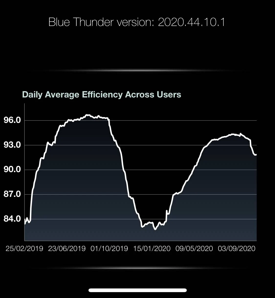

Thanks all. This is really helpful info, and it is beginning to sound like the range drop-off is temperature related, which is affecting shorter trips disproportionately. I just hadn't expected the range drop to be so stark between 80F and 60F. For the same (longer) trips, I've lost around 40/50 odd miles (based upon miles per battery %). I guess if glass is half full, if I'd got the car in the Winter, I would have been pleasantly surprised with the range jump come the warmer weather.
Hi - I am finding the same amount of range - typically 180 miles at 85%, and 210 at 100%. I think you have hit the nail on the head there - small trips will disproportionately affect the range calculation. I find it helpful to think of the display not as an actual gauge (in the same sense as a fuel tank), but as an estimation based on various factors which may or may not be a good indication of future range...perhaps not quite what they were aiming for!
plamichigan
Patrick
Jan 30, 2021
50
Taycan, Cayenne, 1970s era Buick
That's pretty much the numbers I have too right now with comprable temperature.
210 miles of range for 100% charge, consumption of 41-45kwh/100 miles (or 25-28 kwh per 100km) for a 60 miles commute (100km).
Whereas in the summer I was more or less at 23 kwh/100km (37 kwh/100 miles).
I also switched my 21 inch wheels with wide 305 all season tyres for 20'' turbo aero wheels with winter tyres (Goodyear Ultragrip from Porsche winter kit).
So I do think as well that tenperature and software algorithms here are the main factors explaining what we are seeing.
My experience in Michigan (temperature in degrees Fahrenheit) in a taycan S:
--mostly highway driving, very cold (under freezing): loss of about 20%, meaning 190 practical range even when fully charged, and possibly 180 miles--not the 240 shown when fully charged.
--when 50-60 degrees, same highway driving, pretty much the estimated range, meaning a practical range of about 220 with 240 being the indicated max.
See other posts on this with comparisons to a NJ drivers experience.
