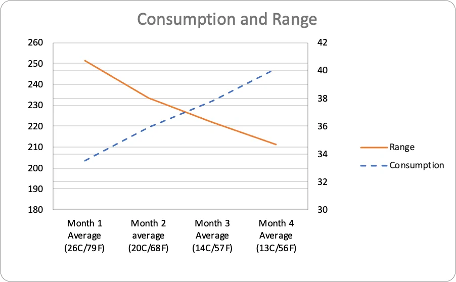

First time caller, long-time listener. Firstly, just wanted to say how much I’ve appreciated all of the informative posts on this forum, which I’ve been reading carefully since ordering my Taycan Turbo way back in 2019. Delivery in July after the UK’s first lockdown finished, so I’ve had it over three months now. Unfortunately, have only managed to register 2,000 miles. As most on this forum have said, the car is an absolute joy to drive. However, I’ve encountered a whole host of problems since delivery. Most have been minor – e.g. PCM issues, Apple Music not working, rattles, rear spoiler misaligned etc, but the range drop-off that others are also seeing is really concerning, especially since over here (UK) the temperatures haven’t quite hit the Wintery numbers yet.
When I first took delivery of the car back in July, I was getting upward of 280 miles (projected on the basis of miles driven per percentage of battery used). That was at the height of Summer, when we had a number of days above 30C (above 86F), and so the A/C was running pretty much constantly. As we moved into August and September, with slightly lower temperatures in the 20Cs (70Fs), I was expecting to see an increase in range since the A/C was hardly running, but, instead, saw a decrease in range. Since then, the range has continued to quite drastically and progressively decline. Currently, I am rarely seeing more than 200 miles of full range, and a recent short trip of 10 miles used up 6% of the battery. I can understand getting low range in freezing temperatures, but it has been a really mild Autumn/Winter over here so far, and the lowest outside temperature while I’ve been driving has been 12C (54F). I’ve attached a graph showing the increase in consumption, using the consumption information from the Porsche Connect app. The average external temperature figures on there are a little bit back-of-the-envelope, since I’ve used the average day-time temperatures as recorded by a weather website, and the last month’s data is a work in progress and only comprises 13 days (so will be disproportionately impacted if I happened to drive on a colder than usual day). The range line has just been extrapolated from the consumption figures. I’ve also started looking at the consumption while driving more carefully now, and when we start a trip, the consumption is usually over 120kwh/100miles, and gradually gets lower but will only get below 40/45kwh/100miles once we’ve driven at least 30/40 miles. I was fully expecting a range drop-off in the Winter, but this seems quite drastic when we haven’t even hit the really cold stuff yet. There is also the possibility it is a software issue, since I am not sure the car is determining the battery percentage accurately at times – for example, we’ve had several instances of parking the car, and returning less than half an hour later with the percentage being 2% less than when we parked, even though the car was turned off (with no cool/heat), and also occasions when the car has been charging, and the range estimate has increased by, say, 15 miles, but the percentage has only gone up by 1%, only to right itself 24 hours later by adding the extra percentages. Anyone else seeing this as normal behaviour? In particular, anyone in the UK with a Turbo seeing such low range figures in November?
How did you pull the consumption data for this chart? I just see consumption by trip in the app. I don't see how to export.
Annoyingly, literally had to go through each trip and inputted the data into an Excel spreadsheet by hand. Not the most fun I've ever had, but guess it is lockdown

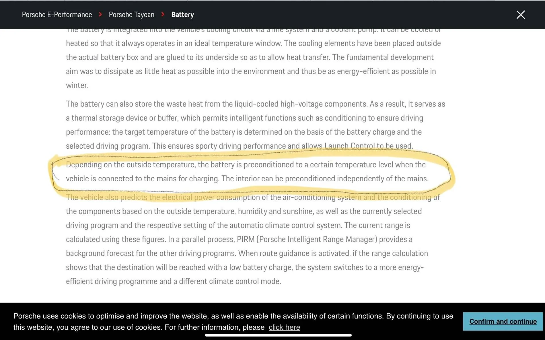

I’m just suggesting how to avoid the App if it isn’t working for you.
Preconditioning ONLY heats the cabin (and seats and steering wheel) it does NOT heat the traction battery.
I just found this on the Porsche website!
It seems that when the car is plugged in the battery is preconditioned. Might be worth trying out for you who already have low temperatures. I think that sounds good and would love to hear feedback from somebody in Canada or NA.
