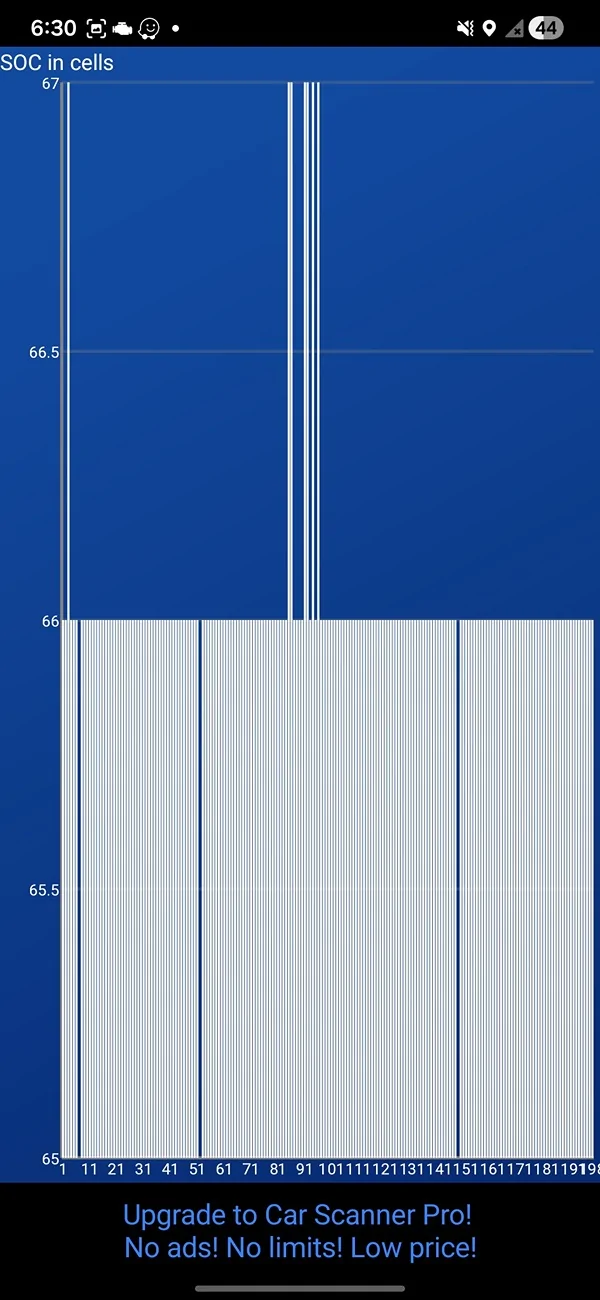

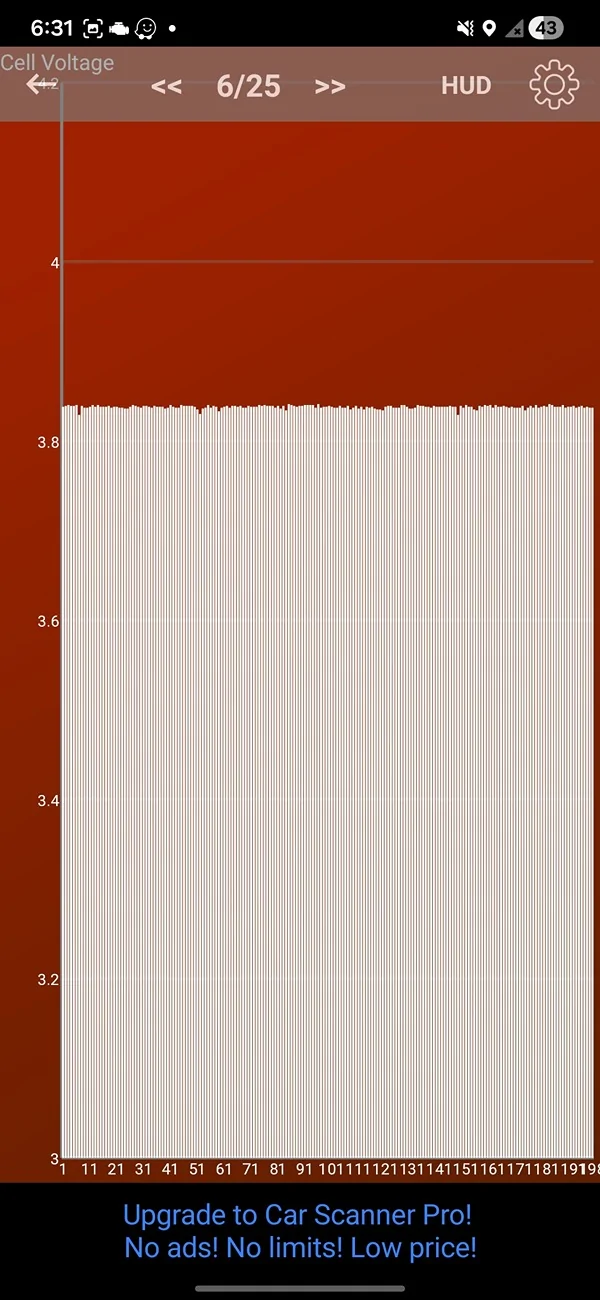

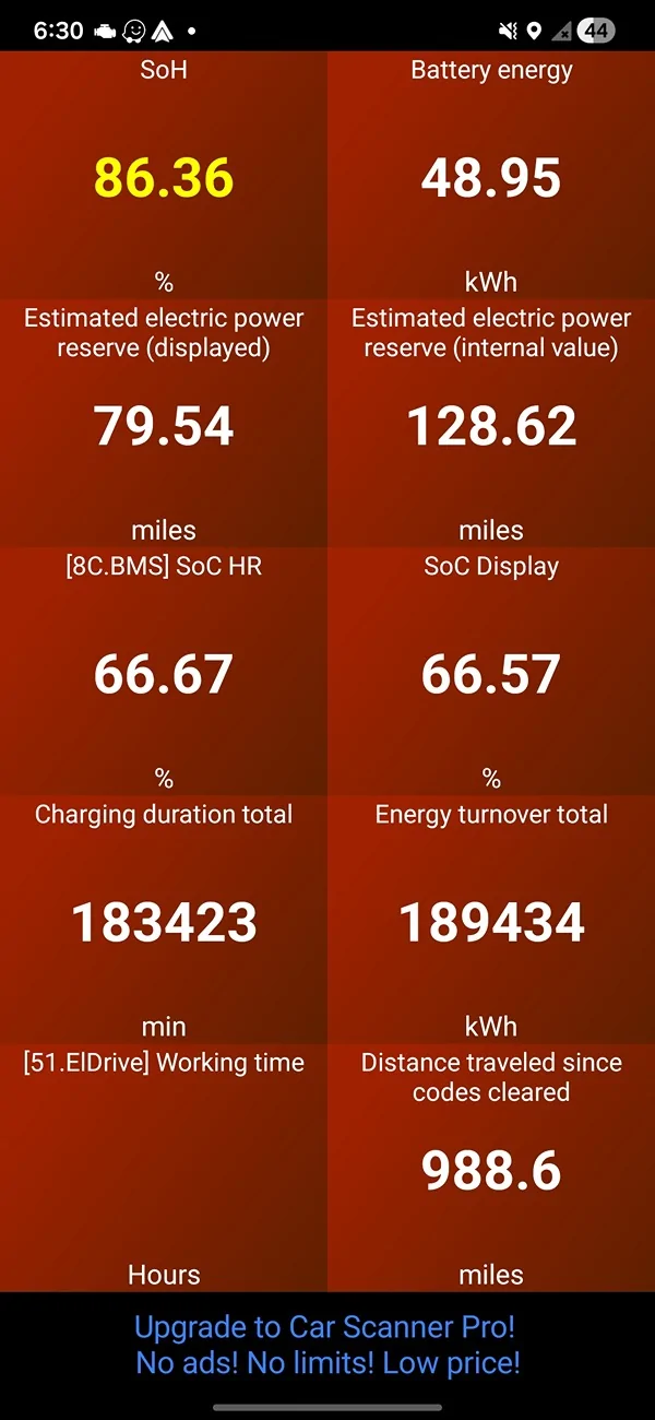

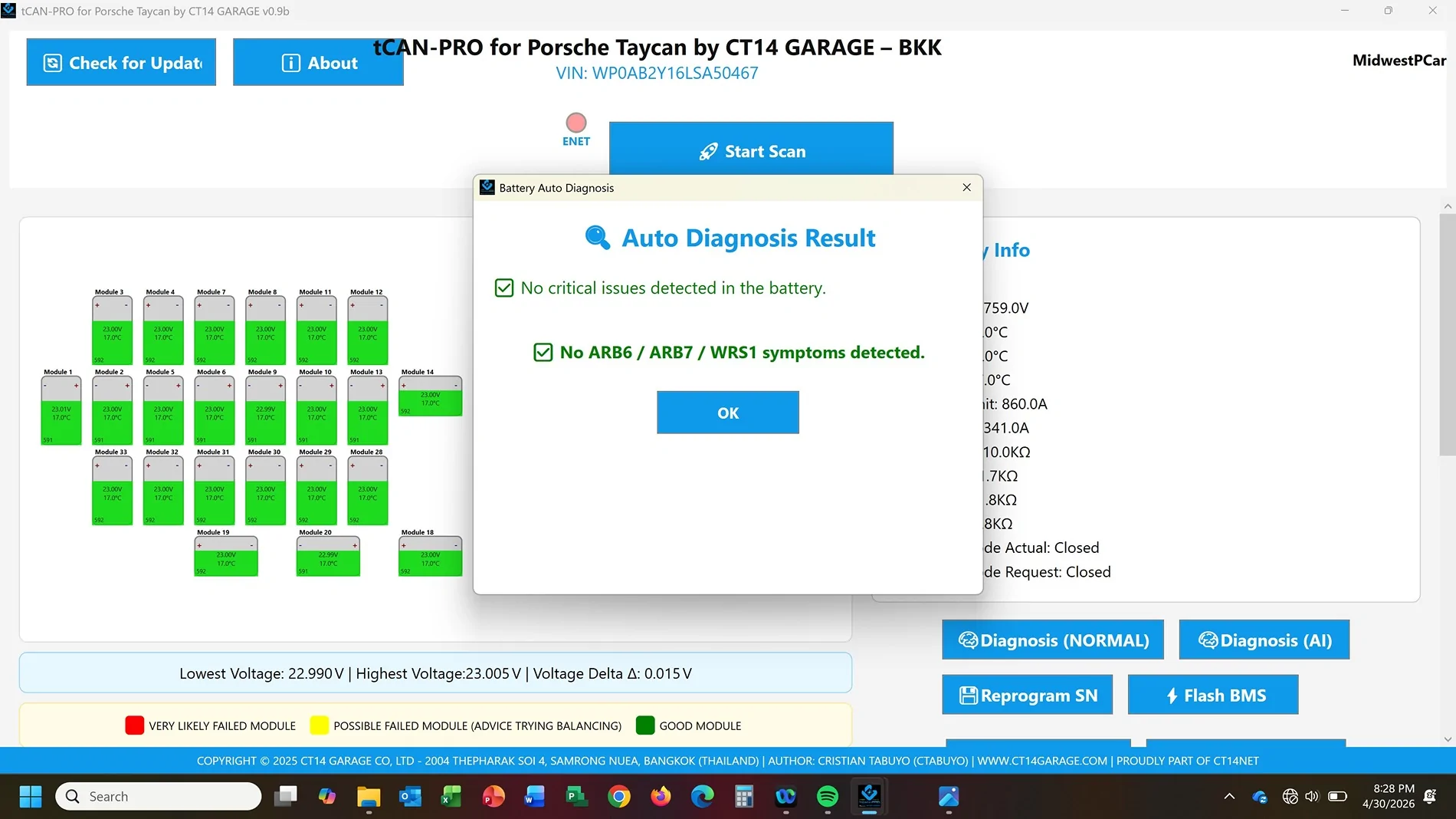

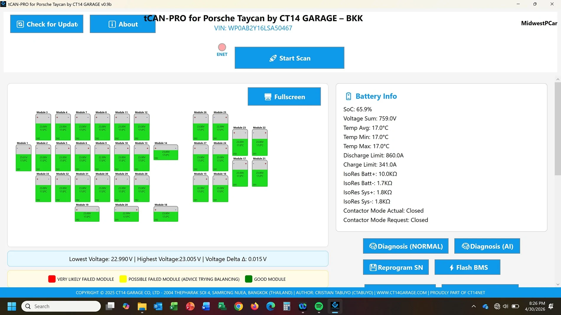

Just finally got a moment and did it.... and everything looks good to me.....
Images attached from tCanPro and CarScanner attached...
Does anyone see anything amiss?
Maybe it was just my spirited driving on the highway...
tCanPro....
Porsche Taycan Range Drop tCanPro - 04 30 2026 - 2
Porsche Taycan Range Drop tCanPro - 04 30 2026 - 1
CarScanner
Porsche Taycan Range Drop Screenshot_20260430_183022_Car Scanner
Porsche Taycan Range Drop Screenshot_20260430_183112_Car Scanner
Porsche Taycan Range Drop Screenshot_20260430_183039_Car Scanner
SergeyIndy
Sergey
Dec 19, 2021
2,489
1,894
Indianapolis
All looks good to me, @MidwestPCar, I am also at 86% SoH but my max usable Battery Energy calculates to about 75kWh and yours to 73kWh. You divide battery energy value of 48.95kWh by SoC Display of 66.57% to get to 73.53kWh when at 100% SoC.
I do not think that is significant but the way you use that absolute value to estimate your Range for current trip using currently shown by car efficiency. For example, if I am on my drive to work, I know that car estimates range based on historical drives but not my current drive, so if I see the car reporting for the current drive 37.5 kWh/100 miles efficiency, this tells me that my range is 200 miles.
My point is that I CarScan every 1k miles, look for cell graphs as a precaution, and then note my Battery Energy. Then when I drive if my efficiency is better than 37.5 kWh/100 miles in the example above then I know my Range is over 200 miles and I expect it to rise if temps are good or go lower of temps go lower.

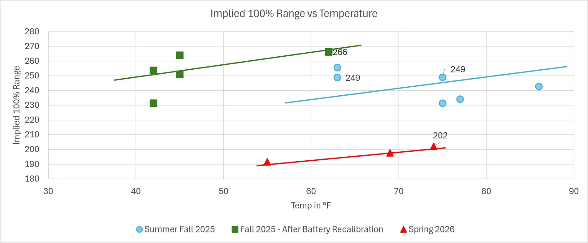

Thank you. I get that math. I think I need to pay attention to "current efficiency" as I drive. This simple math will help.
I will return the data favor with data. I added the implied usable per your math.
DateMileageNotesSoHSoCBattery Energy (KwH)Implied Usable (KwH)
2025-10​
50,100General
84.84%​
53.73%​
37.9​
70.54
2025-11​
50,507Right after battery recalibration
89.54%​
96.86%​
77.4​
79.91
2026-04​
51,787General
86.36%​
66.67%​
48.95​
73.42
What I really was pleased about was the bump I received with the battery recalibration. For me, at the time, I gained ~4.5% SoH and ~9.5 KwH of usable battery. I seem to be receding now with use (expected), but I'll do a recalibration soon. I expect the "bump" to be less drastic.
