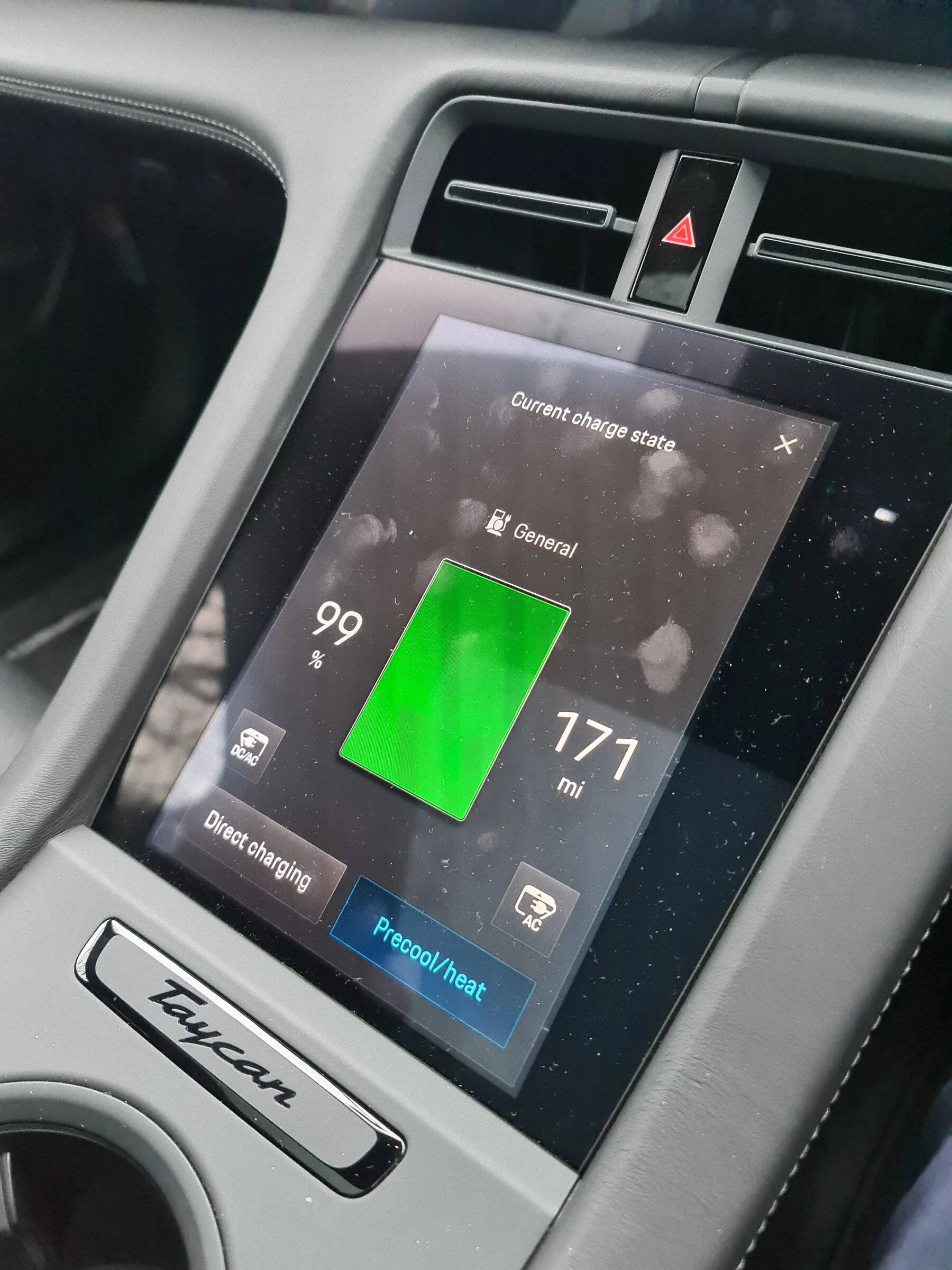

Hello
I picked up my Taycan on 20th December 2021, it's been back with Porsche Edinburgh since 6th January 2022 for a variety of faults and error messages.
Since picking it up the maximum range has been 171 miles, I was expecting better.
What does everyone else get?
Porsche say it is normal and will extend, I keep insisting they run what tests they can while they have the car and the latest response is - "I have our technician looking into the battery health at present, he can check to make sure there are no dead cells etc."
Any help would be appreciated while I have Porsche's attention fixing the other faults.
Thank you

I should have elaborated, it is an ex demo from Porsche GB supplied by Porsche Edinburgh, 21 reg with 1293 miles on the clock. I've done 200 of those in 2 and a half weeks.
You know it consumes more energy for the first 2000 miles or so right? It's in the manual. Don't give up!

Fear I've been sold a pup and the battery is faulty too.
The guess o meter number doesn't matter.
The guess o meter is irrelevant.
ignore the guess-o-meter. Instead, keep careful notes from the odometer each time you charge. Note:
- percentage charge after a charging session (most times this will be around 85% if you follow Porsches recommendations)
Then when you charge the next time, note:
- state of charge before you start charging
- miles/km driven since the last charge
You can then calculate real 100% range: miles or km driven divided by charge used.
Example: let’s say you start at 80%, drive 120 miles and recharge at 30%, your estimated full range would be
120/(.80 - .30) = 240
