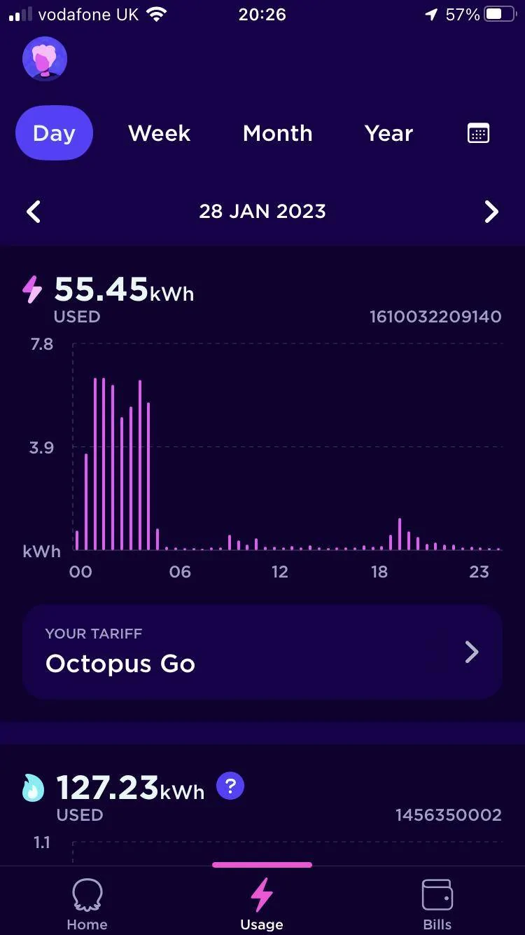

Octopus Go is definitely worth it for me.
Don’t need intelligent and not Audi or Porsche compatible.
We have the Taycan and an Etron so I alternate the cars.
I leave the cars dumb and the Podpoint only comes alive between 00.30 and 04.30. Never have a problem.
I plug the other car into 3 pin for a trickle charge so the batteries are both warm for morning start up. I use dishwasher and washing machine at night too and smash the under floor heating.
This day shows my usage.
46kw at 7.5p
9kw at 34p

Wow that is impressive, by my calculations Go is marginal for me as I use 6900kwh/pa on household use. I have assumed I would only shift 5% of daytime use into cheap rate... dishwasher and washing machine. Not sure about underfloor heating in the cheap period as surely it is cold during the daytime?
